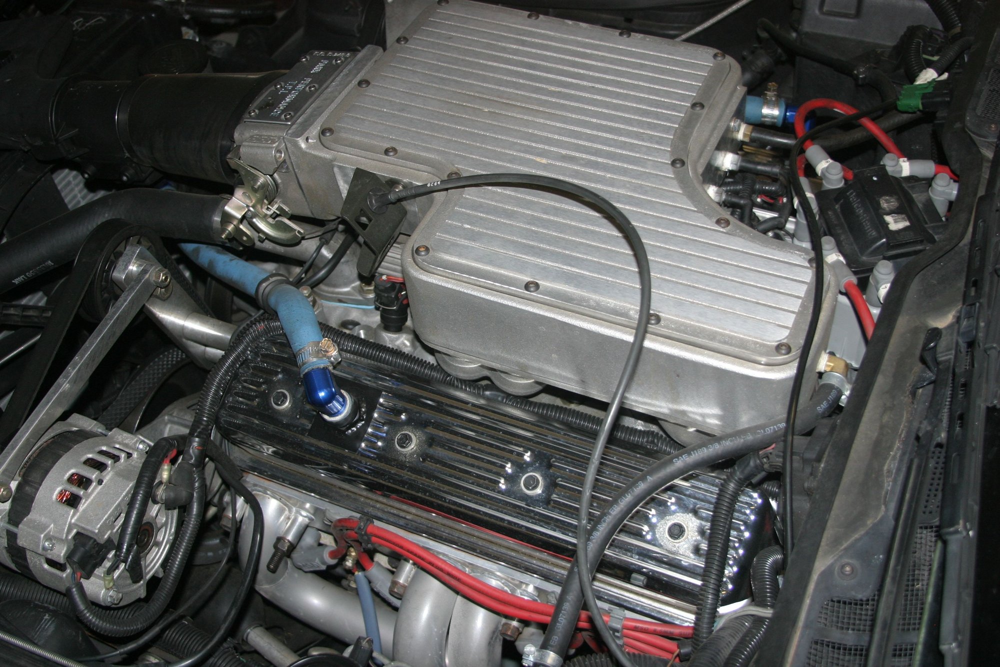

When I had the L98 .030+ in my 89 I ran the Super Ram (Lingenfelter Box) with AFR 195 heads, Scat Crank, Mahle Pistons Non-Skirt Flattops, Comp Cam, Accel Gen 7 ECM, TPIS Long Tubes with a Y to a single and Y'd again to dual Flowmaster 50's and I was putting 362 HP to the wheels:

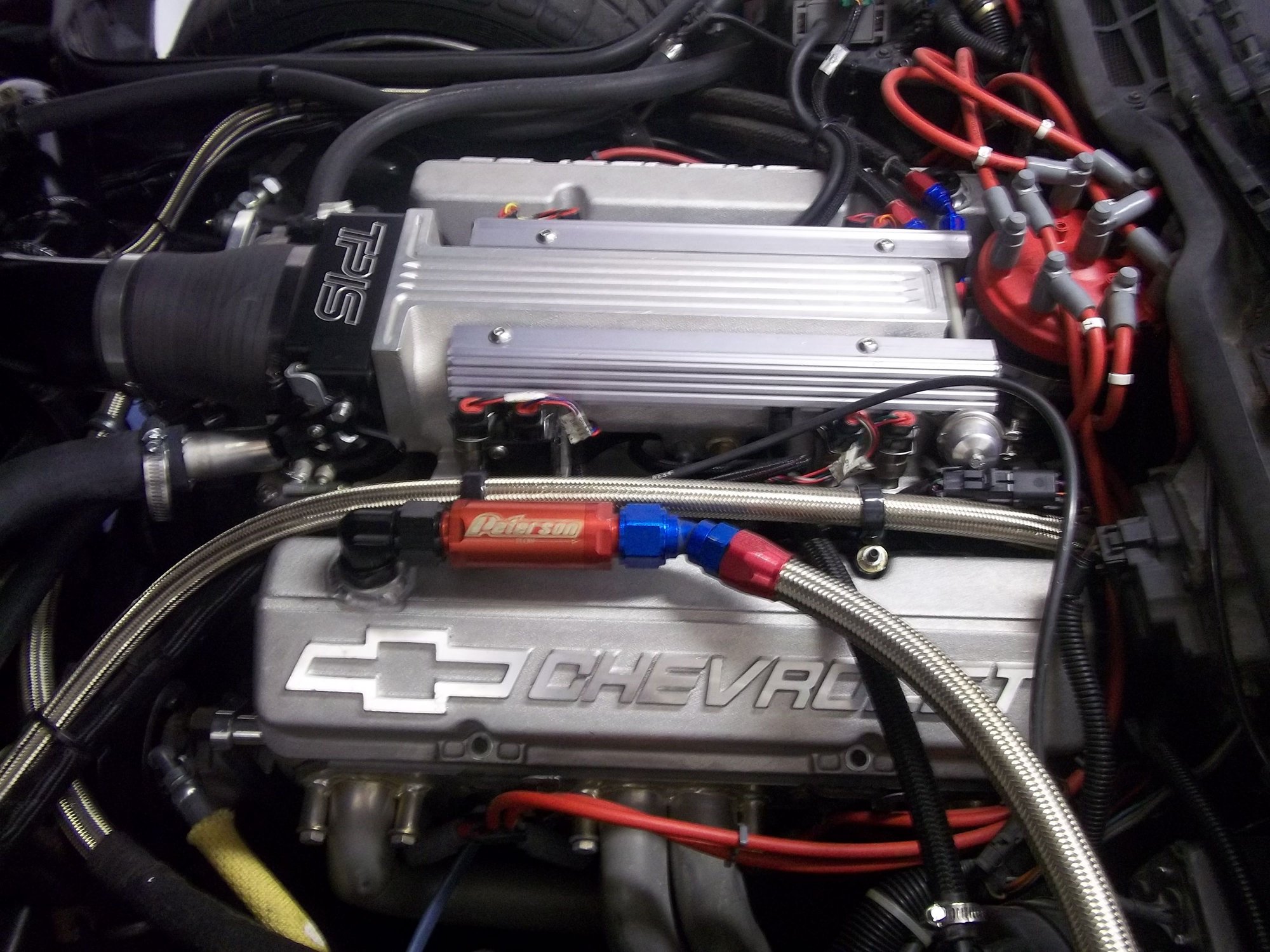

Now, I am running a Lingenfelter SBC 427 All Alum. Dart Block, AFR 245 heads, Comp Solid Roller, Callies, Diamond Pistons with Oliver Rods, Shaft Rockers, Holley HP EFI, dry sump, with a TPIS MiniRam and the same TPIS Long Tubes into the Y and a Flowmaster Single 30" 3 1/2" In & Out Muffler and I am putting about 530 or so HP at the wheels.
