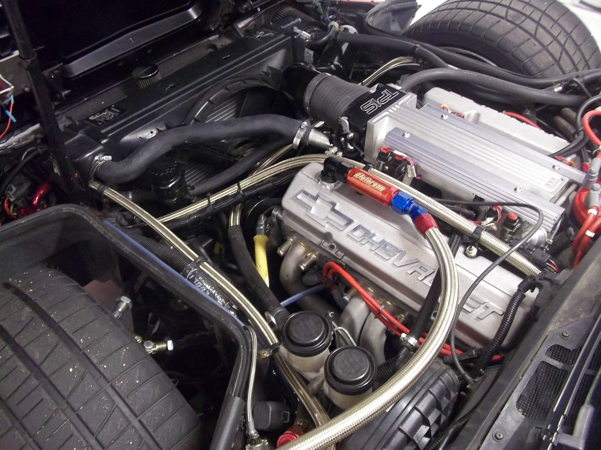

When I had my L98 in my 89 I had an oil catch can mounted to the cross brace in front of the engine and the catch can set just to the right (Passenger side) of the front pulleys.
On my Lingenfelter SBC 427 the oil catch can is in front of the radiator. You'll see the breather filter just popping up above the radiator in the picture:
