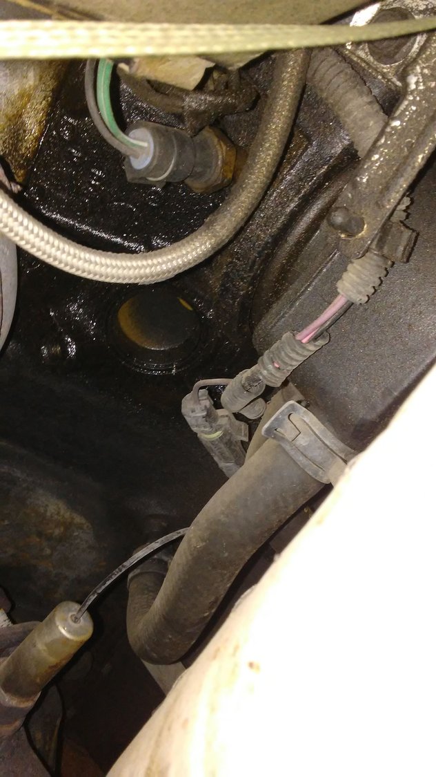

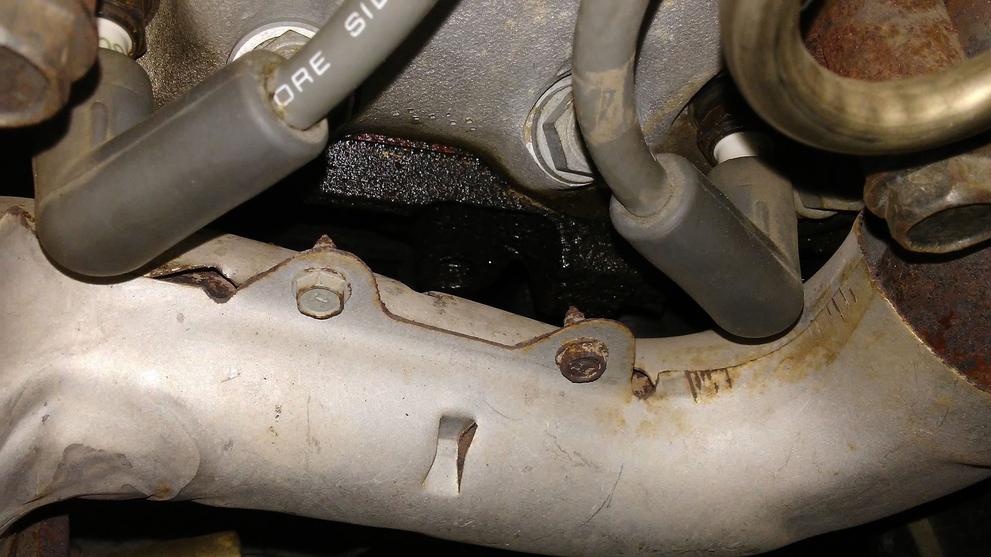

I have a 91 L98. I noticed today that it was wet under cylinder 7 and it goes down to the exhaust. When I start the car it'll smell a bit like coolant. If I let the car sit for a few days it'll drip a few drops of coolant. Other than this the car runs well, oil looks good, and no smoke from exhaust. Where could the leak be coming from? In the pictures it's above the driver side cat and under cylinder 7.

possibly between the intake manifold and the heads.
had the same thing in my 87. i snugged up the intake manifold bolts and it stopped. might work for you.

I think there's 13 of them and they are the top of the engine, underneath the intake runners etc. (big tubes going into the top of the engine from the air intake, called the plenum). You may have to take the plenum and runners off to get all of the intake manifold bolts snugged down, not entirely sure on that one.
Sorry no photo but hope that helps.
EDIT: Be VERY CAREFUL snugging those down. It is completely possible to over-tighten and strip out the aluminum. Ask me how I know

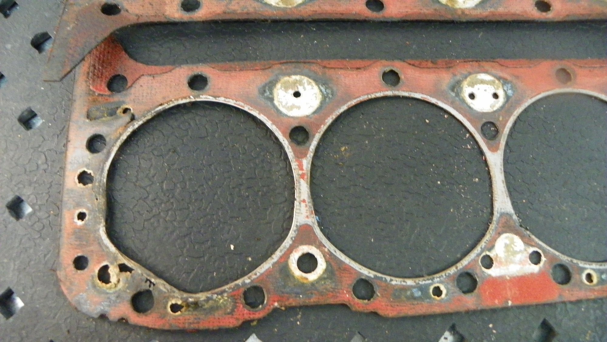

Another advisor. If you pull the intake to change the gaskets keep going and change head gaskets also. I made that mistake.
