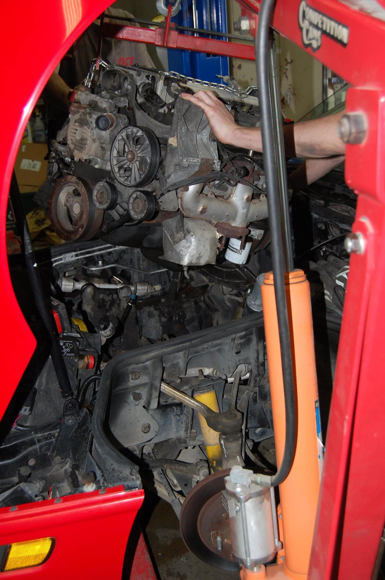

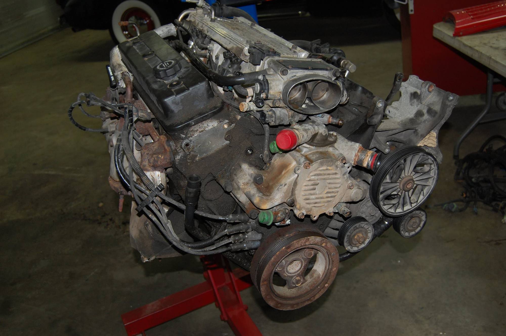

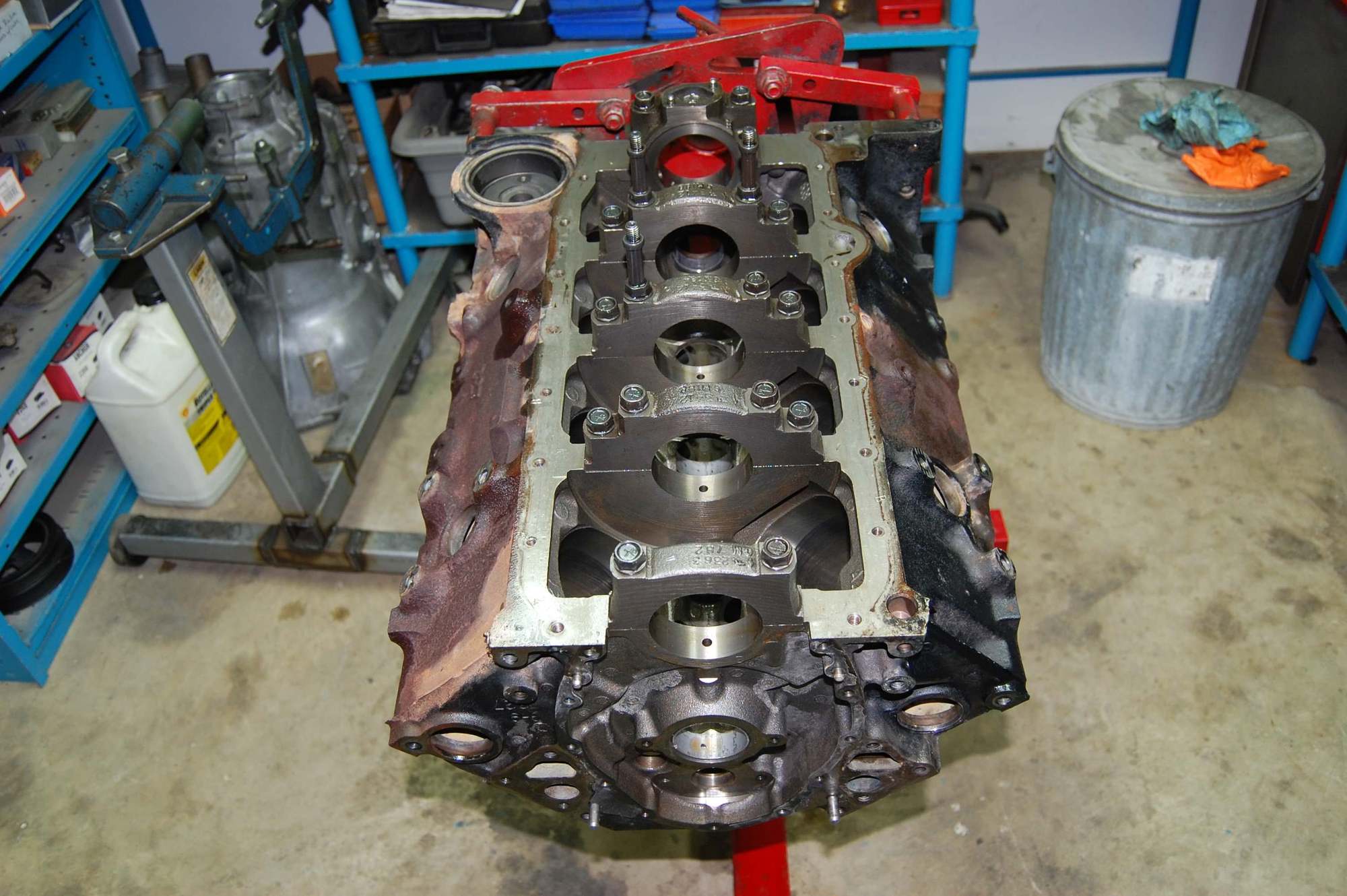

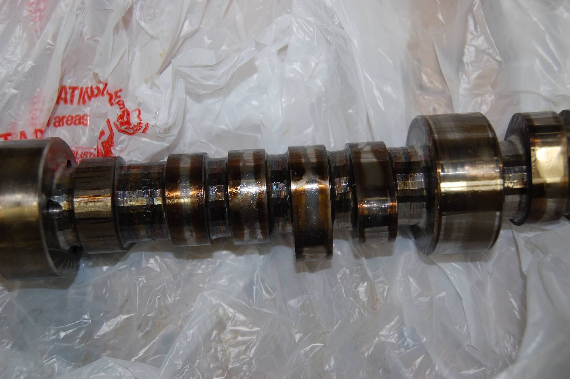

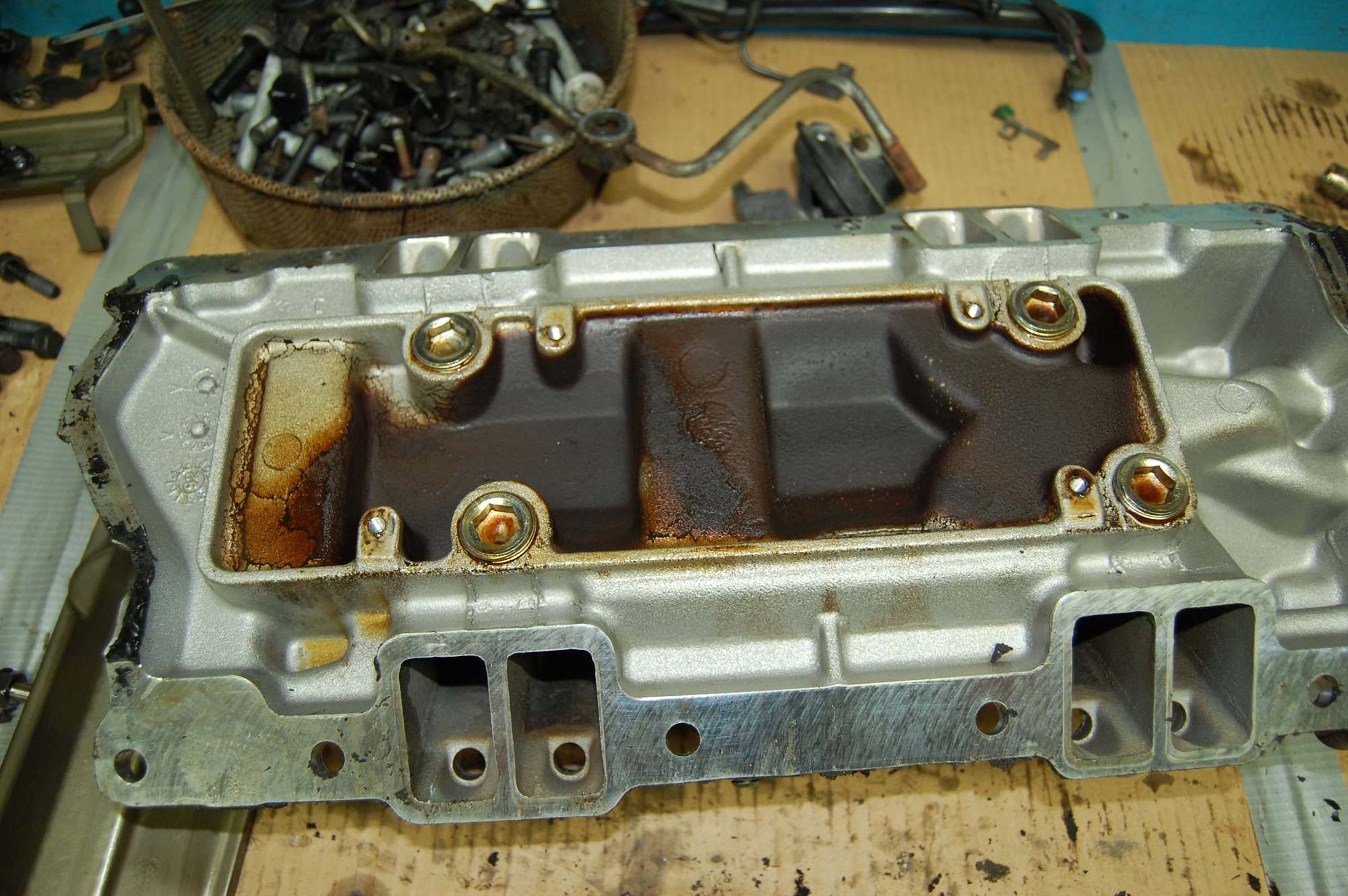

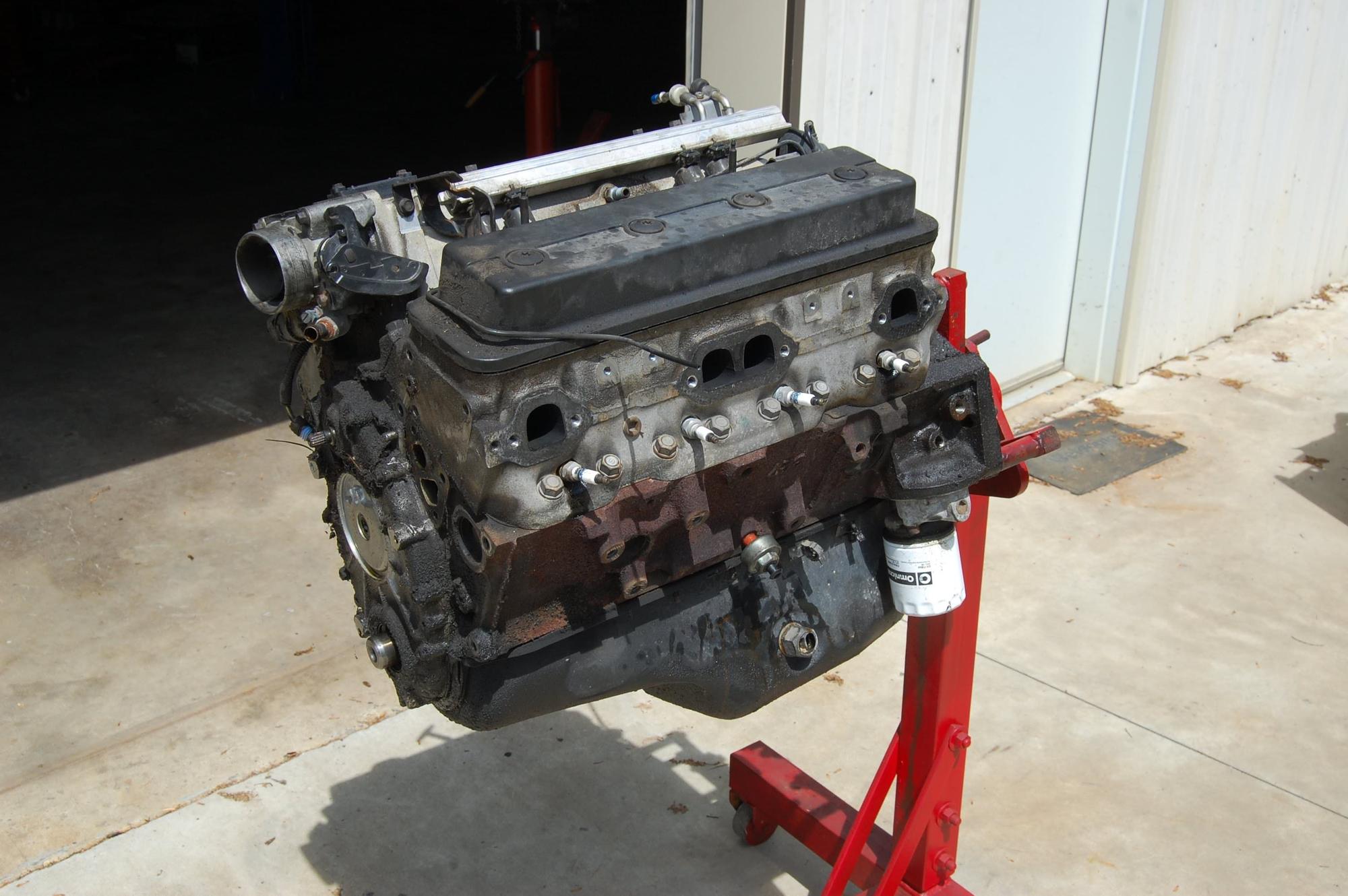

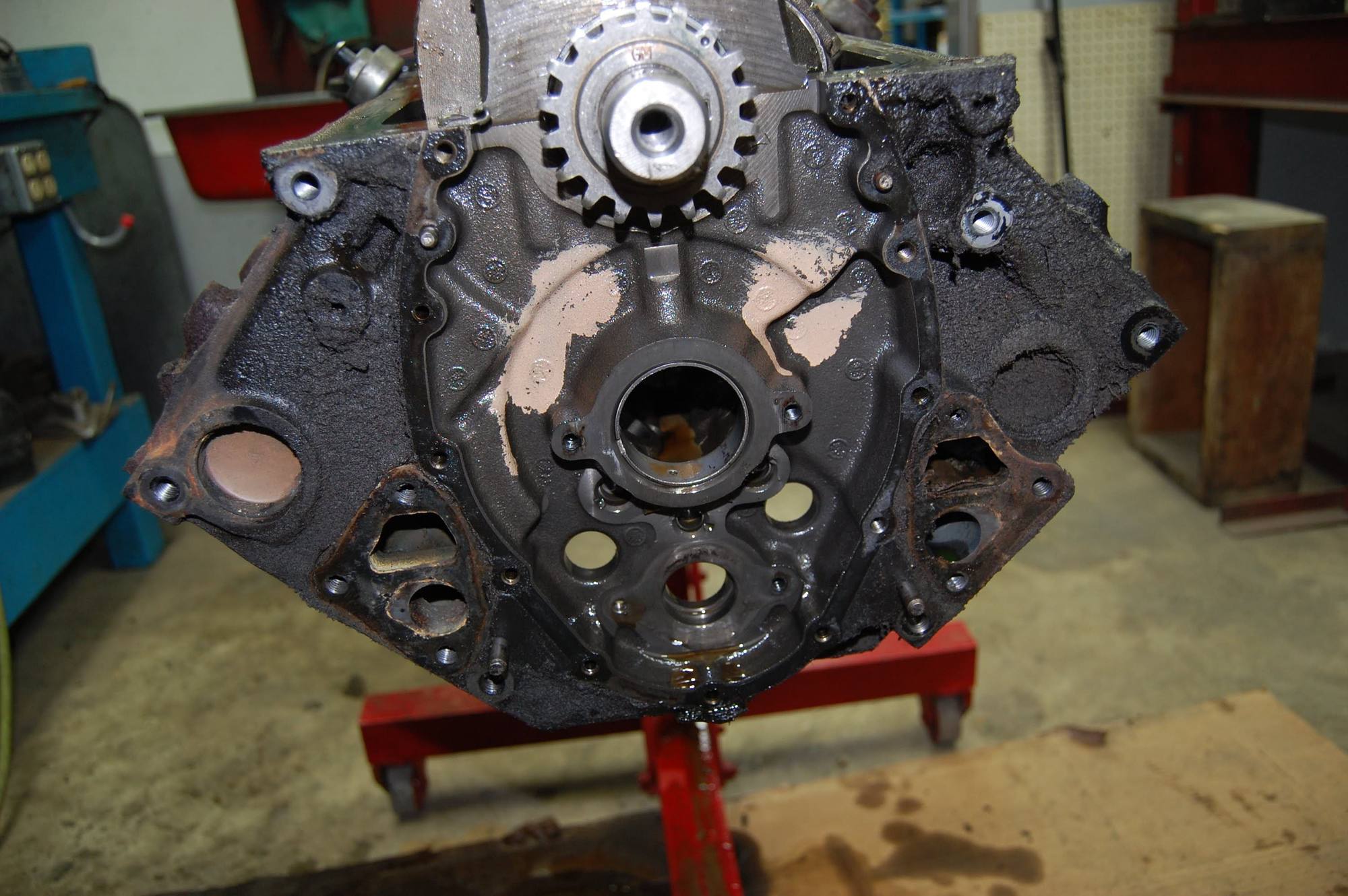

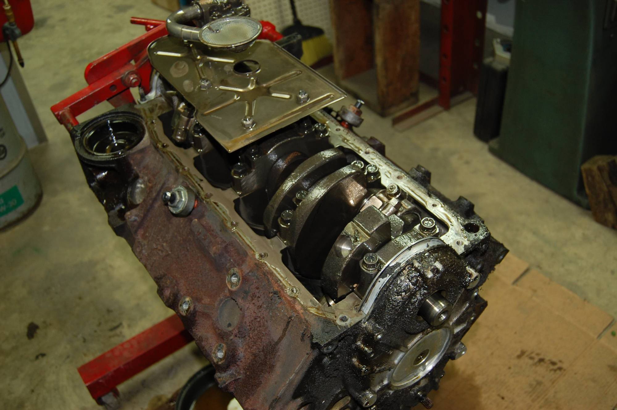

So the rebuild starts. The word from the builder was that everything looked good. We are only reusing the a portion of the motor: block, intake, and a few other bits. Replacing the piston assemblies, crank, new heads, etc.
Here are the disassembly pics:

I can't believe how dirty and rusty that motor was. Good luck with the build. Just did the top end on my 93.
Yea it was pretty nasty. Not bad for the price though. The interior, the undercarriage, and most of the body is in remarkably good shape though I am replacing all of the wear items underneath, new brakes, etc. In one of the pictures, you could see a pine needle or two in the gunk.
