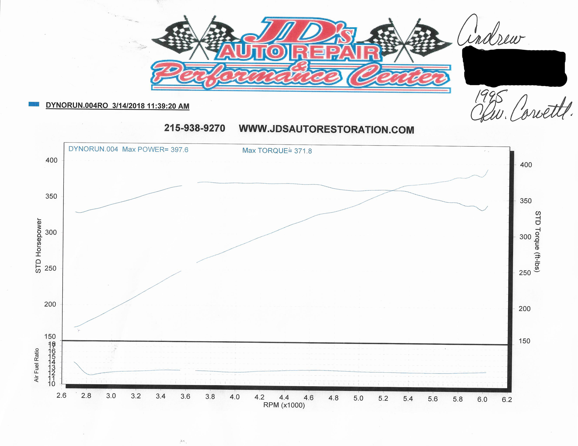

This is good advice. I just finished a 3 yr long project putting a 396 Stroker LT4 in a 95. Changed/upgraded EVERYTHING. I don't even have an optispark anymore (except for cam position) - spark is coil packs now; electric water pump.
Had I known it was going to be this expensive and long a process, I'd have never done it. Original motor (built wrong), had to do over again at builder shop including 5 new pistons, rings, honed, dipped, all of it.
I could have bought C6.
A nice 383 for a c4 is perfect.
My dyno came out like this, running 4.10s with a ZF6:
That's about as good as it gets. I have AFR 225 heads, a Lloyd Elliot custom grind Lunati...ported/polished heads matched to intake....
400HP at wheels. That's it.
Fantastic torque line (flat and steady) but so is an LS and for a lot less than I spent.
