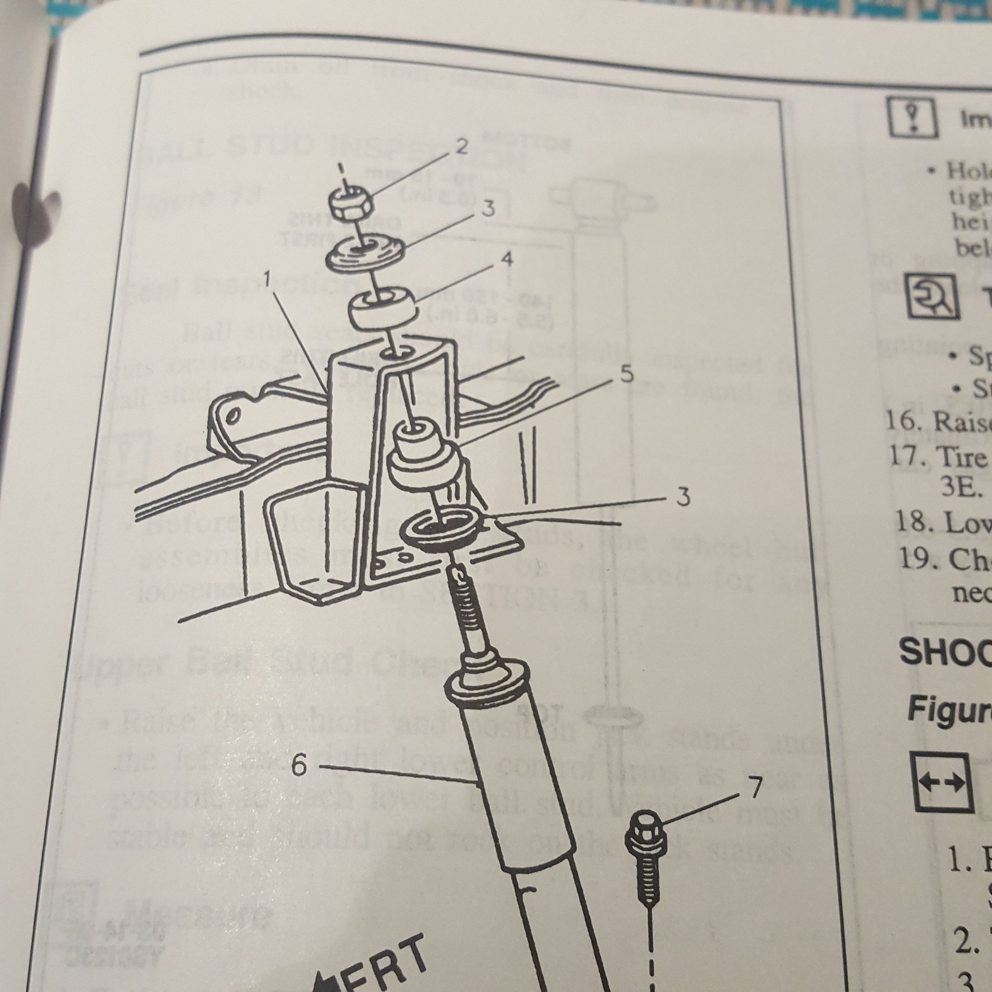

You're talking about the things in the top right of this pic?
Yes, those are required. I actually may have some extra from a vb&P poly kit I picked up a while ago; lemme check when I get home.

From the 96 FSM... . Your lower piece must have split in two.
Called Shock absorber lower/upper insulators respectively.

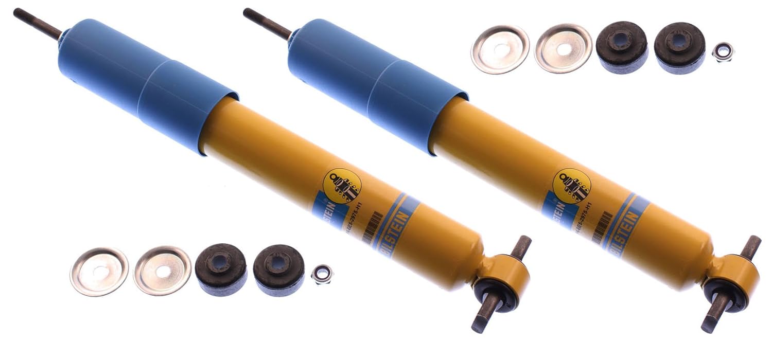

Edit: FYI, they look like this --
https://www.autozone.com/suspension-...set/354826_0_0
That stated, $20 was too steep; I'll do $15 shipped.

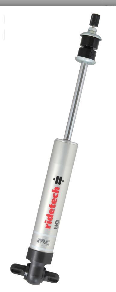

Hello Corvette Forum - I believe that I am having similar issue to that mentioned in this thread. I have had my front passenger-side shock fail twice in this manner (see attached image). It has only been 1y and <5000 miles since I had the shock setup replaced and rebuilt, and recently it failed again. Each time it seems that the mounting bracket fails, causing the shock and bushing to bust through the upper shock mount. I am running Ride Tech HQ adjustable shocks, aside from that car and suspension are mostly stock.

You mean they are busting through the upper shock mount, right? I'm trying to figure out how you had that shock mounted. What I'm seeing doesn't compute. Did you set them up as shown in the diagram in post #4? The stack of washers/bushings/nuts should be arranged like in the picture below, with the sheet metal shock mount sandwiched between the two bushings. Is that really how you had it?

Mr Miller - thank you so much for the quick reply back. Yes, this is exactly how the shocks were installed - and as you mentioned, the shock is breaking through the upper shock mount. You are not the first one to have asked the question, last year the folks at Ride Tech were surprised to see that the top retaining plate above the shock was ripped clean off. They were certain the shocks were installed incorrectly, and even consulted my repair shop (a highly regarded/capable outfit in Illinois) to confirm the procedure. The front shocks were set to, by most standards, a rather firm setting - and I live in Chicago, where the potholes resemble meteor craters. Nevertheless, I am perplexed to see that this particular shock has failed this way twice now in a short period of time.

The shock bushings supplied with new shocks are wrong for our cars. The oem bushings had one that kind of looked like a mushroom and went through the hole inot the other shock, very much like the pin top bushings I posted a link to above.
Take a look at the detail drawing above. If the bushings don't have that step to fill the hole and go into the other bushing, the bushings will be able to punch through the shock tower hole.
To clarify, drcook is talking about the #5 bushing in the diagram in post #4. Maybe that is the issue. I'd also verify that you have the correct front shock for your year C4. The problem you're having makes me think the shock is running out of travel in compression before it should.
