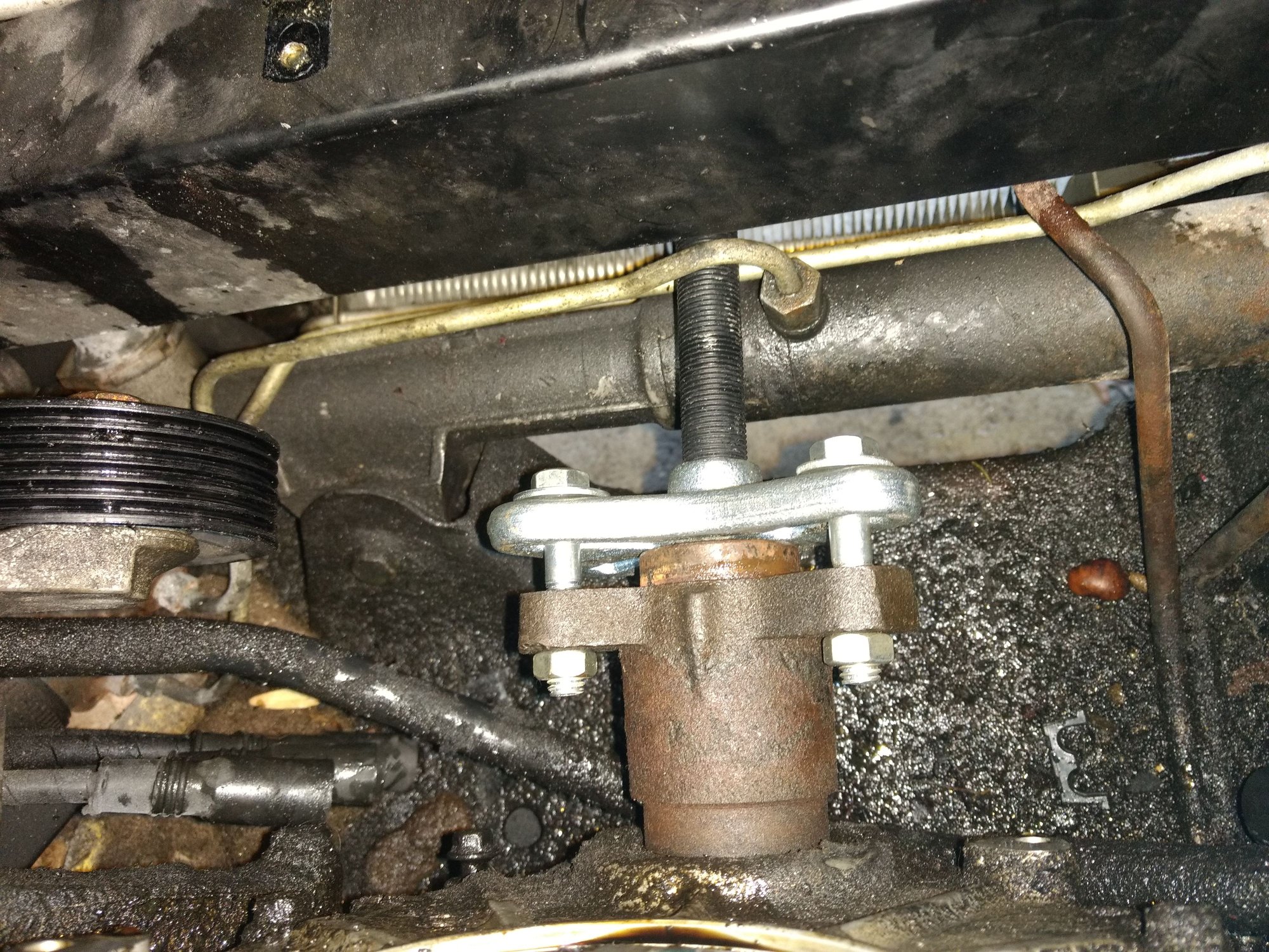

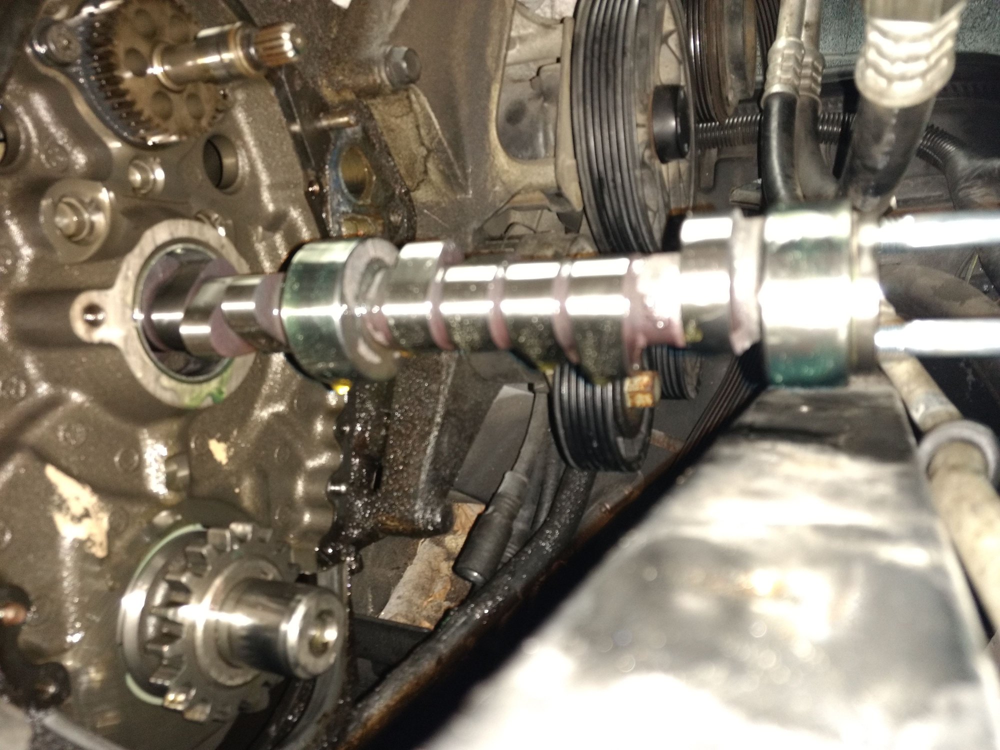

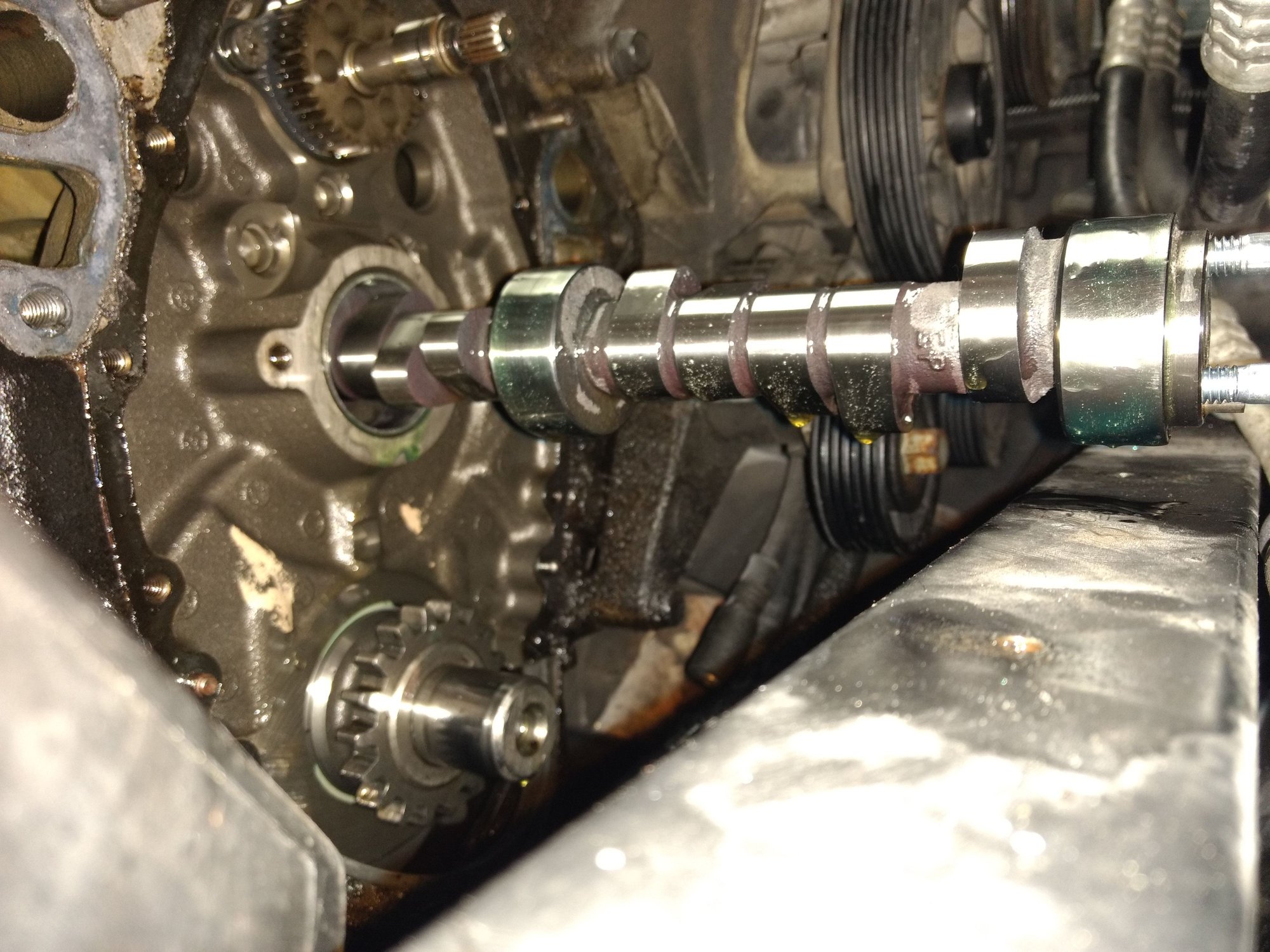

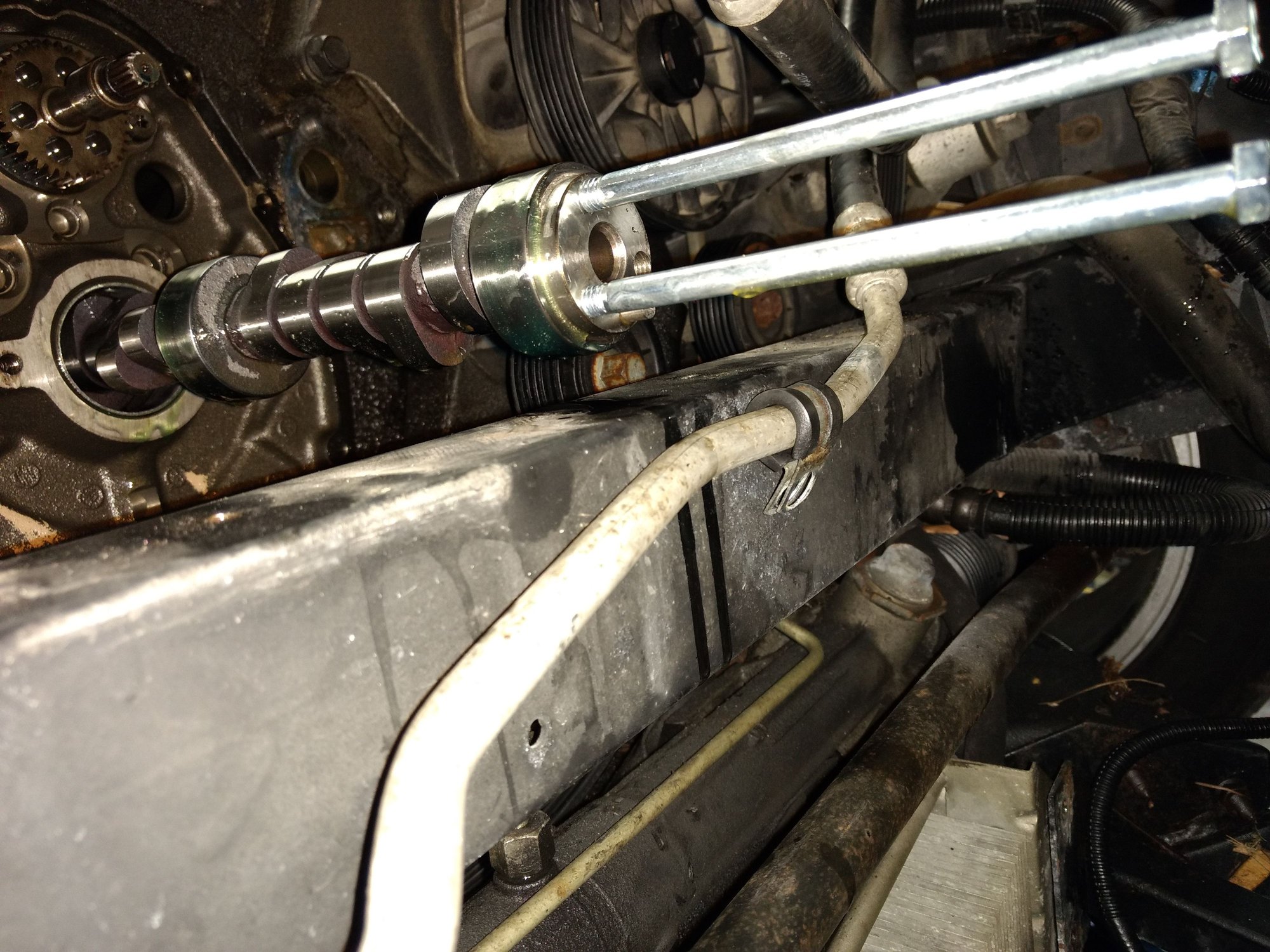

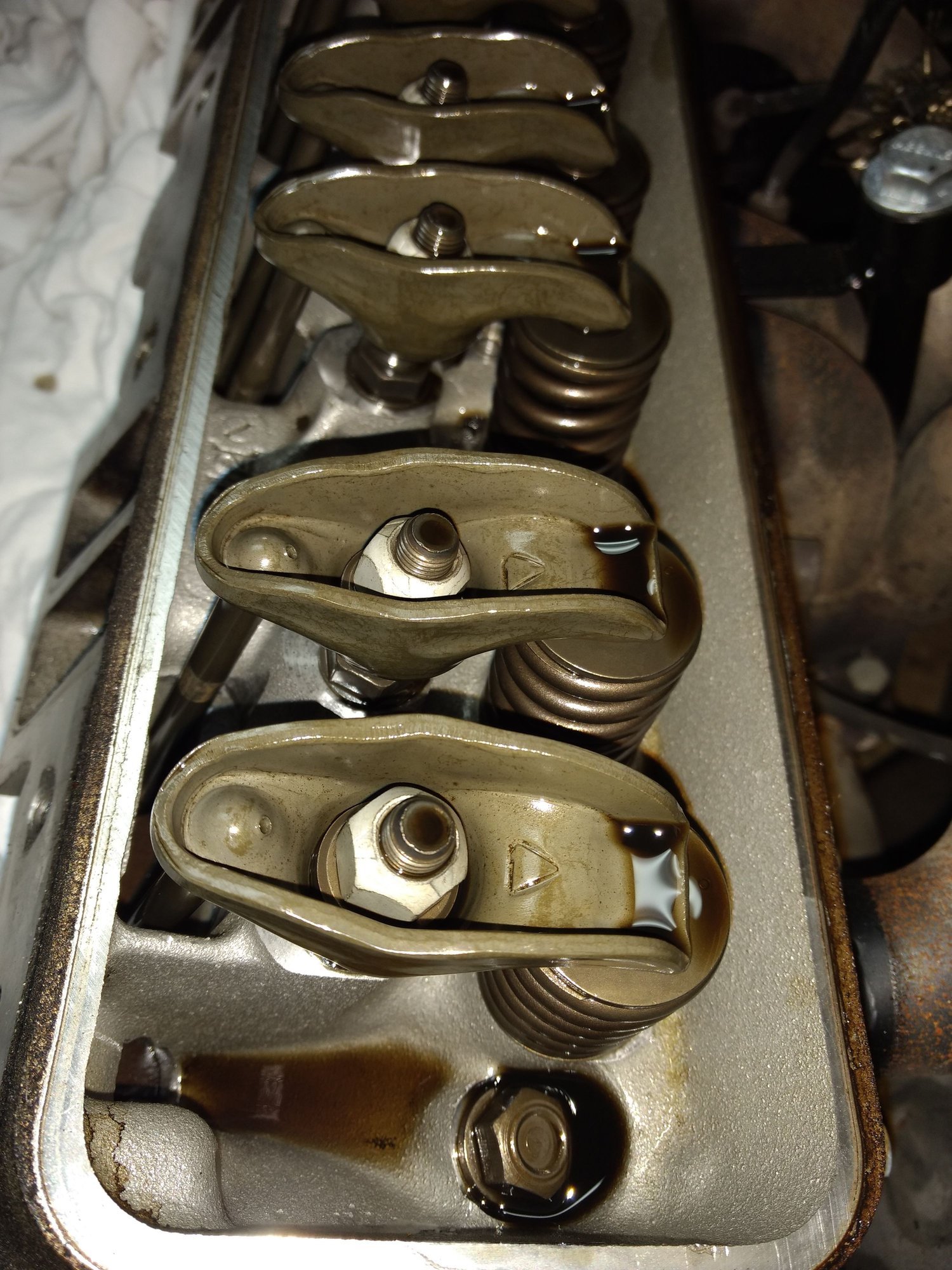

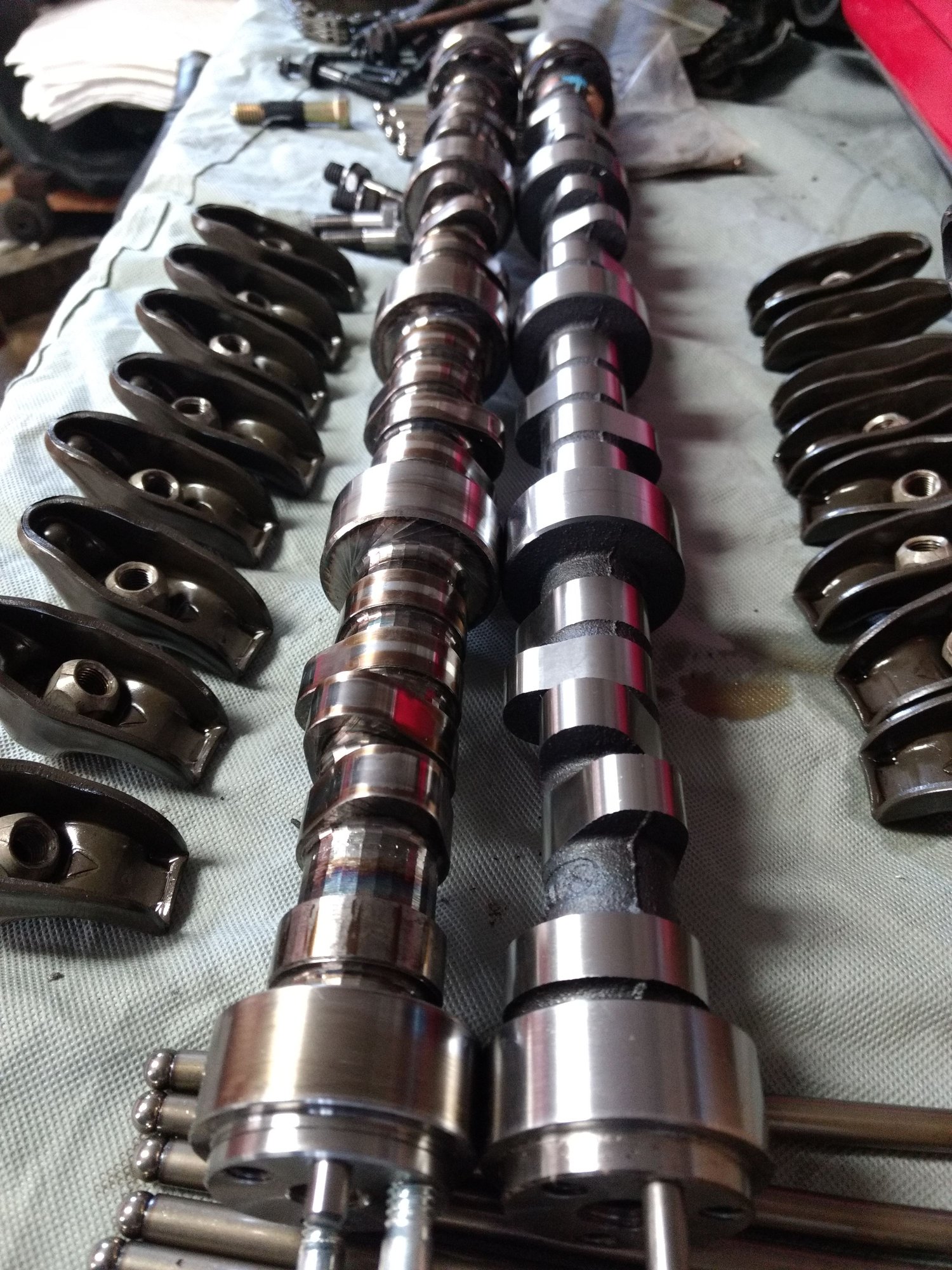

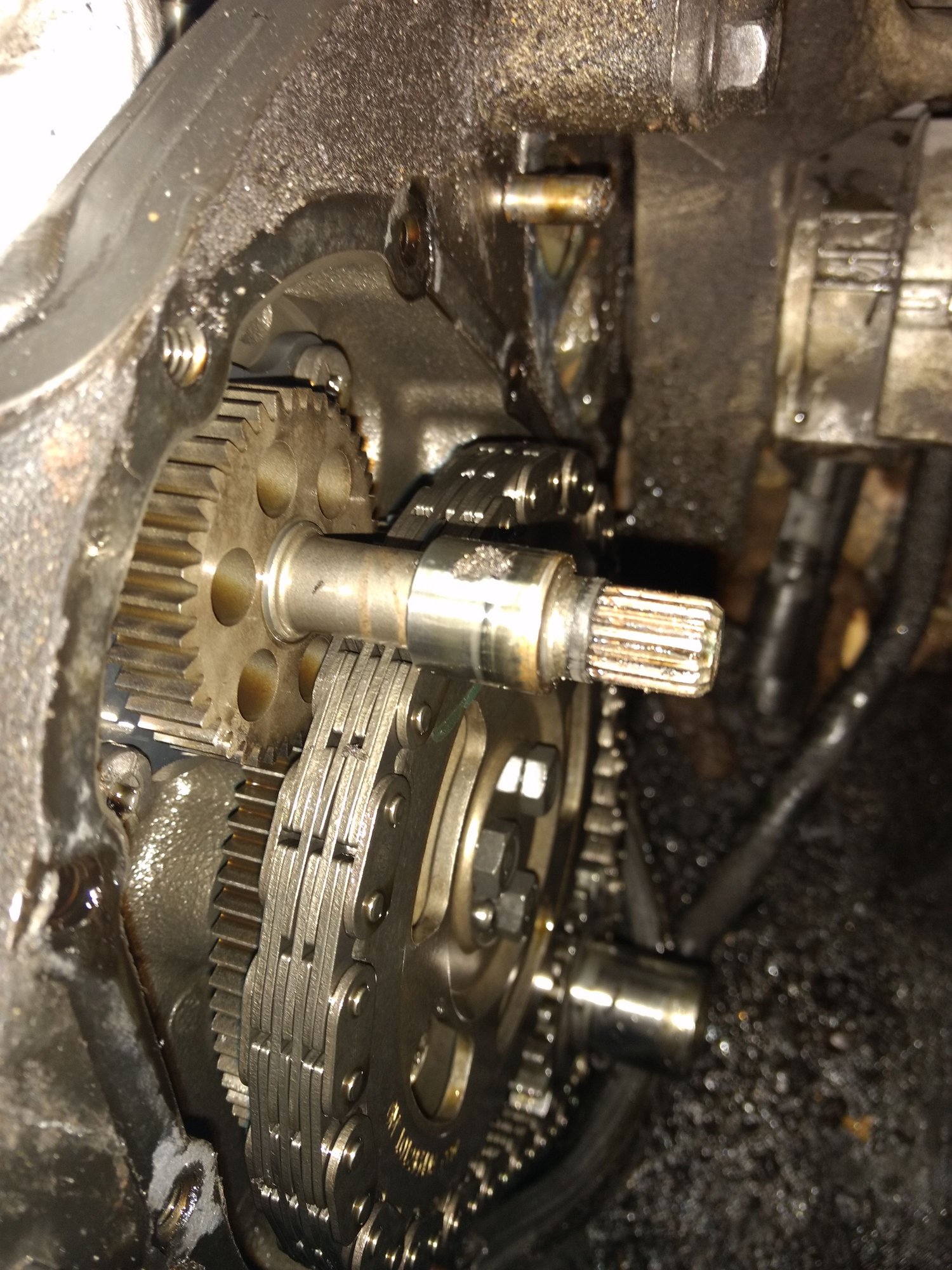

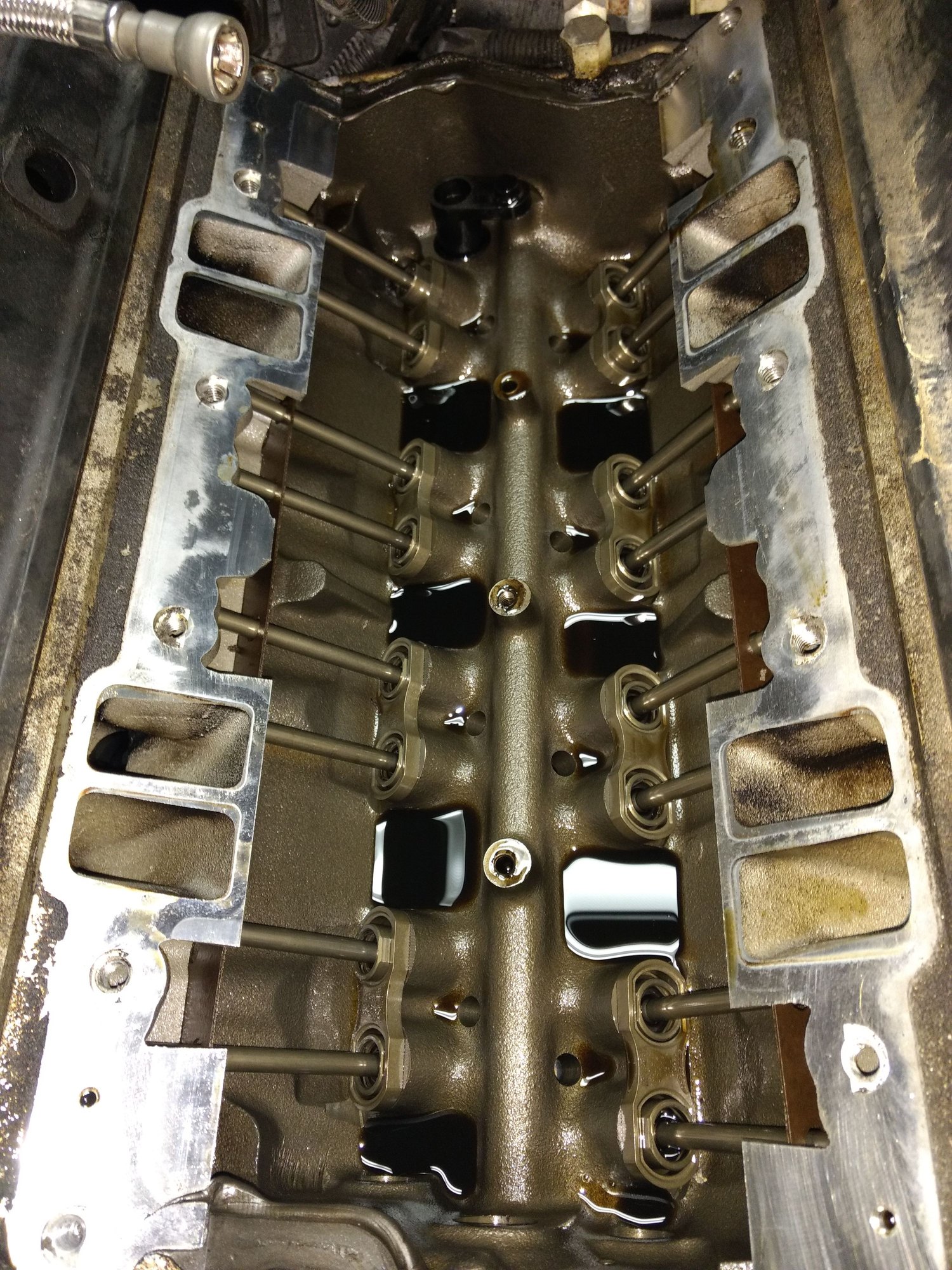

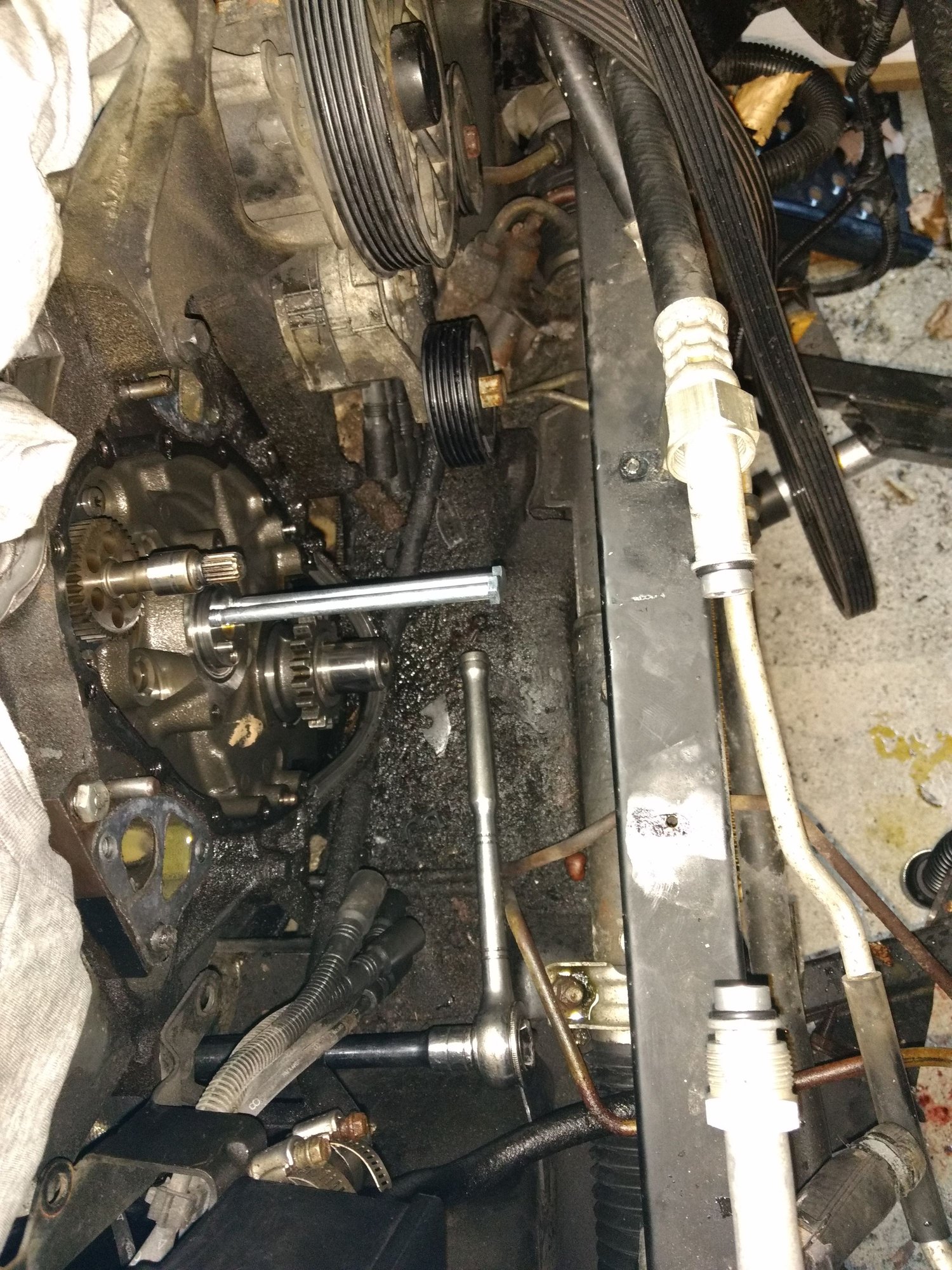

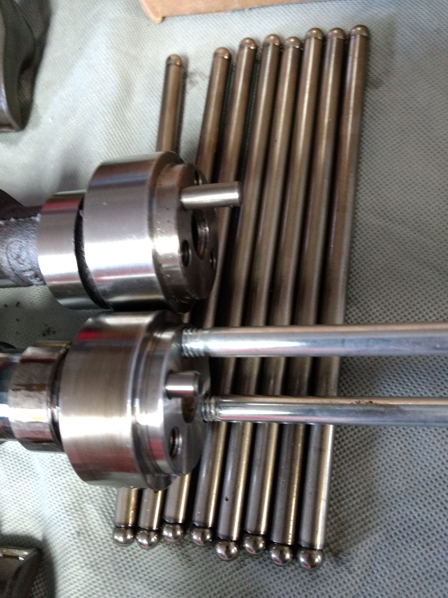

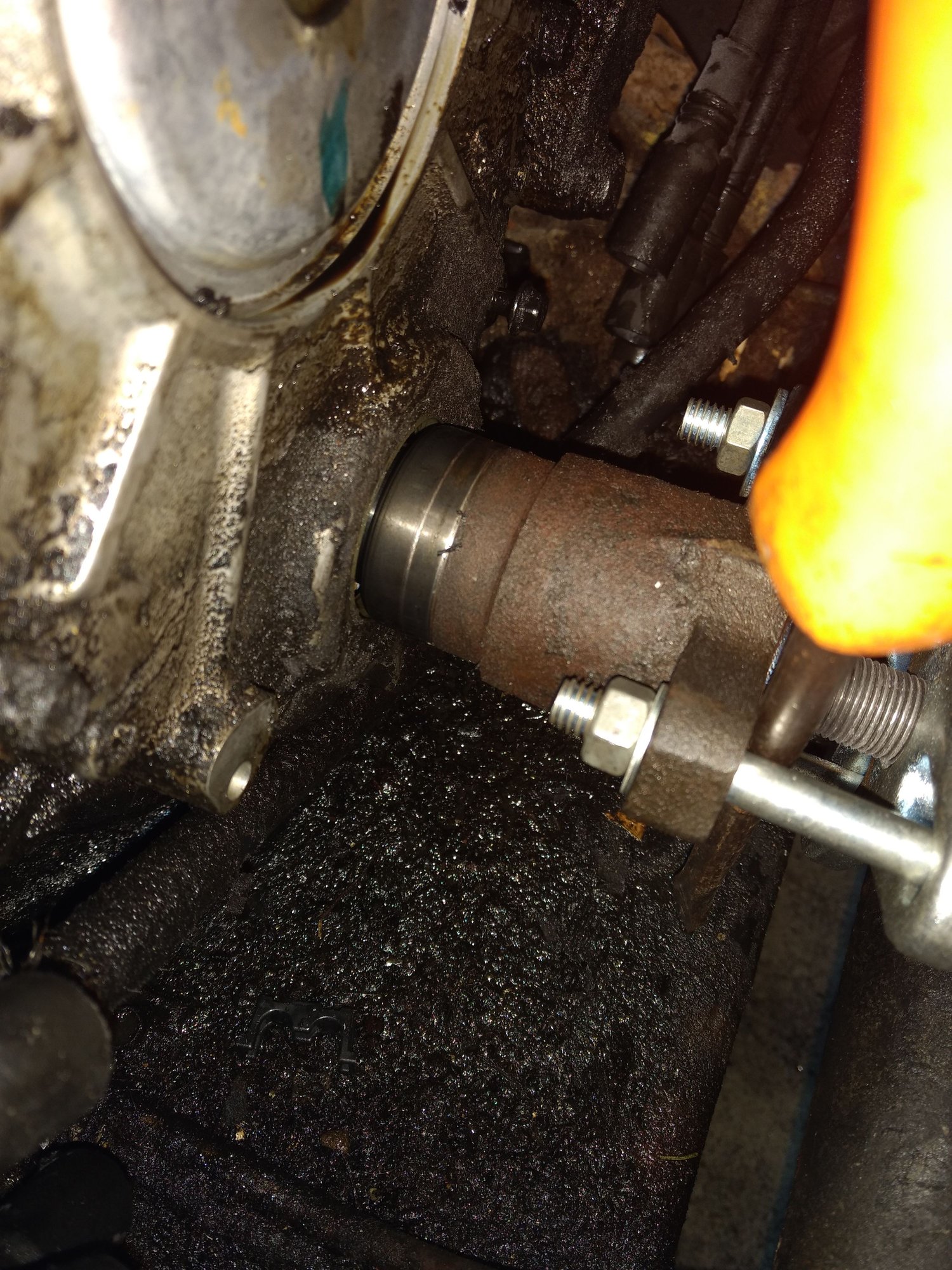

changing cam in my 93. lots of fun so far getting the dampener and hub off, but $14 Harbor Freight puller got r done. so as of now old cam out , new one in. found bad bearing in water pump so gotta get a new one. also removed cap from Opti to find one rotor screw had fallen out and was laying in there and the other ready to fall out. guess I was very lucky as right before I pulled apart I had car on dyno to get pre cam numbers. amazed it not only ran but ran tip top. 278whp for stock LT1. next need to pull passenger cat to get oil pan off to swap that gasket, swap valve springs then measure and order pushrods. hoping for 330 Rwhp.

Impressive you you were able to get the hub off with a HF puller, not an easy job without the recommended Kent Moore tool. its lots of work but worth the benefit in the end!

Originally Posted by 84 4+3
looking good. Got some cam specs to share?
223/231 .557/.571 110 lsa
yea I am sure I pushed the puller to it's limit. but got er done.
cam spec. 223/231 .557/.571 110 LSA

Looks like a healthy cam. Good thing the inside of the motor is cleaner than the outside. Looking forward to hear the results.
I hear that. outside is messy. Intake gasket AKA permatex has obviously been leaking a while. should be a bit cleaner after it goes back together. I am extremely pleased with how clean and unworn looking the internals are. 70K Mi.
