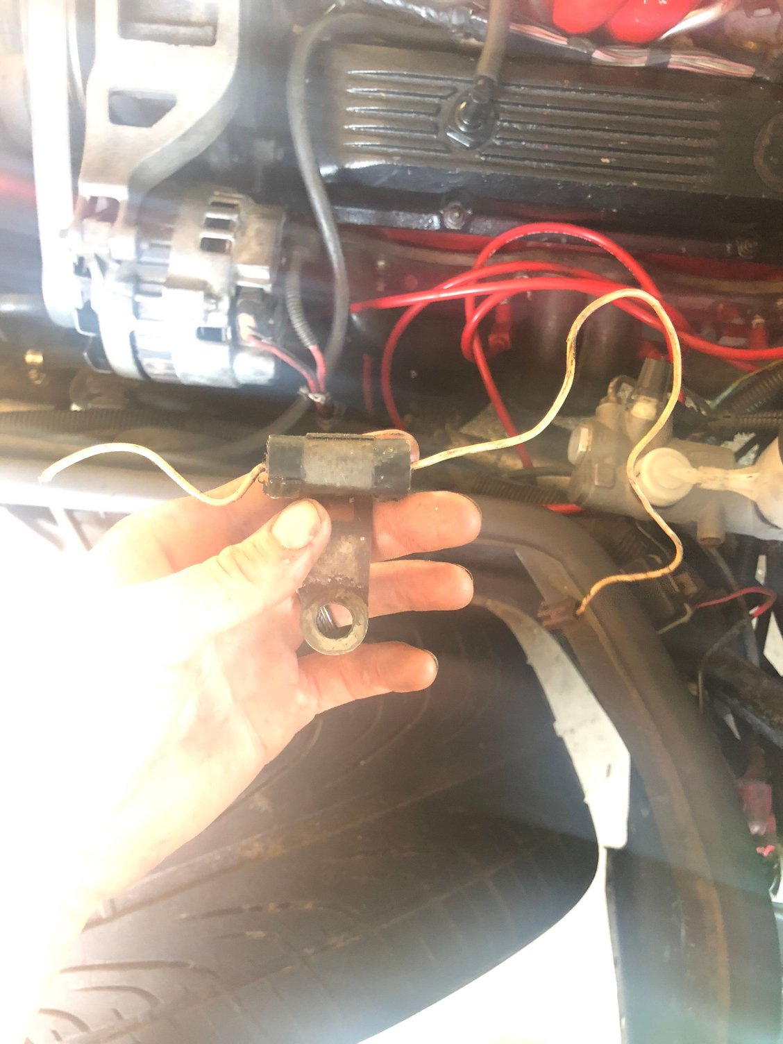

Hey all. I have this wire and it looks like maybe it goes to the oil sensor back by the distributor. Can anyone help me out ?

That appears to be a tach filter. The connector to the HEI appears to be intact and closer to your thumb appears to be cut from behind the cylinder head in the harness bundle. Might be an easy find.
Your tach doesn't work. What year car? Looks to be either early '86 or '85.

correct. It’s an 86. Also, can anyone show me their wiring harness on the driver side? I have all the injectors hooked up but then at the end of that, I have three wires that go to nothing ?
