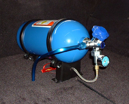

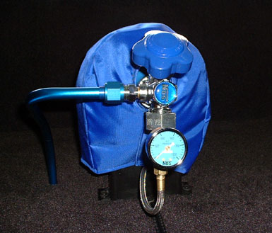

I DID IT ALL MYSELF,THE KIT WAS AROUND 600.00 WITH BLANKET AND GAUGE,IT HAS 100 OR 150 SHOT,THE TOP STILL FITS PERFECT,THE CUBBYS ARE FILLED WITH 2-12" WOOFERS :yesnod:

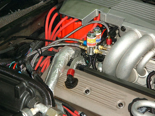

Nice job. Nice looking car? What year is it? Very nicely detailed engine compartment.

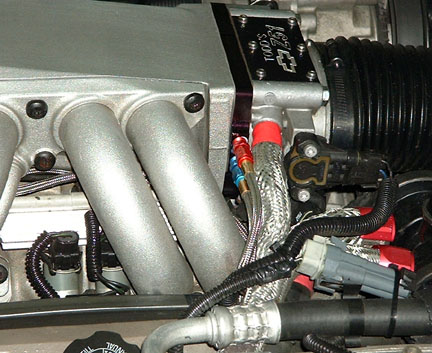

where did you run the no2 lines (from the trunk to the tpi)

Down thru the front bracket down the pass side interior and out thru the firewall. It worked out perfect in length. :yesnod:

I have installed a wet plate system. I also installed the jacobs mastermind to protect my engine. When I went out to test it . The mastermind kept shutting off the nos. It turns out my stock fuel pressure regulator was not strong enough. The jacobs mastermind saved me from burning my pistons by running to lean. That is why i bought it you might want to protect that good looking vette.
