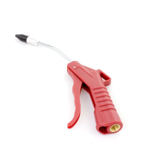

When I've done this method previously, I used rubber bungs/plugs that are used for pressure testing things like Turbo cold side piping for leaks. They are rubber w/steel washers and a bolt going through, you stick 'em in the pipe, tighten the bolt/nut and they expand and lock into the pipe. They're typically a couple bucks and look something like this:
Plug one end, then use a similar rubber on the other end, but w/o the bolt through it. Meter air pressure into the muff through that bolt hole -or what ever method you've devised for your air delivery- using something that gives you a lot of control of the air, like this:
Get the dent glowing red -the red'er/hotter you get it, the more control you have IMO b/c it won't take as much pressure to push it out. Anyway, heat it hottest at the points where the metal has to change shape the most to eliminate the dent. You basically manipulate the shape of the metal w/the air pressure and the way that you heat it. It's pretty cool to do, and rewarding. Leaves no marks other than bluing from the heat, which you could probably mostly wire brush out after done and cooled.
