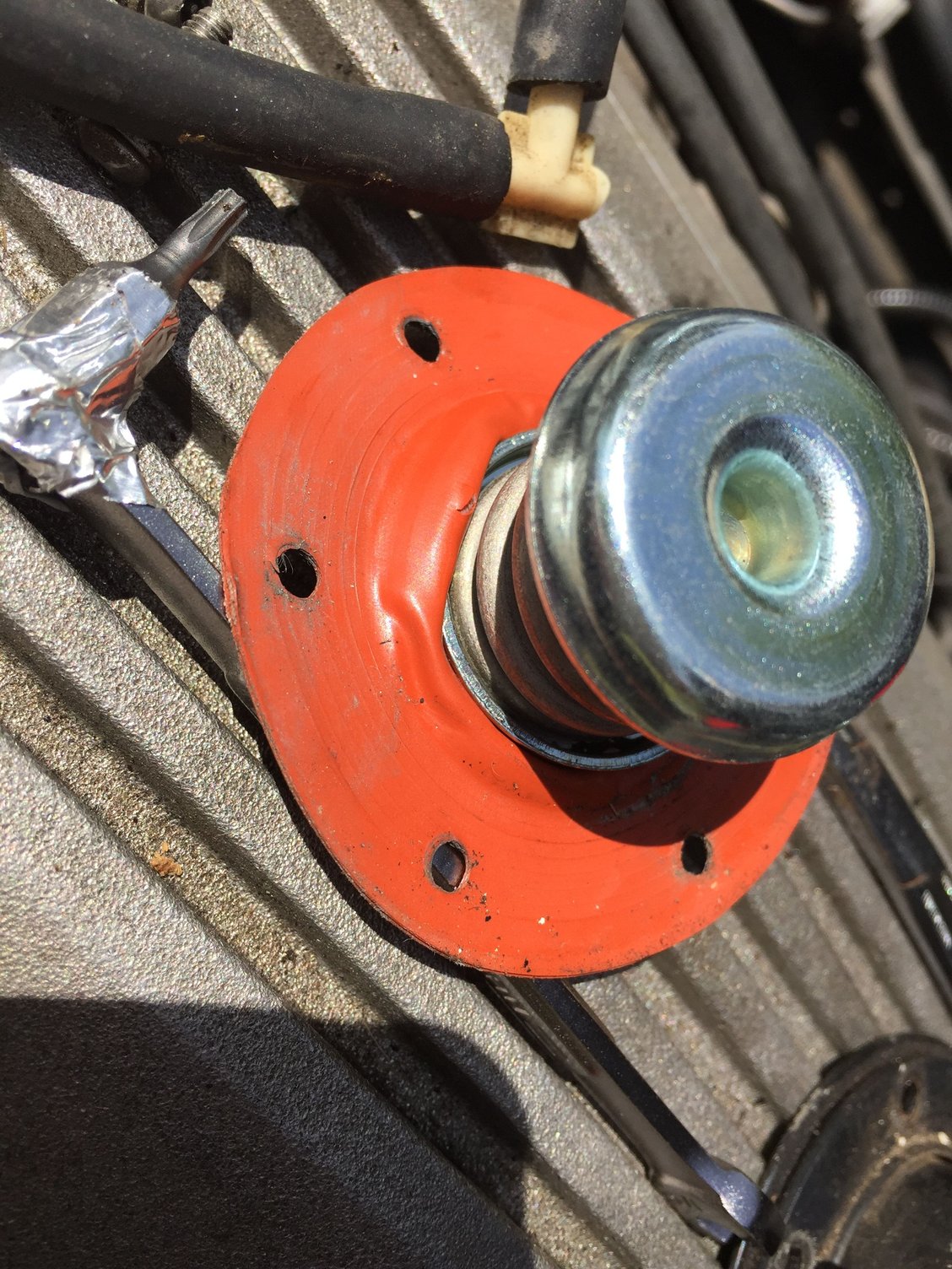

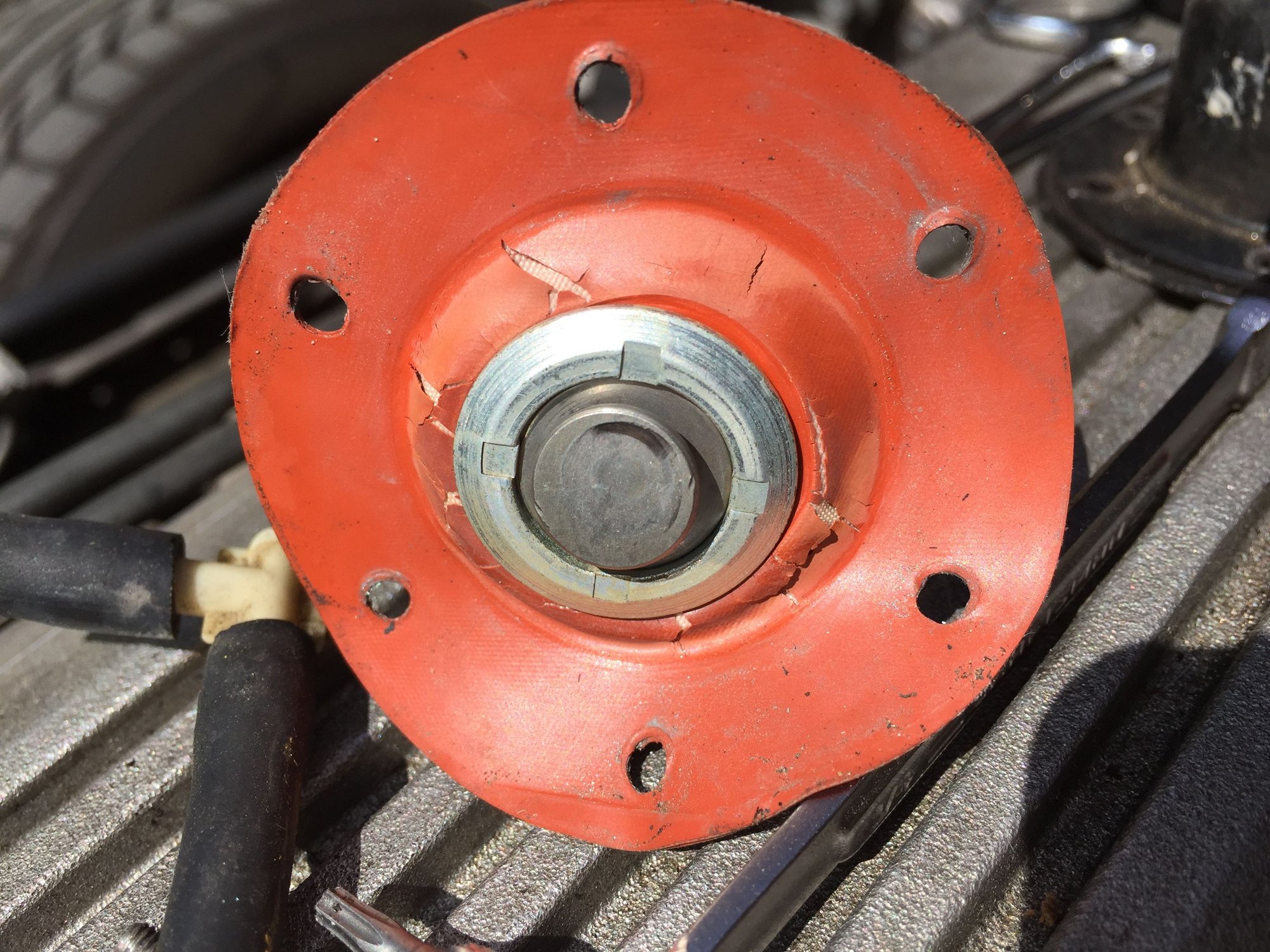

Buckeye88 has a good point ... pull the vacuum line off the Fuel pressure regulator and if there is any gas at all in the line or
the connector then your FPR diaphragm is bad. Ask me how I know X2 since I owned my 1986.
Bad FPR diaphragm
Bad FPR diaphragm
That's about what mine looked like, but where you can see the cloth/weave backing on yours that's where I still had a few scraps of rubber. I pulled the vacuum lines once and they were full of gas.
I have no issues with gas fumes or smoke since changing the diaphragm. Now if I could just get the OD unit on my 4+3 to quit blowing ATF all over my exhaust she'd be a lot more fun. I'm dropping the OD pan tonight to get rid of the remaining ATF and shutting the OD down until she's put away this fall. Between the smoke from the ATF on my exhaust and having to degrease the underside of the car every time I drive it it's easier to drain the fluid and drive her as a 4speed for the summer.
