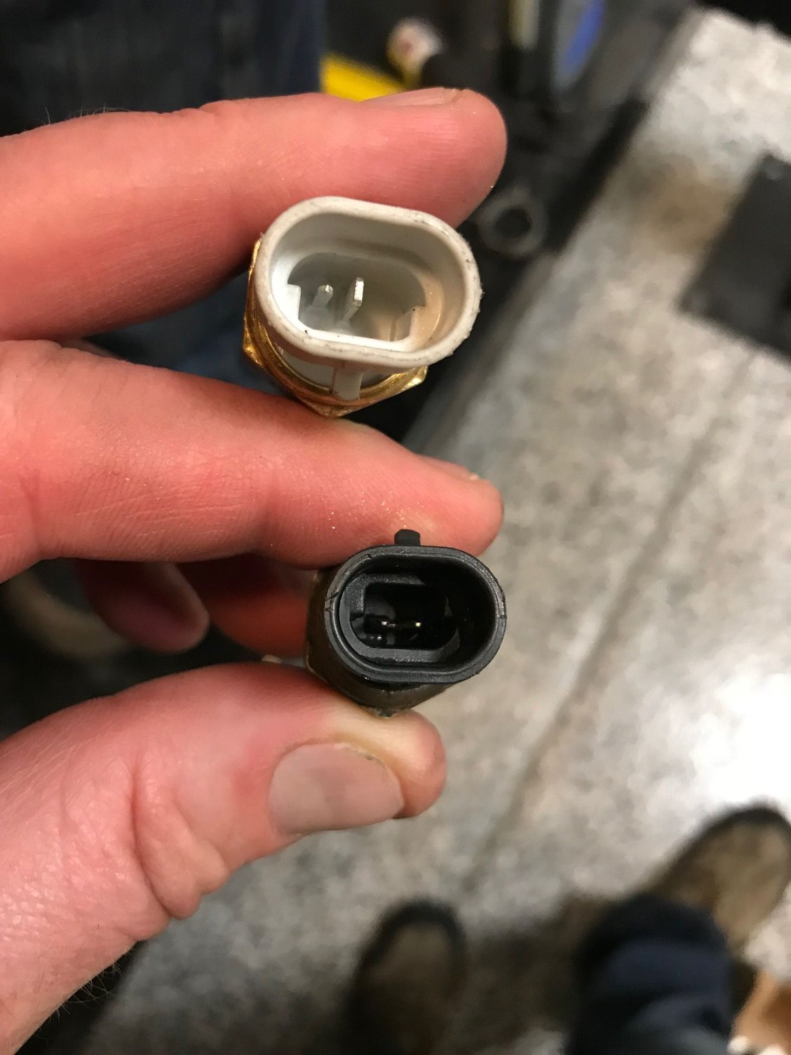

I purchased what I thought was the correct temp sensor (the water-pump mounted one) for my '94. The plug doesn't match. Any ideas?
Here is the sensor I purchased. Below is old and new side-by-side. Thanks in advance for you help.

The upper is for the TEMP GAUGE right cylinder head. You either ordered or were sold the incorrect part. The part you bought is used a a 'single pin' sender and is thought to be correct for your car unless the original was changed to a different design.
If you use a GM# as a reference you'll get a correct part. These GM part# would be good to use as a reference 15326386, 12146312 or 25036979. The first number is I believe the GM 'most current' and the second from most GM SPO publications from the C4 era.
