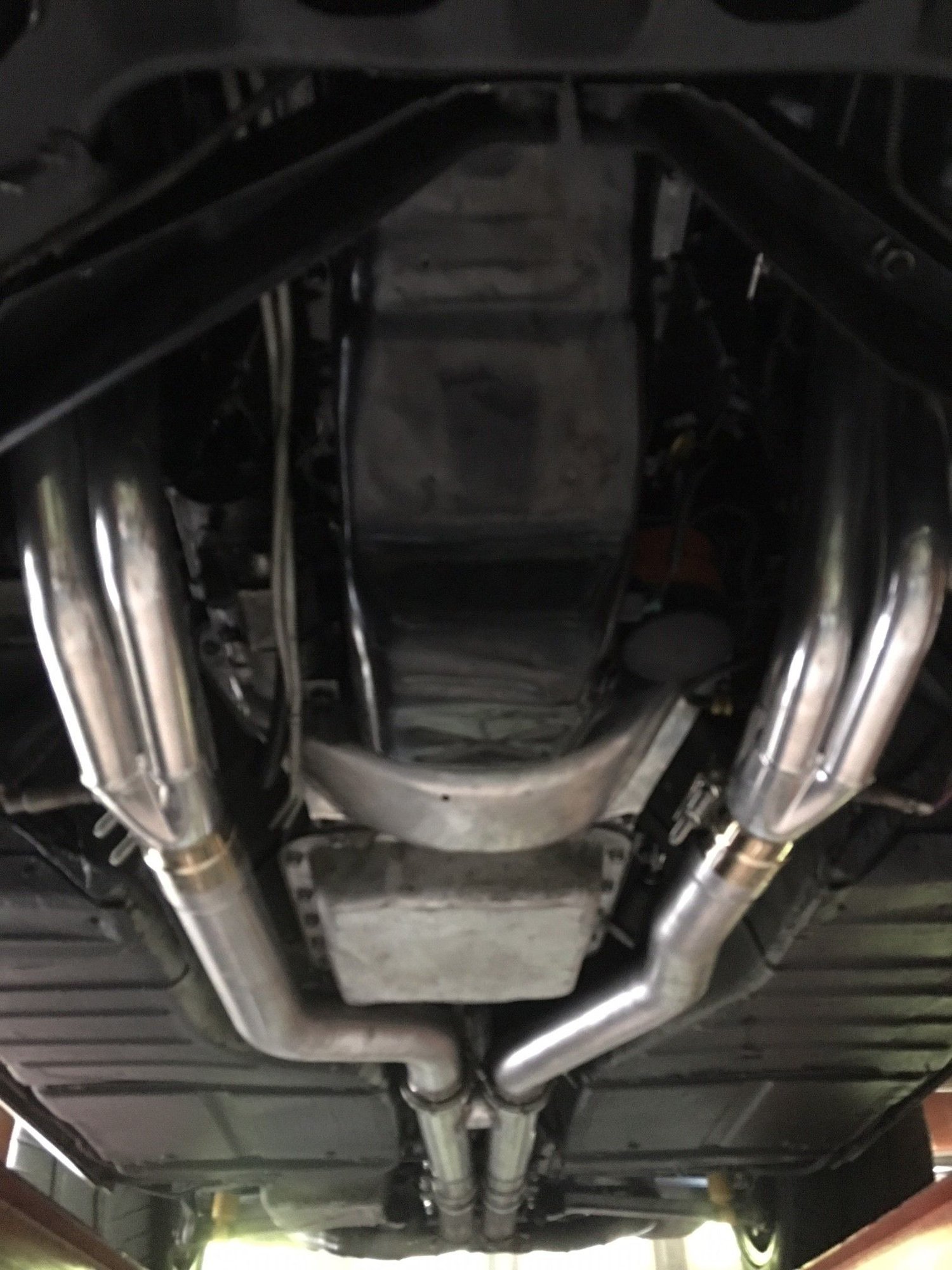

I finally got my exhaust together after a complete buildup that included a Golen forged 383 shortblock, LE2 Top end and 1 3/4" Melrose ceramic coated headers. Very pleased with the end result.
The OEM cats and resonator were removed from the system.
I used the Melrose intermediate 3" aluminized intermediate pipes and decided to build my H pipe instead of the Melrose X pipe.

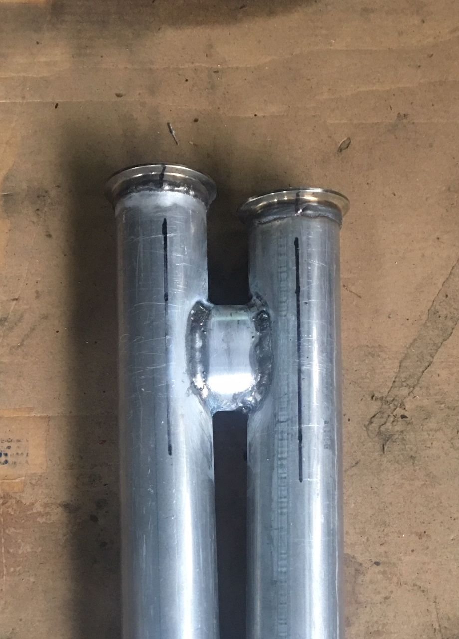

The X pipe: I really like the sound of the H pipe over the X pipe so I decided to buid my own. Used a little piece of 3" oval pipe to connect the two main pipes.

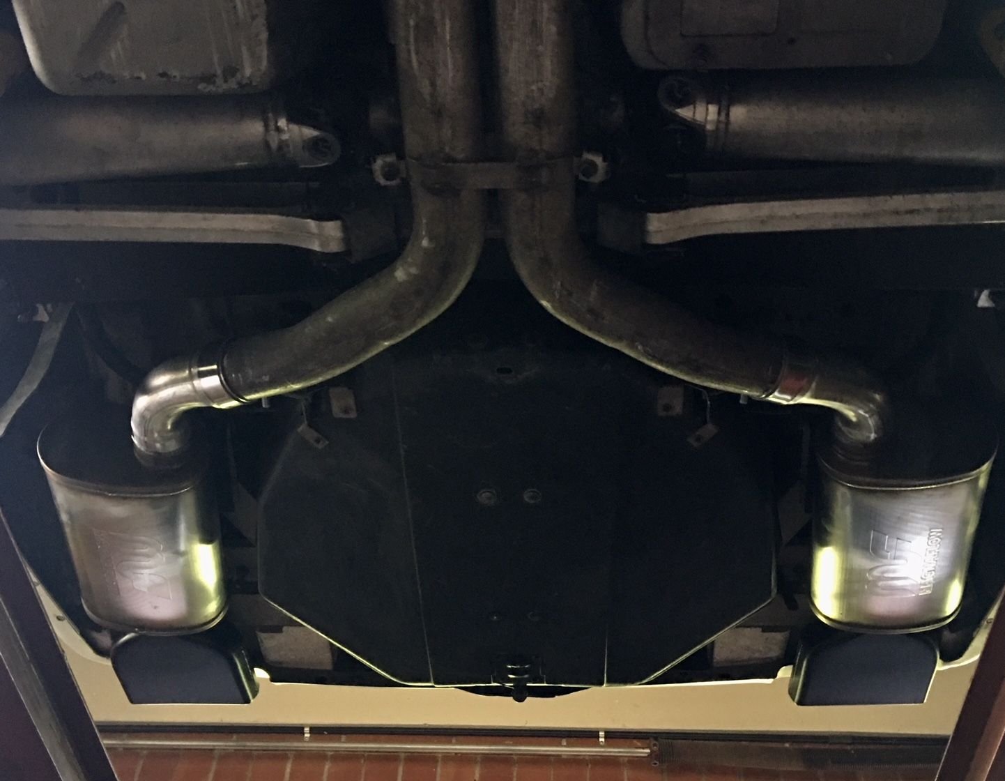

And the final element: The previous owner had Flowmaster series 40 mufflers installed, and the combination produced a very annoying drone at around 1800 rpm. I substituted these wit the Corvette Central Magnaflow mufflers with LT1 tips. I must say I am very pleased with the combination. These mufflers made a night and day difference. I still get very little drone at the same engine speed, but nothing that bothers(I am 62), and the sound of the H really puts a smile on my face every time I get on it. The CC mufflers lined up very well and the LT1 tips give the car a stock appearence.

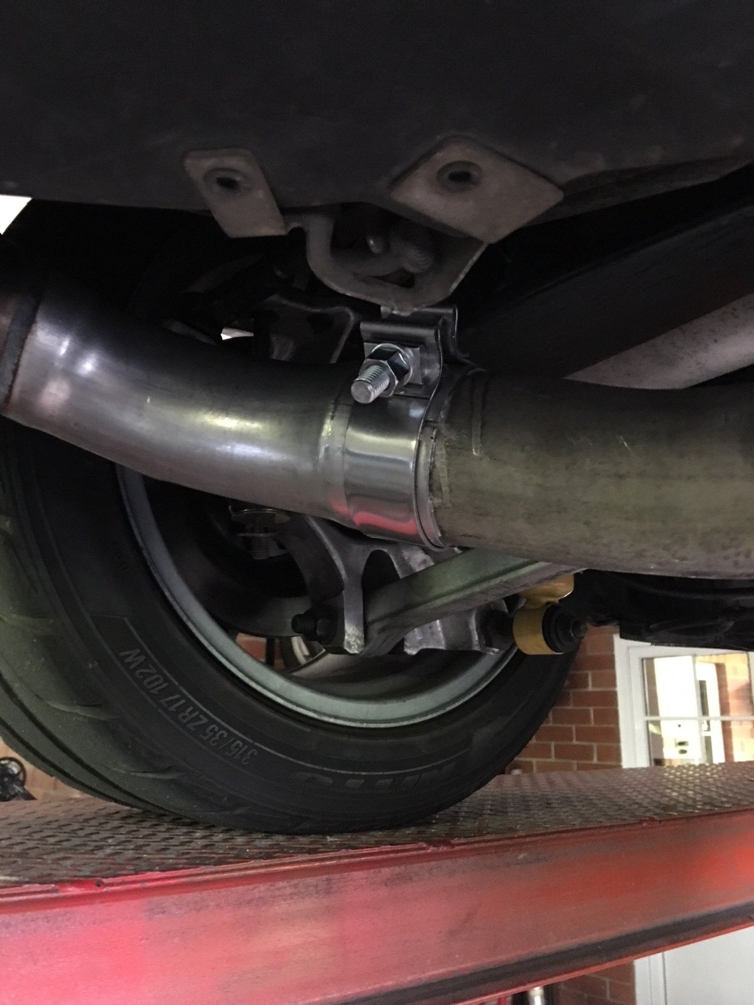

One thing I did do was replace the U clamps provided by CC with these exhaust band clamps wich I like to use in my builds. They provide a good seal without distorting the pipe if future disassemblies are needed.
