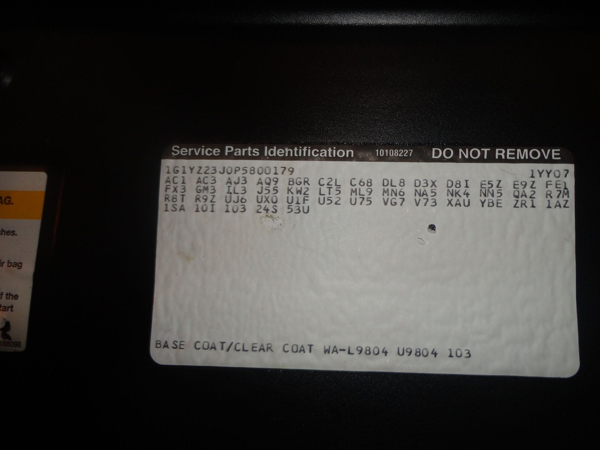

FASTAZU's Avatar
FASTAZU
Joined: Feb 2002
Posts: 11,616
Likes: 1,055
2018 C4 of Year Finalist
2015 C4 of the Year Finalist
St. Jude Donor '16
You can find what rear ratio came in it from the factory by looking at the codes on the tag in the storage box , my 95 auto came with the optional 3:07 I think the other is around a 2:59..
Tag looks like this is from my 93 Do a search on the codes you will find every option that was ordered from the factory.
https://www.corvetteactioncenter.com...95/95prod.html
