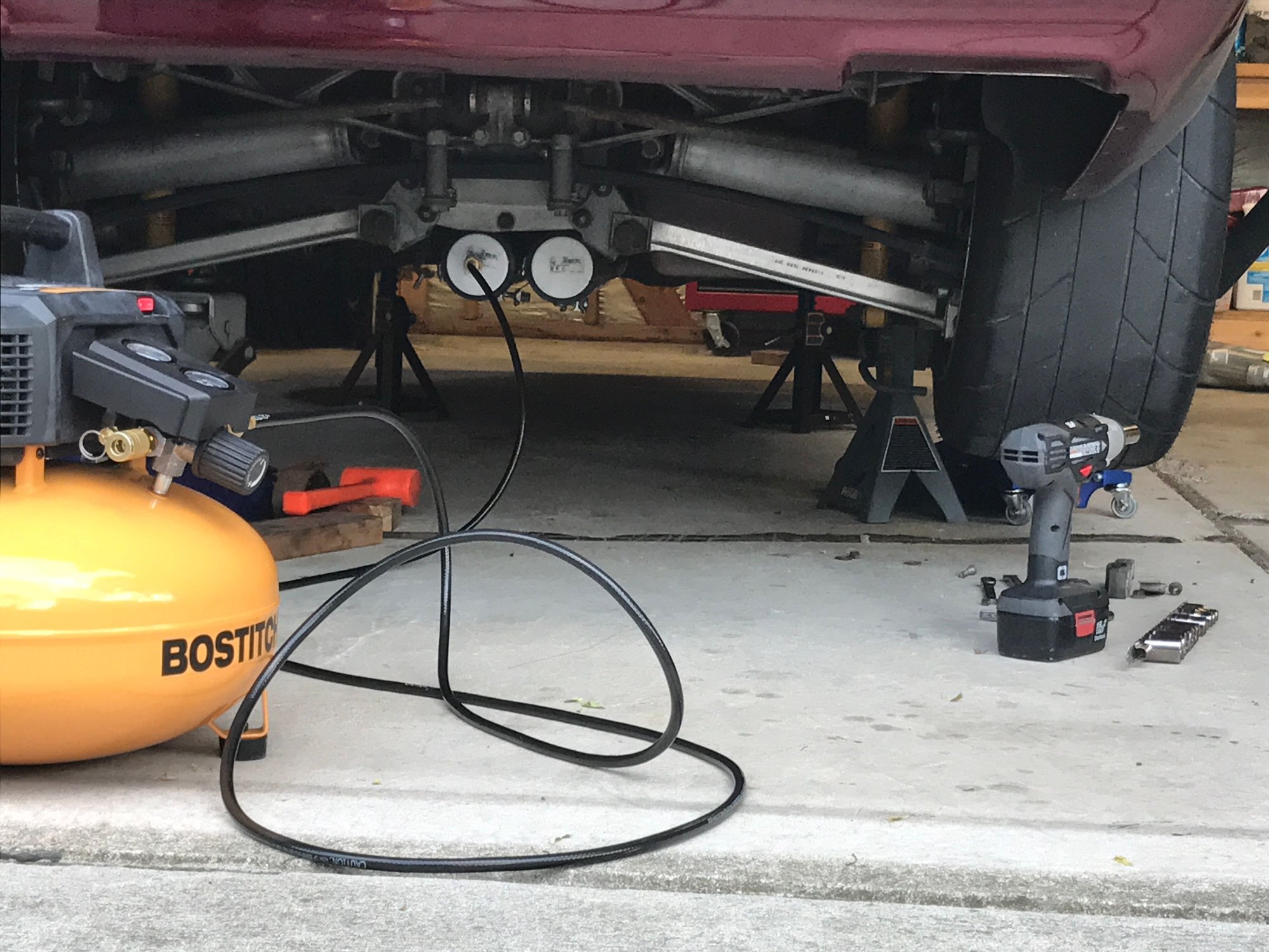

Pressurize the exhaust with compressed air and use a soapy water solution to track leaks.
You'll have to rig up an adapter at downstream of the leak to force compressed air in.
And close all the exhaust valves too?
There is enough back pressure generated in the system to easily find leaks. Been doing this for years in development/validation dyno engines. You’d be surprised how many welds and gaskets fail over thousands of hours of testing.
Recently made an adaptor for my 93’s system to find a couple leaks
