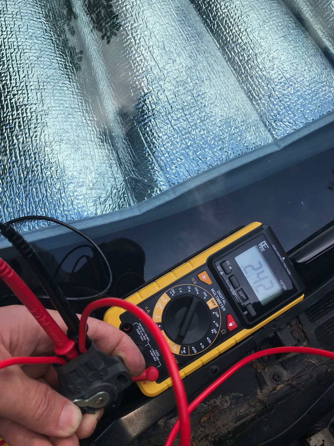

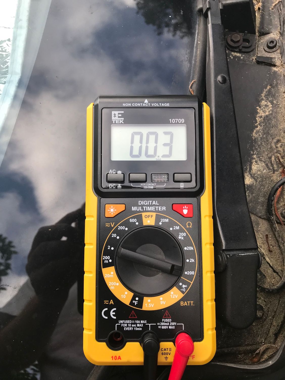

Dude...got the replacement, hooked it up and it actually read lower than the other one
I took some 10g wire and jumped the bottom 5v and top ground to the TPS removed from the car. Then measured directly from the TPS middle pin to see what the TPS was putting out. It put out bad data. The car wiring is just fine, the issue seems to be with BWD's build quality and QC. At this point I said screw it, returning the BWD and have a new Delco unit coming. I don't care it was a little more money, I just want a NEW sensor to work lol

Jesus.. the chances of that have got to be incredibly slim. That's very frustrating.
