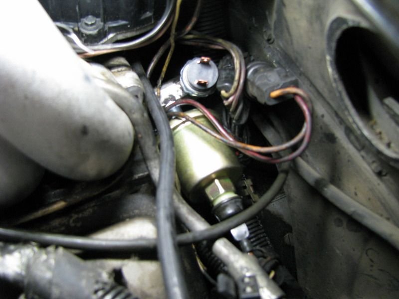

I agree with pressure check. Now the 85 has 2 oil pressure sensors behind the dizzy. one is for pressure guage and one connects the power to the fuel pump after oil pressure builds. Make sure the wiring is good they look like this
Good luck diagnosing.

after days and days of poking around and replacing the fuel pump. The fuel pump fuse isn't getting any power and I can't hear a click from the relay when I turn the car on. So is it the relay or could the fuel puressure switch stop the fuel pump from getting power if that went bad?
