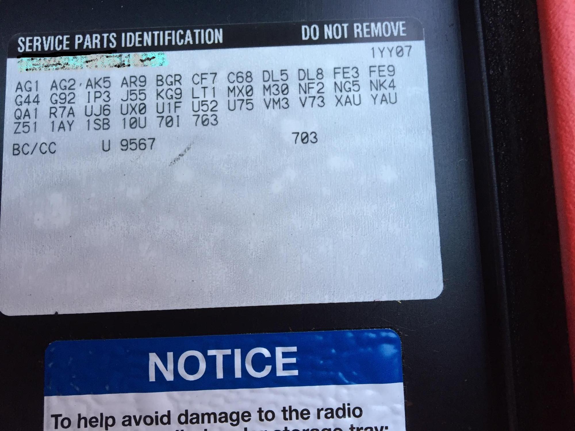

also as far as wheel sizes go, look for th SPID label as WVZR-1 said above
QA0 - Styled aluminum wheels, 17 x 8.5"
QA1 - Styled aluminum wheels, 17 x 9.5"
QA2 - Styled aluminum wheels, 17 x 9.5" front, 17 x 11" rear
QB6 - Styled aluminum wheels 17 x 8.5" front, 17 x 9.5" rear
https://www.corvetteactioncenter.com...o/8496rpo.html
Looking at the label for my 1996 LT1, you can see my car shipped with 17 x 9.5 on all four corners

Check the certification label on the 'drivers door' it would have the correct information. If a '96 had 275's on the rear 'originally' ALL 4 would have been 275 and the car would have had the Z51 option.
SPID would show XAU and YAU SPID for 255/285 I believe XAA and YAA
