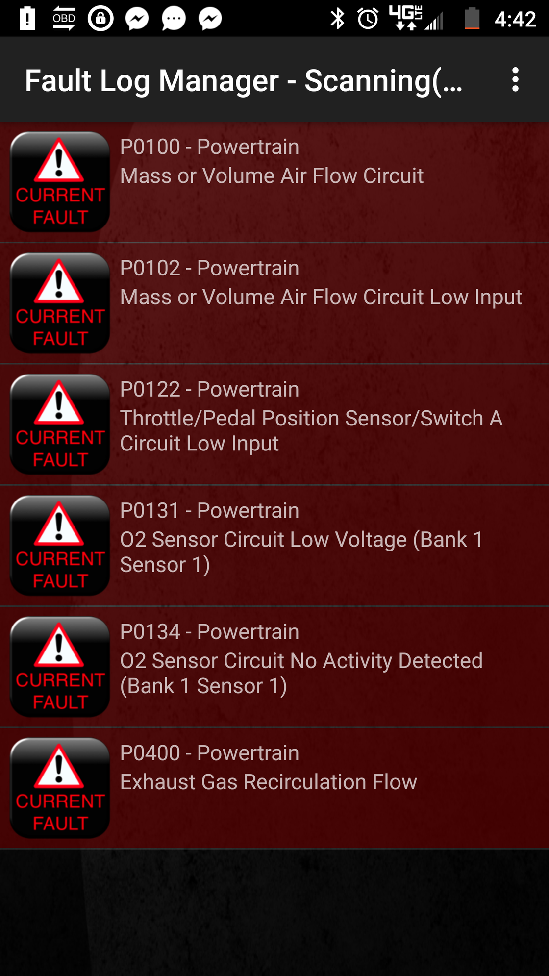

I'm getting no spark. I've had my Opti rebuilt, replaced the coil because I thought it was bad, but still nothing. I've taken the coil wire and held close to a ground and turned the Opti. I can hear the injectors clicking, but no spark. I've got power to my coil and I've checked every fuse I can find. Is there something I should look at or is it certainly the ICM?

The ICM is turned on by ECM. Codes?

I'll check again but the only codes I've gotten are EGR and O2. That was before the Opti and coil, so I could have new ones.

Right now I just want to make sure it will run, so I don't have the maf plugged in.
