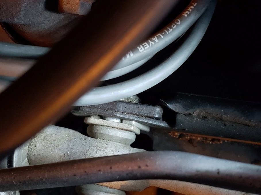

OK I finally got around to taking some pics of these shims. Any suggestions, guidance or other comments will be appreciated:
Two pics of the upper control arm mount, passenger side, rear bolt:
One pic of the upper control arm mount, passenger side, both bolts:

The one is sort of not positioned properly. Loosen it up and rotate it back into position, then tighten it up again and forget about it.
