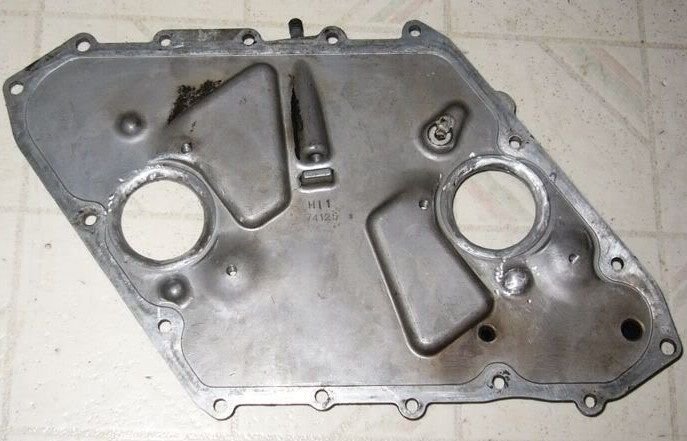

Originally Posted by Tom400CFI
FYI, I totally removed my swirl plates, and radiused the underside/outlet of the TB's like a reverse velocity stack. My distribution, going by plug reads, was as good as with the stock set up. Driveability and fuel economy were unaffected.
Here is what it looked like:
