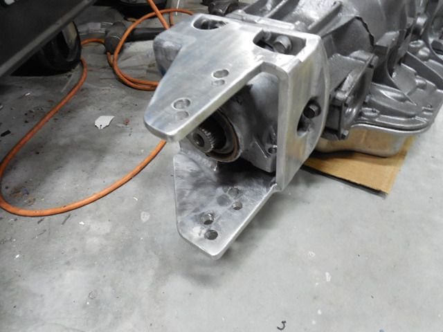

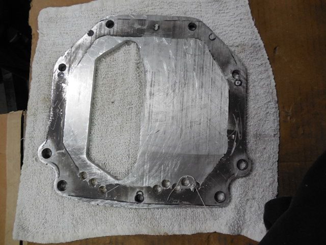

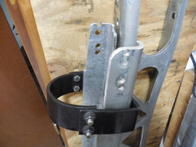

….. For what its worth … I hand drilled 4 holes in the end of a D36 C-beam APPROXIMATELY 3/4" behind the original holes … I drove it on the street and drag raced it for years with NO ill effects … When I switched from the 700R4 to the TH400 I hand hacksawed the end off the same C-beam and hand drilled holes where needed to fit up to the adapter that I had made for the swap … I'm still using that C-beam after hundreds of passes at the strip … again , with no ill effects … my D36 driveshaft was shortened by 1" and re-balanced by a professional driveline shop … I am still running the mid plate adapter on the D44 (with a spool and 4.10 gears) that allowed me to use the D36 Batwing in place of the harder to find and more expensive D44 Bat … You can do the conversion either way of course , but you will not switch back to the D36 and the D36 driveshaft and C-beam are pretty much worthless … not so for the D44 shaft and beam …..
