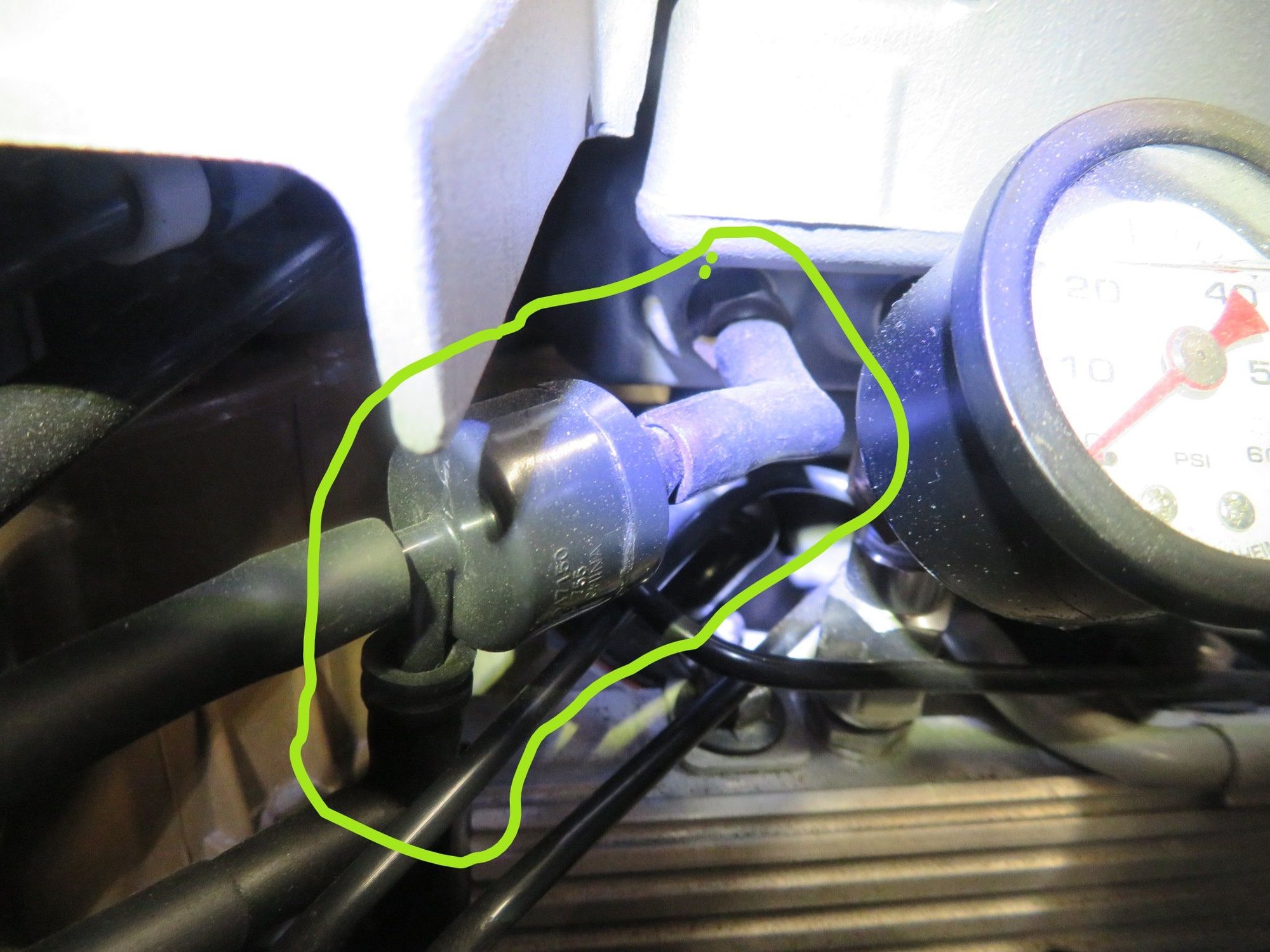

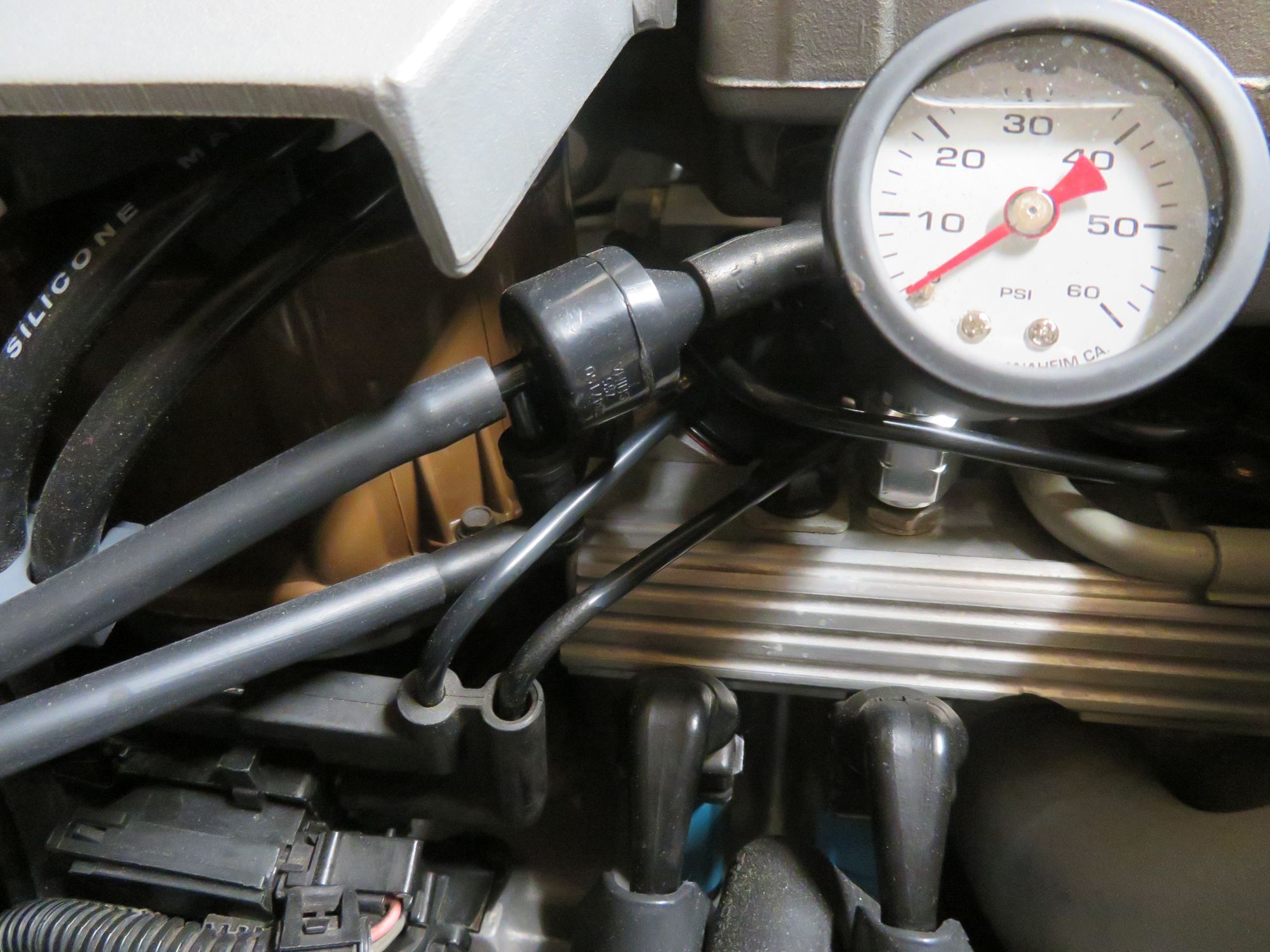

to answer your question on the vacuum leak - depends. you could have a break in the HVAC vacuum circuit that would not affect the engine. it would depend on which side of a check valve a break occurs. check this first -- at the intake plenum there are two ports (right side/rear) - one comes off to a two way check valve. that check valve splits and goes two places - the cruise control servo and to a plastic (nylon/ABS/???) 5/32" tube into a harness, thru the firewall, and to your HVAC panel. check all connections at the plenum first. side question - does your cruise control work? a common issue - the check valves are plastic and break from old age. if you need a replacement - any auto box store - about $7. dorman p/n 47150, (or GM service replacement, p/n 15733271). it's not unusual for the plastic tubing to fracture due to engine heat and old age. if that's the case, just bridge with a section of rubber vacuum hose (5/32"). if everything under the hood looks OK, you may have to start digging into the connections at the HVAC panel.

Hmmm...That check valve is not even there LOL -- and no, the cruise control does not work which may explain it. Where does the hose connect toward the front of the engine if you don't mind me asking?

aft /right side of plenum, two ports, you want the aft port. the forward of the two ports goes to the fuel pressure regulator.
