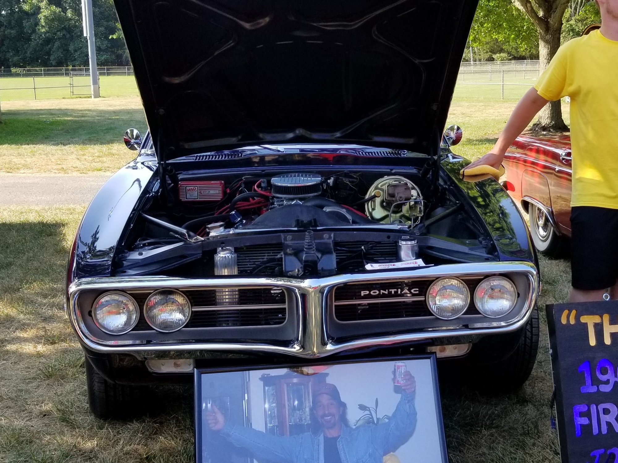

84 4+3's Avatar
84 4+3
Joined: Aug 2017
Posts: 6,943
Likes: 1,490
From: New Jersey
This was like the first thing my uncle my uncle did on his car. That thing used to sit outside with that too and no hood... IIRC the older 6s were fully sealed... sounds more like poor mounting location more than anything imo. Sorry to hear you had problems.
