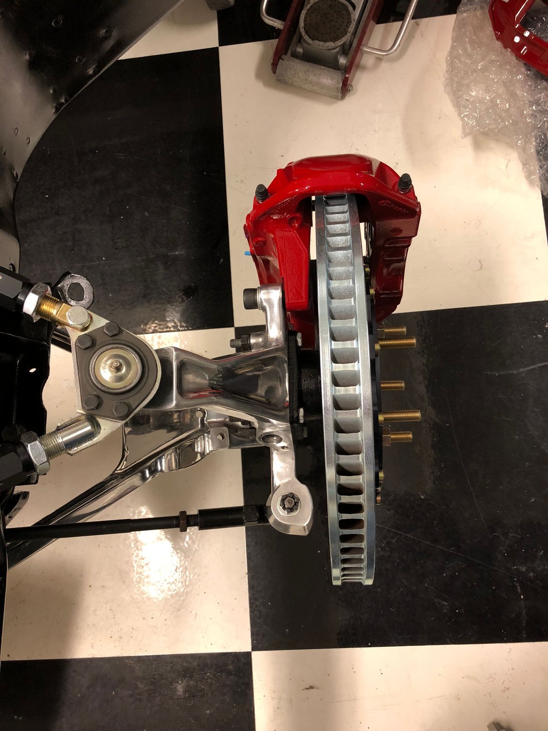

Originally Posted by 76LS1BIRD
The C7 ebrake is different than C6.Just wondering if you ever got the Ebrake to work with the C7 ZR1 calipers.
Also on the front the caliper needs extra machine work before it will bolt to the vansteel adapter.
I think you missed the entire point...
NO ADAPTER NEEDED on the front. None...it only needed a 1/4" spacer to align the caliper with the rotor. Do you see an adapter?

I was referring to the C6 ZR1 caliper with the Van Steel bracket. What did you do about the different size rear Ebrake shoe, in the C7 rear rotor ?
Haven't addressed it yet...the Street Shop Inc. rear adapter will work fine, I think the solution will be having the e-brake shoes relined with thicker material and it'll work fine.
These aren't ZR1 calipers, BTW...they are C7 Z07 calipers (that the C7 ZR1 also used)...a technicality but I try to be as accurate as possible.

Originally Posted by 56chevresto
1991Z07
I specifically joined this website because of just this thread. Curious on any updates
also, you said you did a 1/4 spacer. What did you space out? the rotor or the caliper? I’m actually building a 56 Chevy Restomod with C4 suspension and was gonna do C6 break upgrade but heck, Z06 C7’s way better!
I'm working on carbon-fiber parts for the car right now.
The spacer is between the caliper and the steering knuckle...to push the caliper outboard to center the caliper on the rotor.
