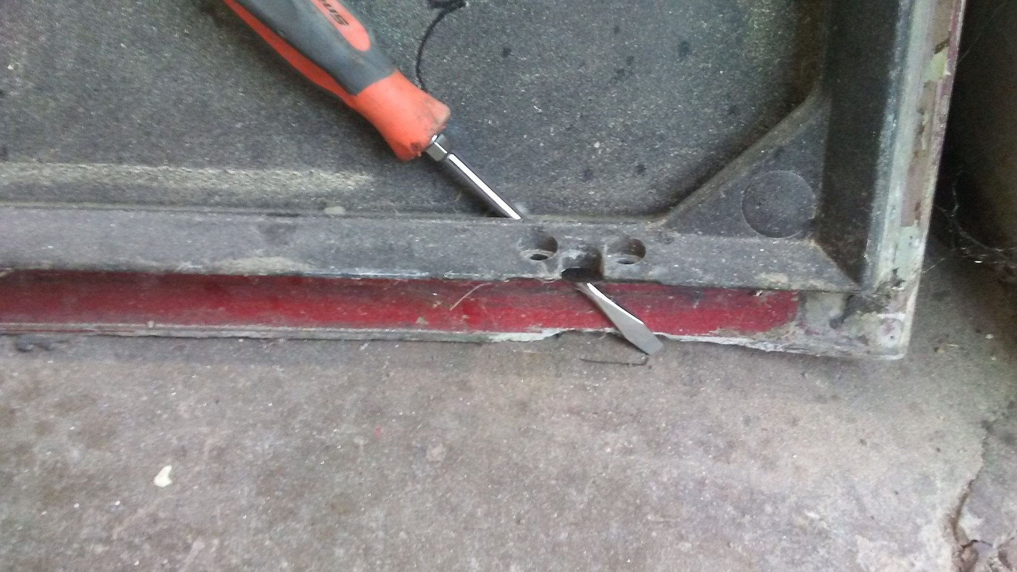

It's odd.. I know the one downstairs (came off an 84, I think?) appears to consist of two major parts.
1) A "frame" which all the attaching hardware goes through. It kinda resembles the "targa truss" some of the guys here have, actually.
I do not see how you could lose that with a single bolt, because it has one at each corner and bolts in quite securely.
2) A roof panel that is bonded to it.. Now that I can totally see losing if the bonding fails. In fact, that's what happened to back of the one I bought. You can literally lift it up about 1/4" off the frame at the rear. One spirited drive without a repair and it is gone!
So, I think you're probably fine if you put all the hardware back in it properly. At that point a failure would be whatever the repair shop used to bond it back together.
I can get pics of it if you want.

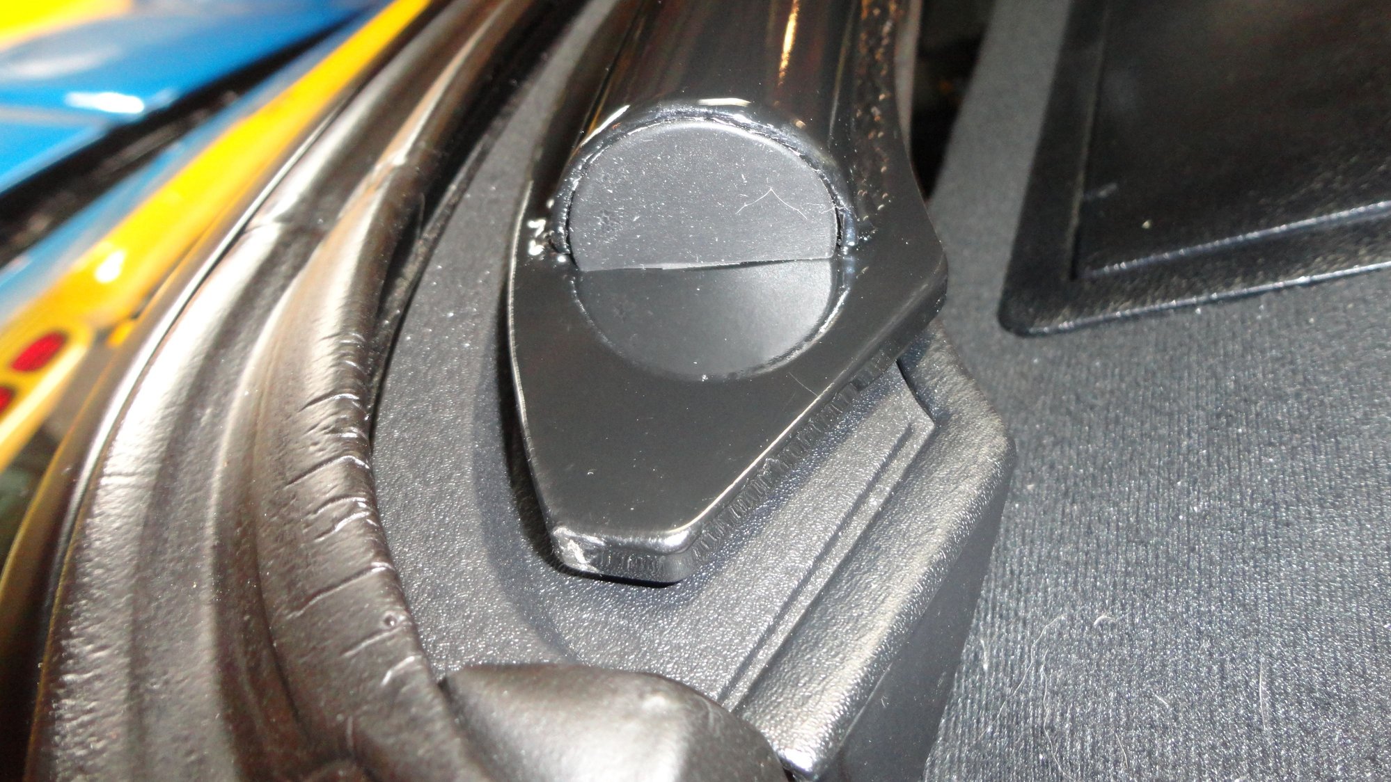

I also find it odd that it would come off with only one bolt missing and a rear at that. Here are some pics of a truss bar same mounts but 91. My guess is it was not secured properly.

The screwdriver passes through the separation between the frame and the roof panel.. You can see where the attaching hardware goes.
So, IOW, if you weren't left with this frame bolted in the car after the roof flew off? The hardware was either loose or worked loose.
Because there's really no other way to lose it..
I would reinstall it and periodically check the hardware to make sure it's snug. A torx screwdriver in the console is a quick way to do this.
Delaminated C4 roof panel
