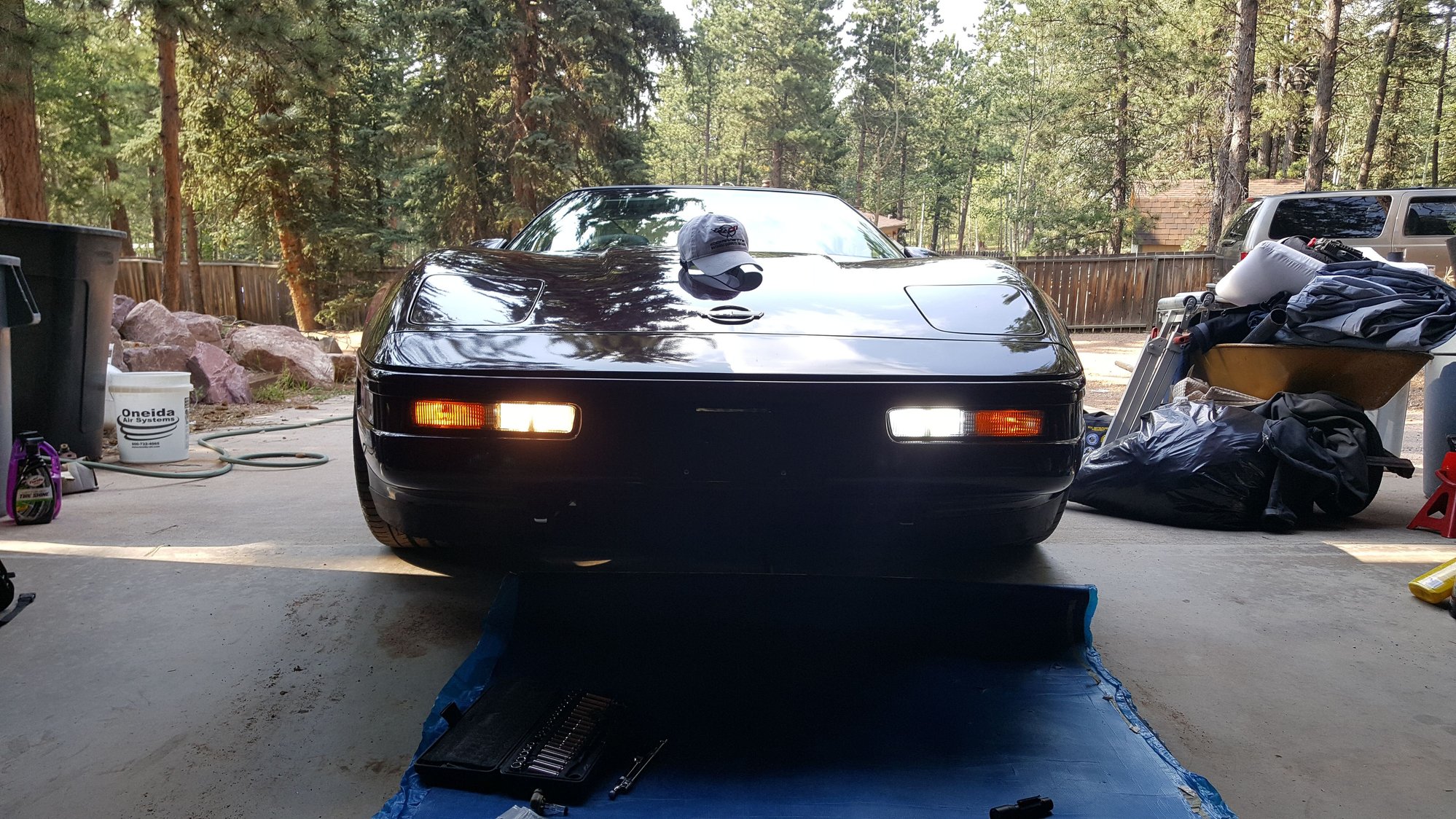

Old Aug 21, 2018 | 07:34 PM
PoprocksC4's Avatar
PoprocksC4
Joined: Aug 2018
Posts: 180
Likes: 20
Default Here's a shot of the front end w/ the mod.
Originally Posted by ihatebarkingdogs
We still don't have the year (looks like 1993), but look at "C". That is the A.I.R. pump relay. I see a small gauge pink wire on it. If the small pink also has a black or white stripe as well, check that it is hot when you want it to be, but it should be hot in RUN, and perhaps in START as well.
THANK YOU \"IHATEBARKINGDOGS"! mission accomplished. Works like a charm. When i turn the key forward the lights come on everytime so i don't have to think about it OR remember to turn them off again. I'm making a you tube video on this mod.
