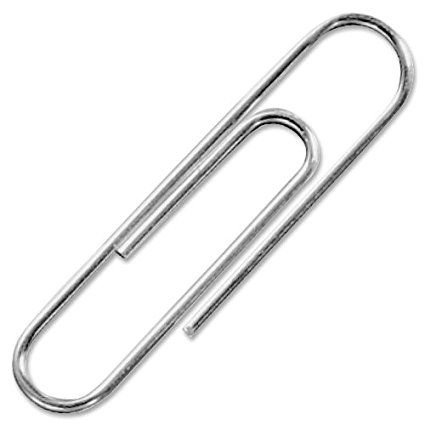

Code Reader
See picture above. Cheap and pretty limited information. Now you can get yourself a scanner and actually get meaningful data someone can help you diagnose stuff with. Not as cheap but you get what you paid for. ALDLScan with the Bluetooth unit from 1320 Electronics should work.

Very likely an EGR code, you need a scanner or the paperclip trick to pull the codes, that should point you to the problem. That would be unrelated to the fuel mileage, which indicates a possible O2 sensor failure. Your highway mileage should be at least in the 23-25 range. When O2s die, they die slow and rarely give off a code until its really bad.
