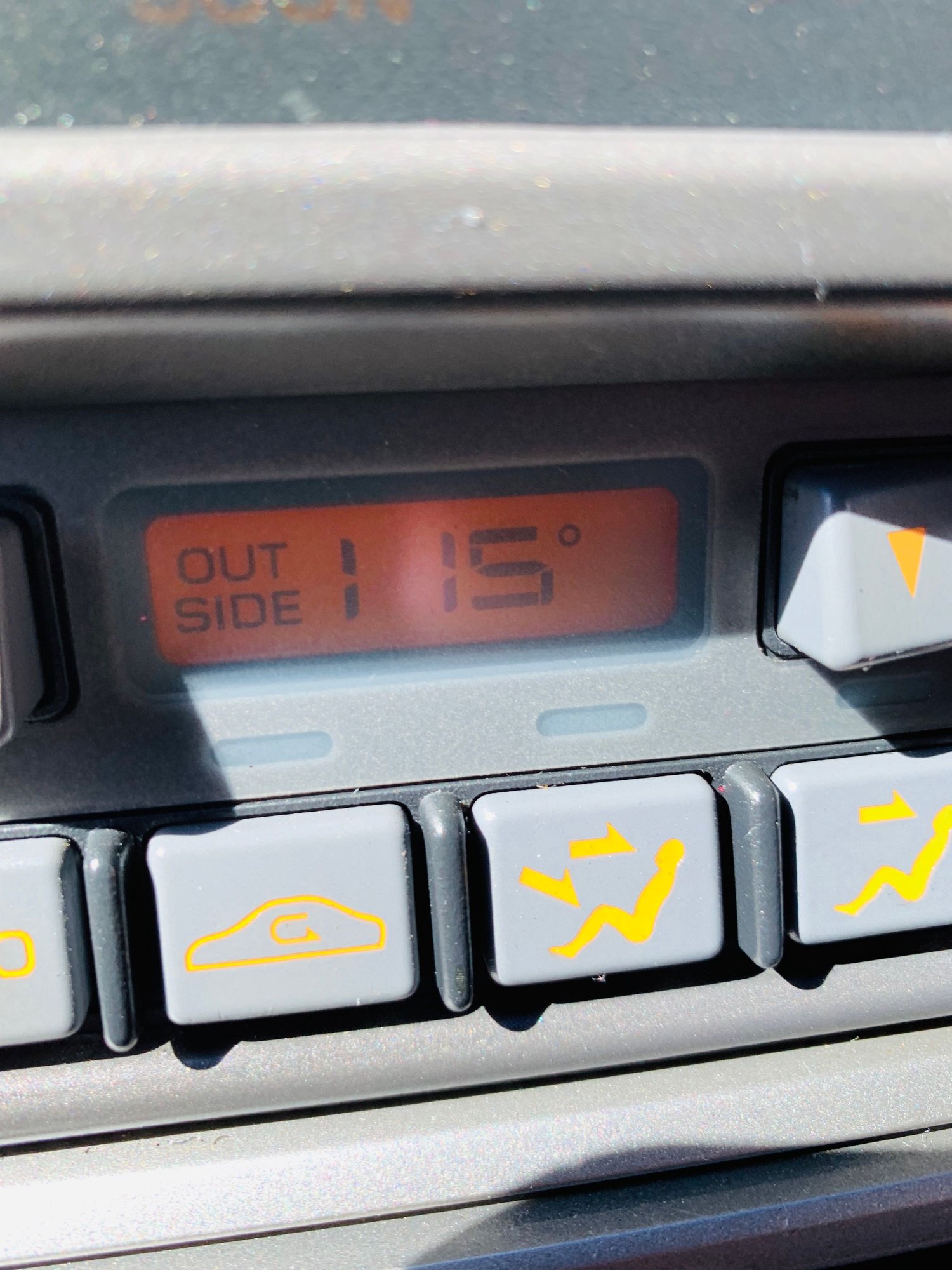

Hey guys
What is the oil temp supposed to run on the 1990?
Old Jun 30, 2019 | 12:24 PM
RWR's Avatar
RWR
Joined: Jan 2009
Posts: 154
Likes: 15
From: Sun City Arizona
Default 1990 Arizona
