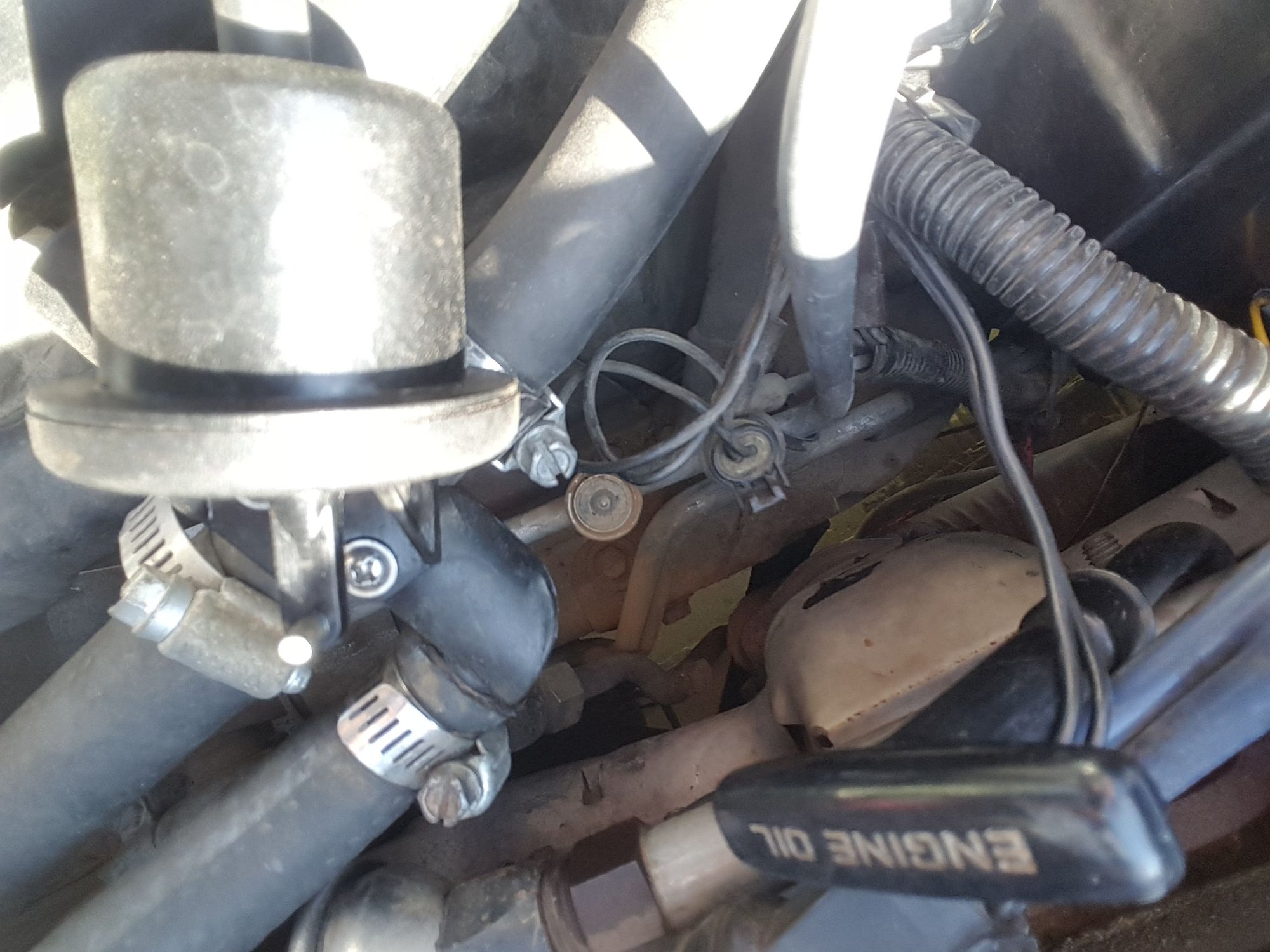

Okay first of all, i recently got an 85 corvette and am trying to find everything problematic so i can get it smogged and found both the aux fan and main fan do not function properly. I know both the fan motors are operational because ive seen them both on before. Upon further inspection i followed the aux fan switch wire down near the starter were it has been cut and connected to some other wire, i also found some thicker wires that have the cores exposed. I tried testing the main fan by unplugging the ac pressure switch, ( i didnt know which one it was so i unplugged both individually at seperate times), neither fans came on. Also near the aux fan relay there is a green w/ white stripe that has been cut and isnt connected to anything, atleast on that end. And lastly i found a melted plug that was dangling on the passenger side of motor but everything seems to be plugged in? Any help is greatly appreciated

Can noone tell me what that plug is for?

Doesn't look like anything on my car except maybe the knock sensor connector?
It's below the exhaust manifold on the side of the block.
Is that it?
Is that it?
i dont think so it only has about 3 inches of wire coming out of the harness but i will double check tomorrow👍

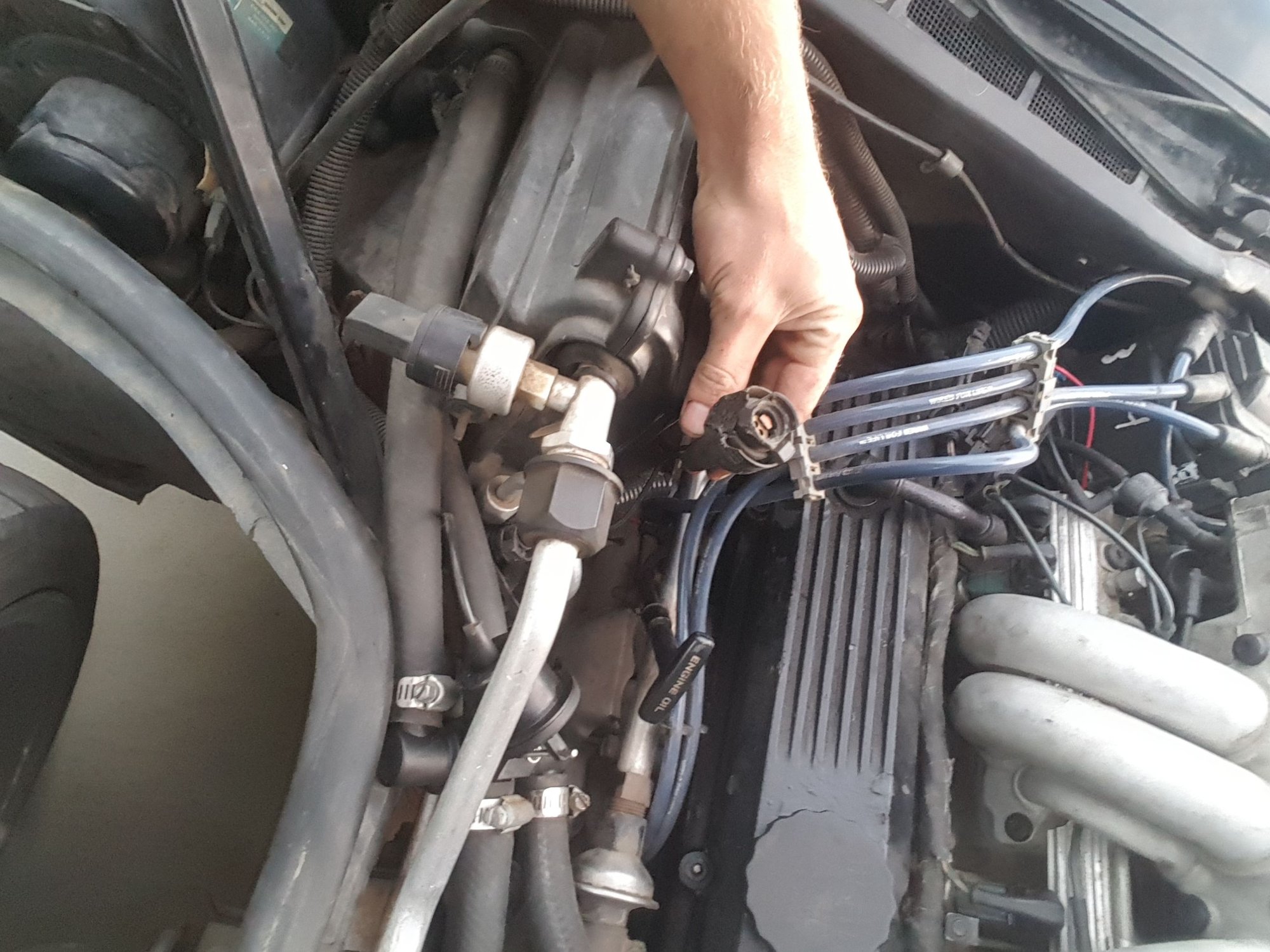

i believe you can see the connector youre referring to on the ac line in the picture
The connector in your picture that's near your evaporator is the low side "pressure cycling switch". The high pressure switch will be on a smaller diameter tube.
would the brass colored attachment to the left of the connected plug be the high pressure switch? The connector that is just danging seems like it would fit on there if it wasnt so melted.

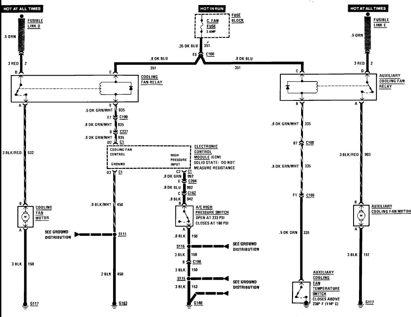

Have you looked at the diagram confab gave you? Look at the a/c high pressure switch.
Maybe I'm confused, but both the plug currently attached to my high pressure line . . . .
What are you calling the "high pressure line"? The larger diameter line that is shown in your photo with the switch with connector attached, is your LOW PRESSURE LINE. The high pressure line will be at the bottom of your evap coil housing. The low pressure line exits the TOP of the evap coil housing. The switch you're looking for will be someplace on that smaller diameter tube that goes to the bottom of your evap coil housing.
