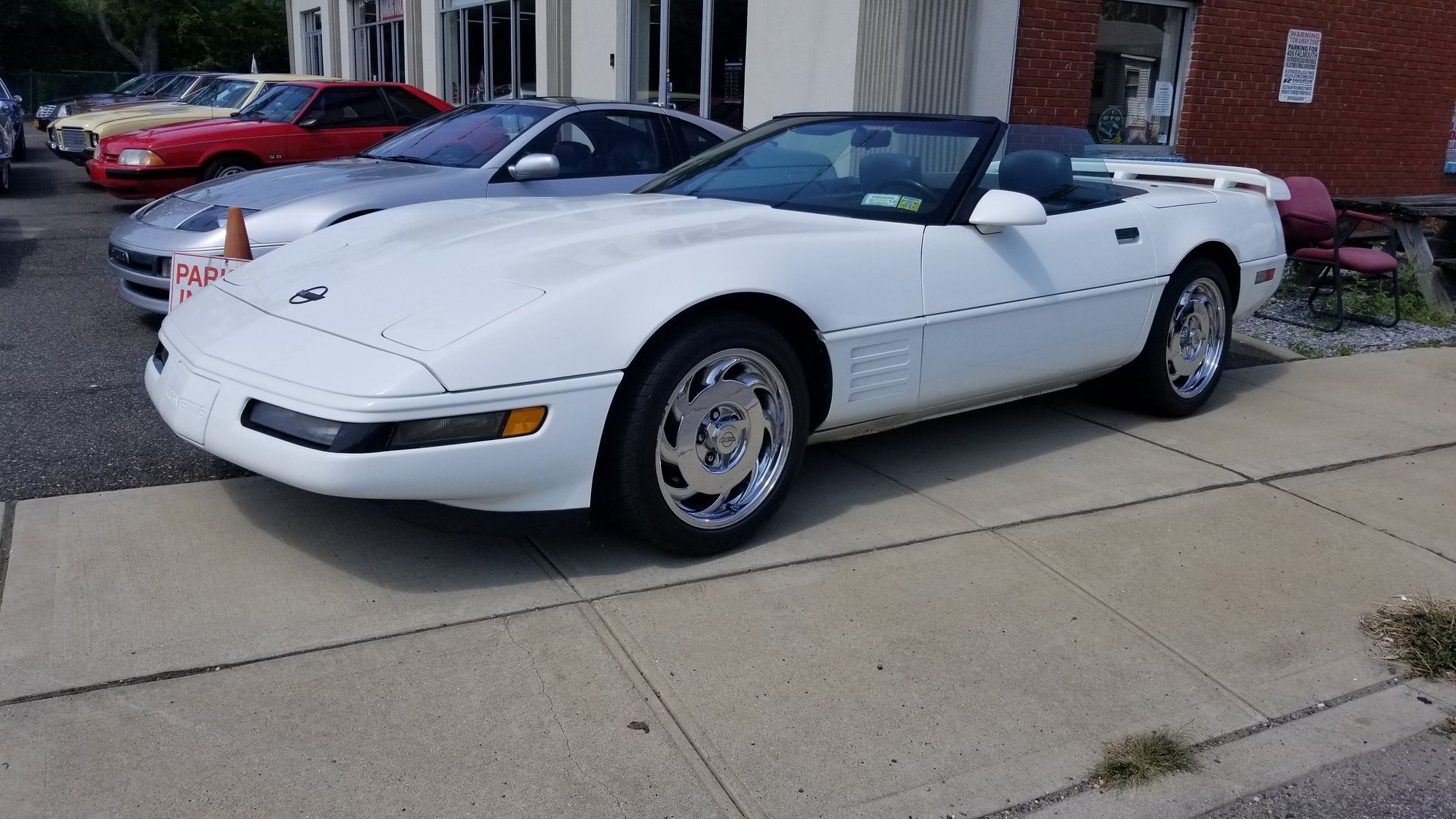

I looking to get a little more out of my 91 Vette. It is bone stock and has 40k on the clock.. Should i eliminate the cats and put on some muffler eliminators ?? Is there any sense in doing the tpi coolant bypass . Please guys im open to some and all suggestion. Does putting some gears in the rear make sense??

What is your goal?
Of course a cleaner exhaust will bring nice HP gains, i.e. no pre-cats, hi-flow/no cat, hi flow cat-back or true duals.
Some simple (~"free") mods will wake her up too:
-cut air intake lid with K&N filter
-160deg F. T-stat
-remove the "frisbee" from the front of the WP pulley.
-bump base timing a point or two.
-increase TPS to ~0.70 Vdc at idle
-remove spare & jack (50 lb loss ~5chp gain)
BTW, fine looking vert...
