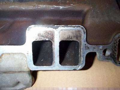

FYI, here's a link to a page with pics showing how much porting can be/needs to be done on the crossfire manifold: http://www.technovelocity.com/chevyh...rt_polish.html
I'll even post a pic or two of the manifold ports (the ends that mate to the head).
Before porting. The FelPro Intake gasket is there to show how much material to remove.
After porting. Note how much larger (taller) the ports are on this manifold.
You might want to buy a spare manifold for this project. You'll be grinding on the thing for a few days. Read the full page there for some tips and some things to watch out for. If you have it sandblasted/media blasted, make sure you take all the shields and other bits off so no sand is trapped within the part to get into the engine.
Also use stones that are specifically for working on aluminum. They don't clog up as badly as "standard" metal grinding stones that are for steel/cast iron.

Holy *****!!! I honestly might just leave it alone after I port that thing. By the looks of that picture, this thing is gonna come right to life once it can breathe. Hey also, should I remove the entire egr channel, and block it off, and if I do will it throw a code?
