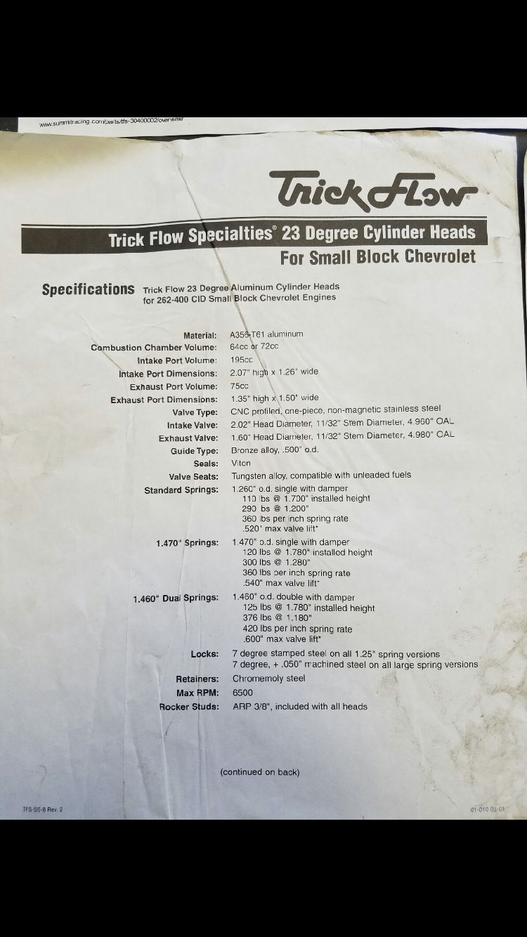

Here's the paperwork for the Heads

Looks like 62 cc? From 76 cc and with no other changes, your current CR is likely too high for a turbo addition. What thickness of head gasket did you use

Intake runner volume: 195cc
Combustion chamber volume 62cc
Exhaust runner volume 75cc

So in other words my compression should spike with these heads.
