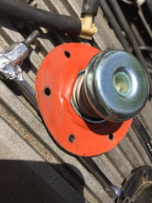

I'm new to corvettes. I picked up my 85 z51 about 2 months ago. The car sat for 15-20 years without moving. I cleaned the fuel tank replaced the fuel level sending unit and housing a well as the pump. After putting in a new battery the car starts and runs but it ran super rich and would not rev above 2.5k. I have done many different parts on many occasions and can't remember what I did on each occasion so I'll lump them into 1. The car has new injectors and fuel regulator and fuel filter. It has a new coolant temp sensor. A 9th injector delete. A smog pump delete. It also has new spark plugs wires and cap and rotor. The car idles but if I ease into the throttle I can get it up to about 2300 but if I go wide open it bogs and sits at 1.5k while doing this there is white smoke and a very strong rich smell. When I tried to pull codes I got a 34. I followed another procedure that said to disconnect the maf and battery for ten second reconnect the battery (leaving maf unplugged) run car at 2.3k for 1 minute (more like 2k for me) re-pull codes. I then get a code 33. Its an 85 so maf sensors run about $150-250. I want to be sure before I spend anymore money. Anyone have any ideas on what I should start with/check? The car only had 35k miles btw if it help narrow anything.

I pulled the cat off and it ran a million times better. It has plenty of power and can rev to near redline but only for a few minutes before it goes back to the way it was before bogging down when put into gear and not being able to go uphill or give more than 15% throttle before it bogs and dies.

I figured while is was all pulled apart i would install new headers (hedman longtubes) and do an egr delete. I also replaced the apparently stuck pcv valve ill updated either later this weekend or next weekend.
