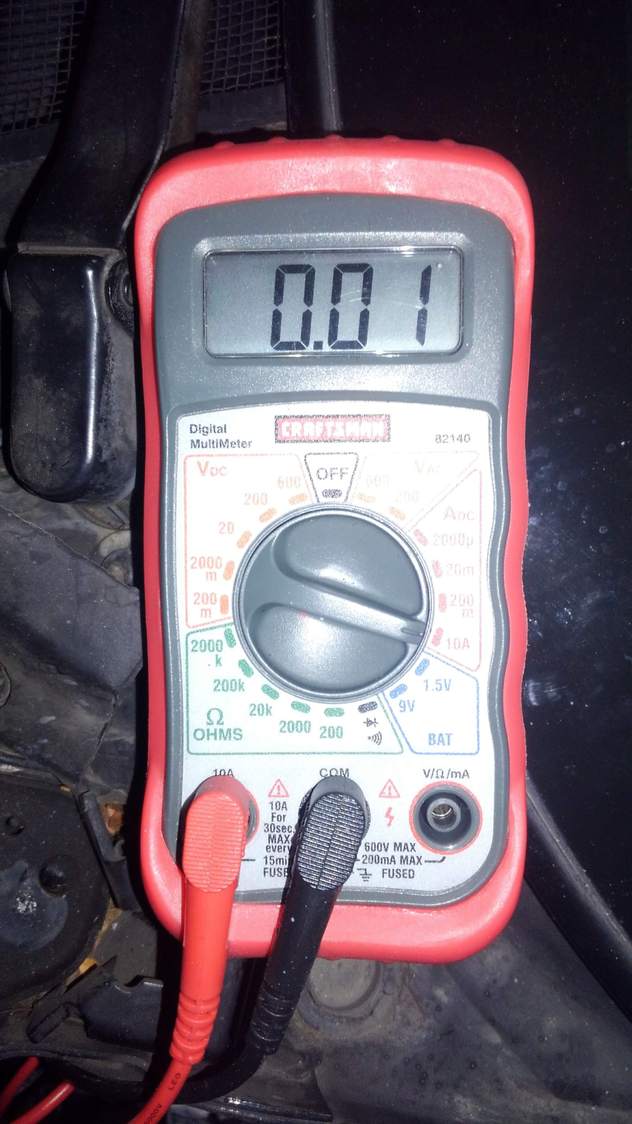

Originally Posted by xFaKx
After trying it PatternDayTrader's way it now sits at 0.01, So i dunno if that did something or what. Seems a bit low? It does jump up when i open the door and lights turn on so i now the current is there.
That is suspiciously low for a 95 model year car. It makes me think something has gone wrong executing the test procedure.
You should be somewhere around the 30 to 40 milliamp range after everything has timed out.
Even Hot Rod Roys 84 model year car is 13 milliamps and I know for sure he is measuring his properly. You are coming in at 10, which is lower than his car.
Im not trying to sound condescending in any way here, I just know the parasitic draw rabbit hole goes so deep, you will never get to the bottom of it unless the test procedure is done exactly right.

Maybe something weird about the scale on your meter ?
Take a picture of your meter if you want and post it …

That is 10 mA, but since that is the least significant digit it could be as high as 20 mA, still good.

Ya im sure its not the most accurate multi meter

You could try the 250 mA scale, but be careful as too much current will toast the internal resistor. It will give better resolution of the true amount of current if it matters.

Yeah I cant believe that doesn't say .03 or .04
But there it is …
I guess at least it doesn't say .1 lol …

I re ran the test both ways and they come out the same. maybe all that on of on off stuff triggered or loosened something? Im going to just leave it sit a few days all hooked up and see what happens. Thanks for the help i will replay back soon.

One of the neat things about this Forum is that there are so many people willing to help! One of the unfortunate things about this Forum is that there are so many people trying to help! The problem any OP has, is to figure out the difference between those two statements! I haven't figured out how to stay out of trouble if I enter into the controversy. Here's a few observations:
1. That Craftsman multi meter is a very good meter, when used correctly.
2. You can't accurately measure 10 mA on the 10 A scale. That's the absolute bottom of the range on 10A.
3. The Harbor Freight "Fuse Circuit Tester" has the same limitation. It's just a multi meter with no selector ****. This tester has a minimum reading of 0.1A (100 mA) so it's useless for this application.
4. When you disconnect, and then re-connect anything during the testing, the interior lamp delay circuit will reset, and start the whole process over again!
