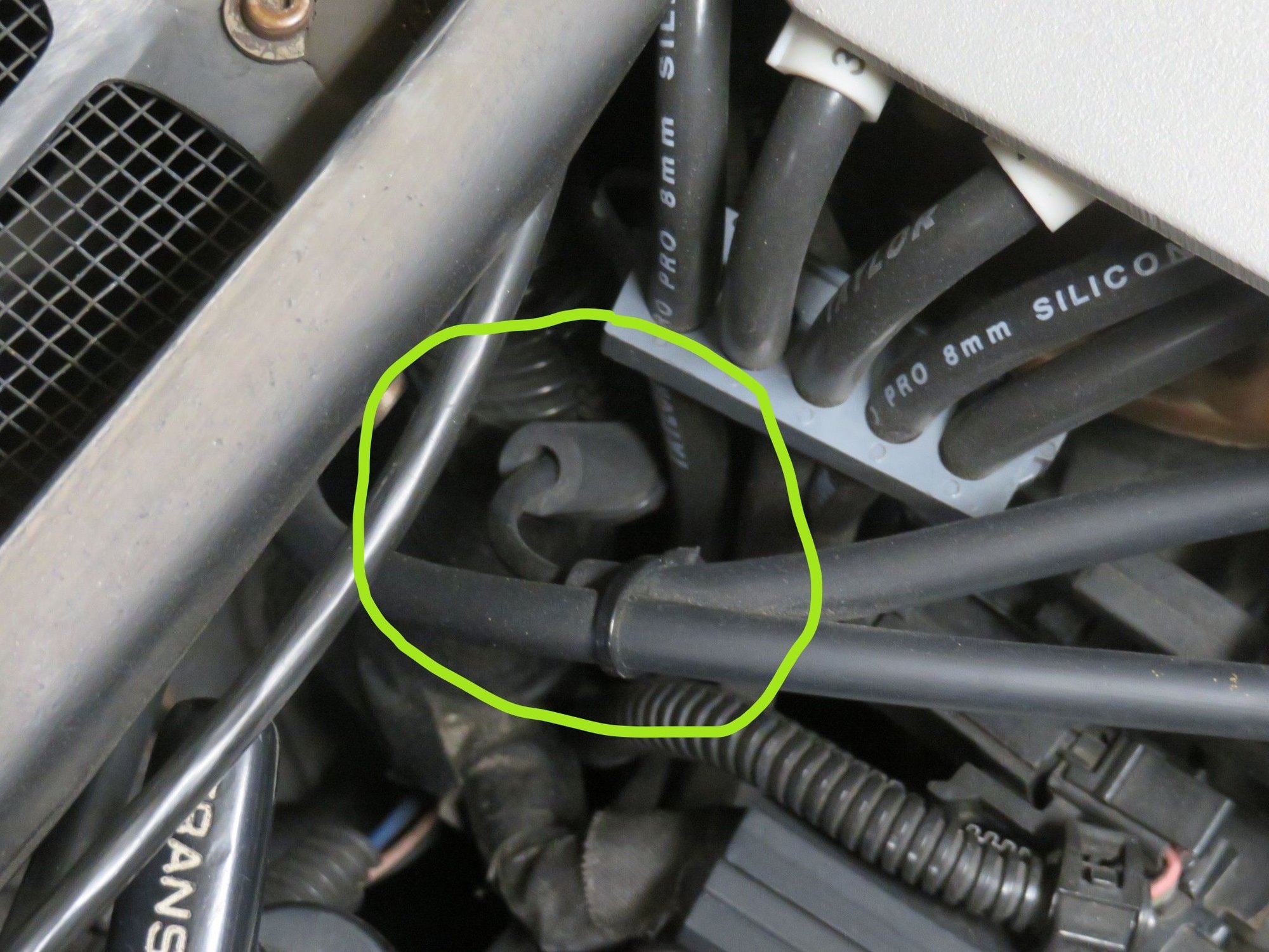

I'm curious if there's anything that can be done to maintain my vacuum lines and keep them from cracking. They're getting a bit brittle with age and I don't really want to have to replace them.

Silicone oil on them will make them last twice or three times as long as normal. I oil down the entire line outside and then both ends are soaked as well. I have been doing this on both of my Corvettes, it helps since my C3 has like 75' of vacuum lines in it and this way they look as new as the day I installed them in 1993. You want to be careful choosing a material to coat them with, certain petroleum based materials will make them break down even faster. Do Not use Petroleum Jelly or anything like that as it affects the life of the part and destroys rubber slowly. Even coating them with Armour All will work for a while but not last like the silicone does. I would imagine some of the tire shine products might even work as they are designed to last a while.
A friend who works for Xerox gave me a bottle like thirty five years ago and I still have some. I understand that Home Depot carries the silicone oil if you can't find it easily.

Originally Posted by ctmccloskey
Greetings again Bfenty!
I wish you and your family a very Merry Christmas!
Chris
How do you apply it over the parts that aren't easily accessible? I add tire shine often to my engine bay to keep it clean looking but that's the visible stuff

I apply it using a small rag that I wet with the oil and then I just coat the outside of the lines with the wet rag. You can usually reach every where but for those hard to reach vacuum lines I use a pair of 12" extended needle-nose pliers that hold the rag for me. If I have to I just spray the stuff onto the tubing if it is buried under the hood. The tire shine will work fine for most vacuum lines as well, spray it on let it sit for a minute and wipe off the excess. The tire shine works like silicone oil but does not last as long. Does it attract and hold dust under the hood?
Now I understand why your engine is so pretty... A little cleaning now and then makes for a very nice engine compartment. I have seen engines on this forum that look better than they did when they were made! With the engine sitting there when the hood is up sure makes it easier to clean and work on. I love the C4 models, I wish the newer cars let you have access to the engine like the C4's did, it would sure make owning one less expensive.
Good Luck!
P.S. The die-electric grease works great as well, if you have some feel free to use it, my only problem is that it holds dust and dirt to the grease if it is too thick, use sparingly but get good coverage if using Die-electric Grease!

Dielectric grease is silicone grease. Use it on rubber but keep it far away from any sensors.

OK, why don't you want to replace it? all of it is around 30 years old, and time is taking it's toll. I replaced all my vacuum, fuel emissions, and even the windshield wiper fluid tubing a couple years ago - well worth the effort. don't do a band-aid fix for something this simple. too much of the car's operation and performance depends on a good, leak free, vacuum system. just my 2-cents -
How much of a job is that? How expensive is it to replace? I'd be interested in doing that for sure but I don't want to year the whole dash panel apart to get to all of it.
to correct my previous post, "all tubing under the hood, and one line to the brake switch." never had my dash apart. can't recall how long it took - did it a couple years ago. i was in the middle of a minor mechanical restoration of my 85, and it was included within a bunch of other tasks. overall, i spent about (part time) 18 months - bumper to bumper and that included a valve job. cost for vacuum lines - not much. seems 90% of the lines are 5/32" tubing. i bought a 50 foot roll (gates vacuum) on fleabay - seems it was around $20 - used about 1/2 the roll. (fuel/oil resistant) fuel and emissions, by the foot (at NAPA). windshield wiper lines - 5/32" from the 50' roll. other sizes were purchased in 10 ft lengths - i'm thinking about $5 each. you shouldn't have to take the dash apart. the only significant piece is the cruise control line to the brake switch, and that can be optional. you don't have to do it all at one time - break it down to individual pieces, and replace one section at a time. remove one piece, measure, cut, and replace - plug and play. if it takes several days or weeks - so be it. the nice thing is the car won't be in-op for any length of time while you're doing this. you can do one or two pieces at a time, and still drive the car. i would say, you could knock it out in a weekend without much effort.
https://www.ebay.com/itm/Gates-Vacuum-Tubing-Non-Reinforced-27042-5-32-X-50-ONE-PER-PKG-27042/132600835354?epid=1523082811&hash=item1e dfa02d1a:g:MDwAAOSw9DJa465E:rk:11:pf:0
most of my rubber deterioration was around charcoal canister vacuum control lines, purge, and fuel emission system. my engine vacuum lines were a bunch of band aid fixes from over the years. everything under the hood is configured as new, and hopefully, will last for years.
