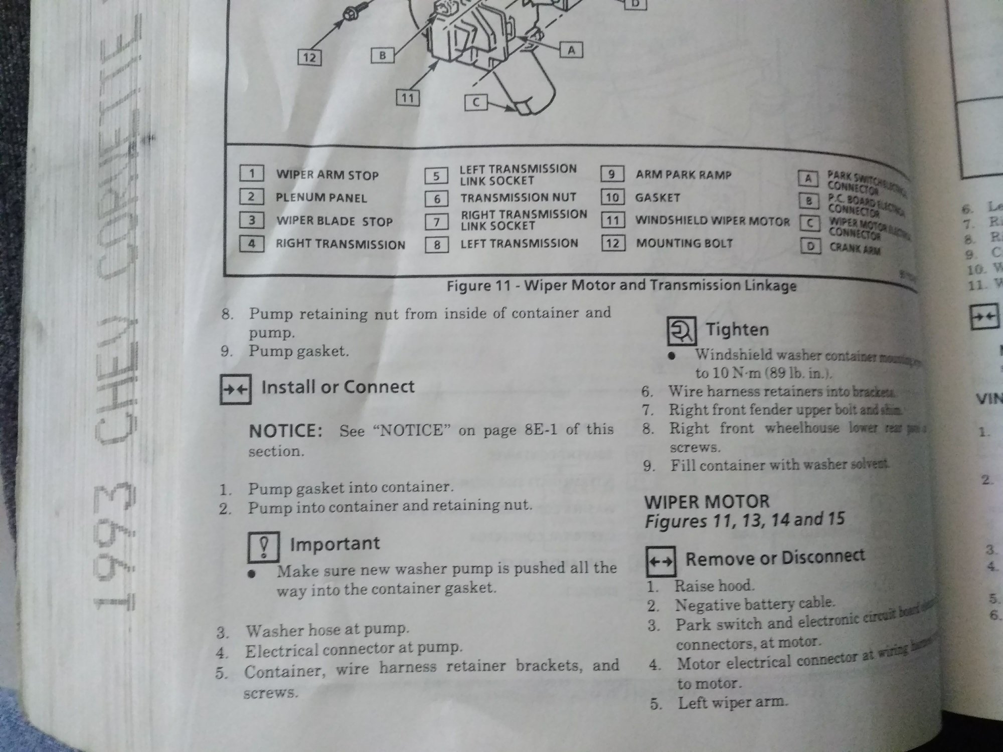

Does anybody know how to remove the washer pump? HELP!

to give yourself some room take off Rt. Front wheel, remove inner fender well. To remove the pump you will need about 15" of 3/8 socket extentions and a deep socket in the area of 7/8. Remove the strainer basket (if you're car still has it) in the bottom of the washer there is plastic nut with a strainer remove it with deep socket. Pump will drop out by wheel well.
. After looking at a replacement part online , it appears that a design change may have happened may have happened to later modles, the steps are much the same except that the pump is now Grommet mounted
