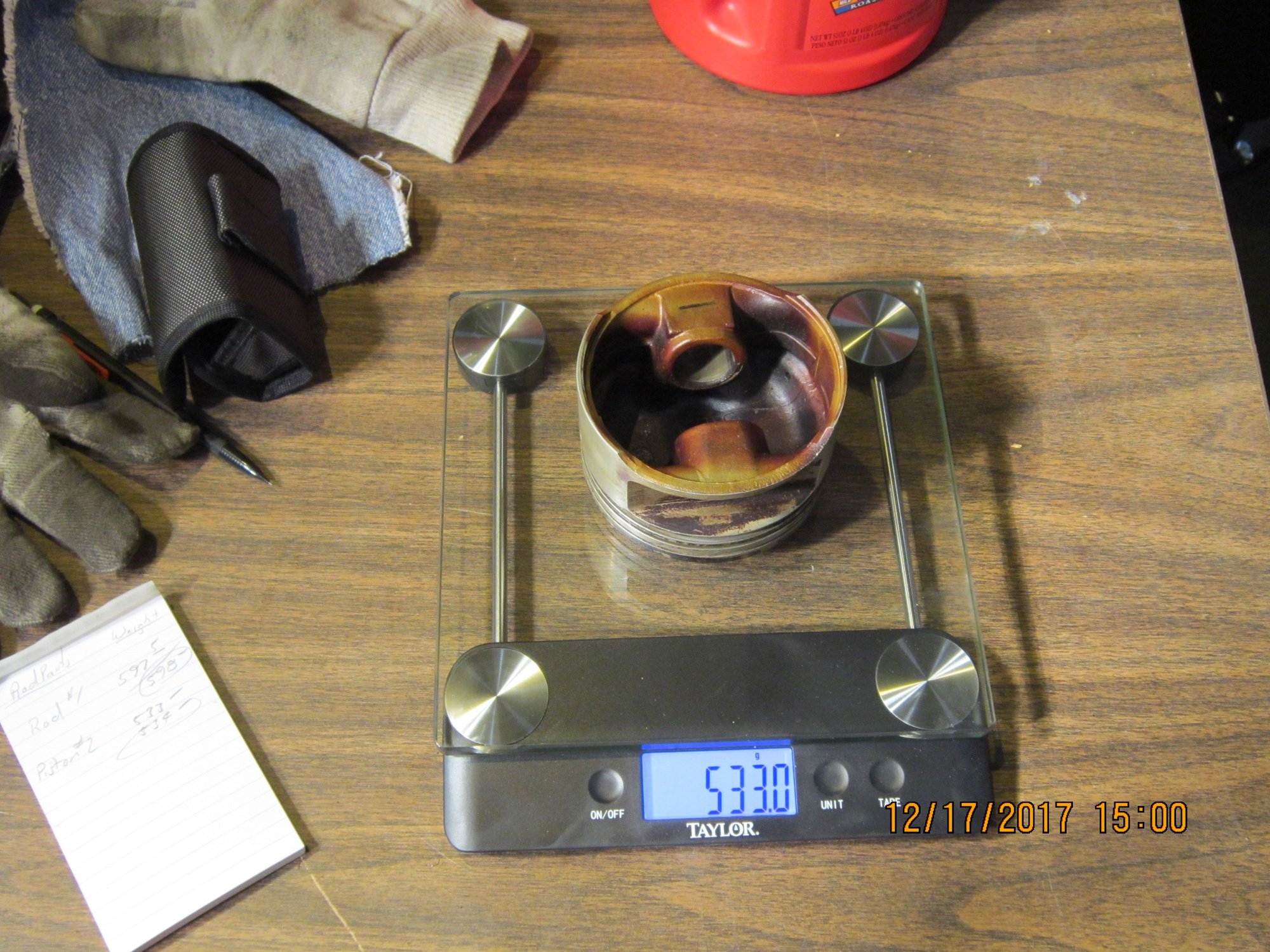

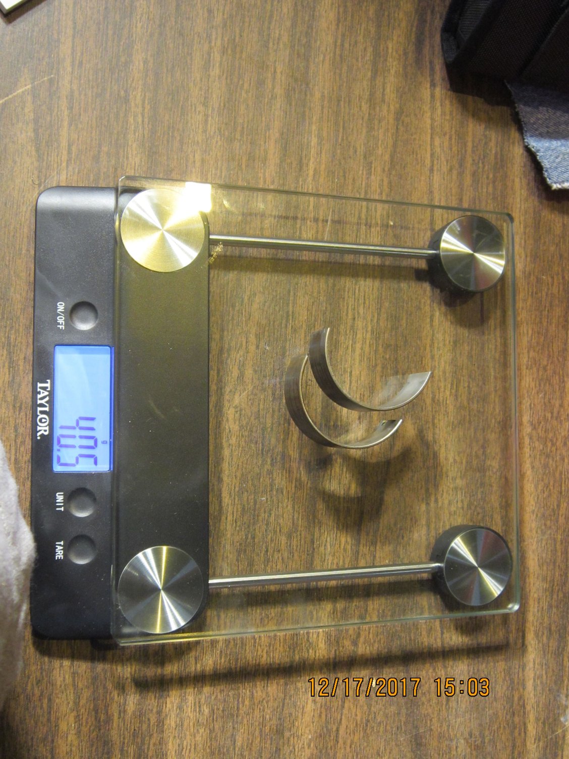

Out my '94 Z28 I have the measurements and will attach some pix. But my LT1 didn't have the powdered metal rods, instead it had the regular forged rods which I think were called "pink rods" so rod weights may be different - but not the piston weight.
Rod weight (#1) = 598g, Piston weight (#1) = 533g, Piston Pin (#1) = 143g, Rings (#1) = 44g, Bearing (#1) = 41.5g
Total weight (#1) = 1359g/1360g
Hope this can help.
Hope this can help.
Thank you sooo much! I really appreciate it!
