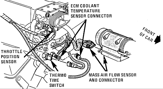

I have a 1987 corvette and cant identify the sensor that is to the left of the coolant temp sensor here in the photo. This is located in the front of the Intake Manifold. Can anyone help?

[img]blob:https://www.corvetteforum.com/4b93aad8-3397-4fe7-810a-a43c8e48794a[/img]
not sure but I believe it is the thermo time switch for the fuel injection

I've been told there are 2 sensors for coolant temp, one reports to the ecm and the other is for the dash gauge. Don't take my word for it, I'm sure someone with better knowledge will come along soon.

You are correct on the two temperature sensors for the coolant. One is for the gauge and the other is for the ECM. I have an 1988 C4 like that. The second sensor is a one wire sensor mounted in between cylinders #1 and #3 and has a green wire going to it.

Thanks for the drawing. Thermo time switch sounds good to me. I finally got the coolant switches figured out. The one for the Aux fan is between plugs 1 and 2.
the sender for the dash is between plugs 6 and eight. Never did find the primary fan switch. It must be only controlled by the ECM I'm guessing!

Just to clear up something here, the spark plug #1 is on the drivers side nearest the front of the engine. Cylinders 1,3,5 and 7 are on the drivers side, 2,4,6 and 8 are on the passenger side of the engine.
You are correct in assuming that the fans are indeed controlled by the ECM via a relay. When an ECM fails (dead) the cooling fans all come on when the key is turned to run.
