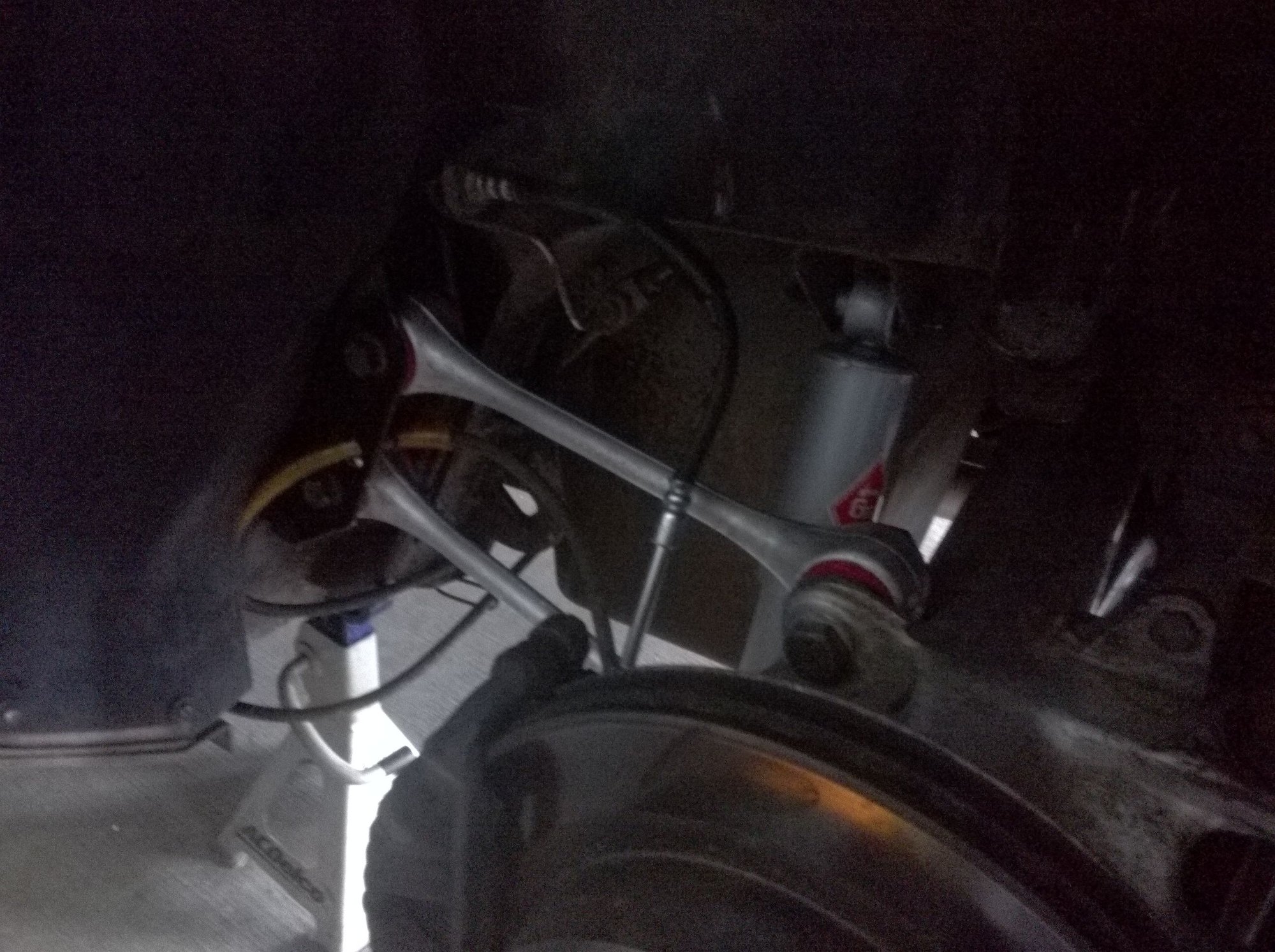

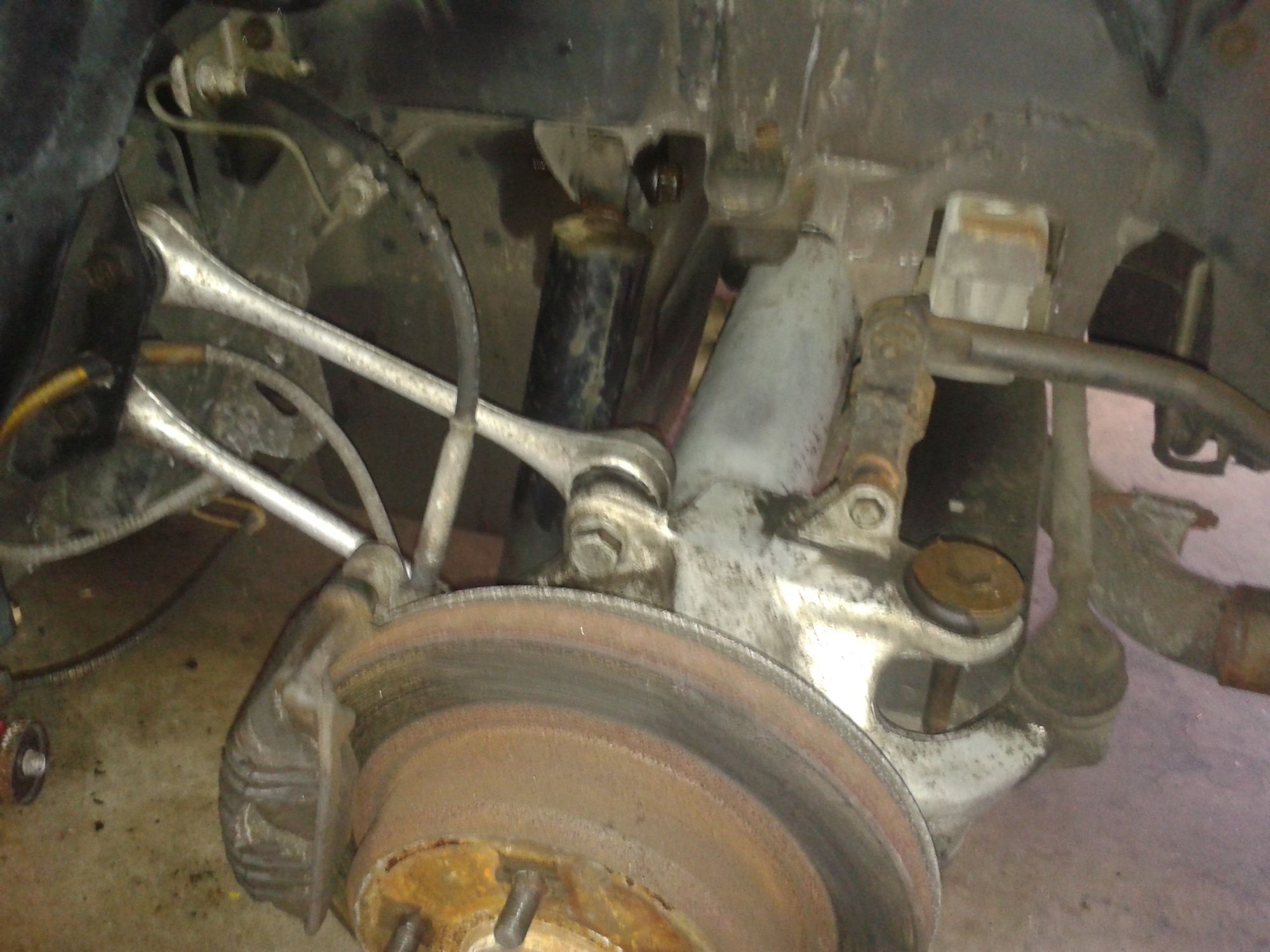

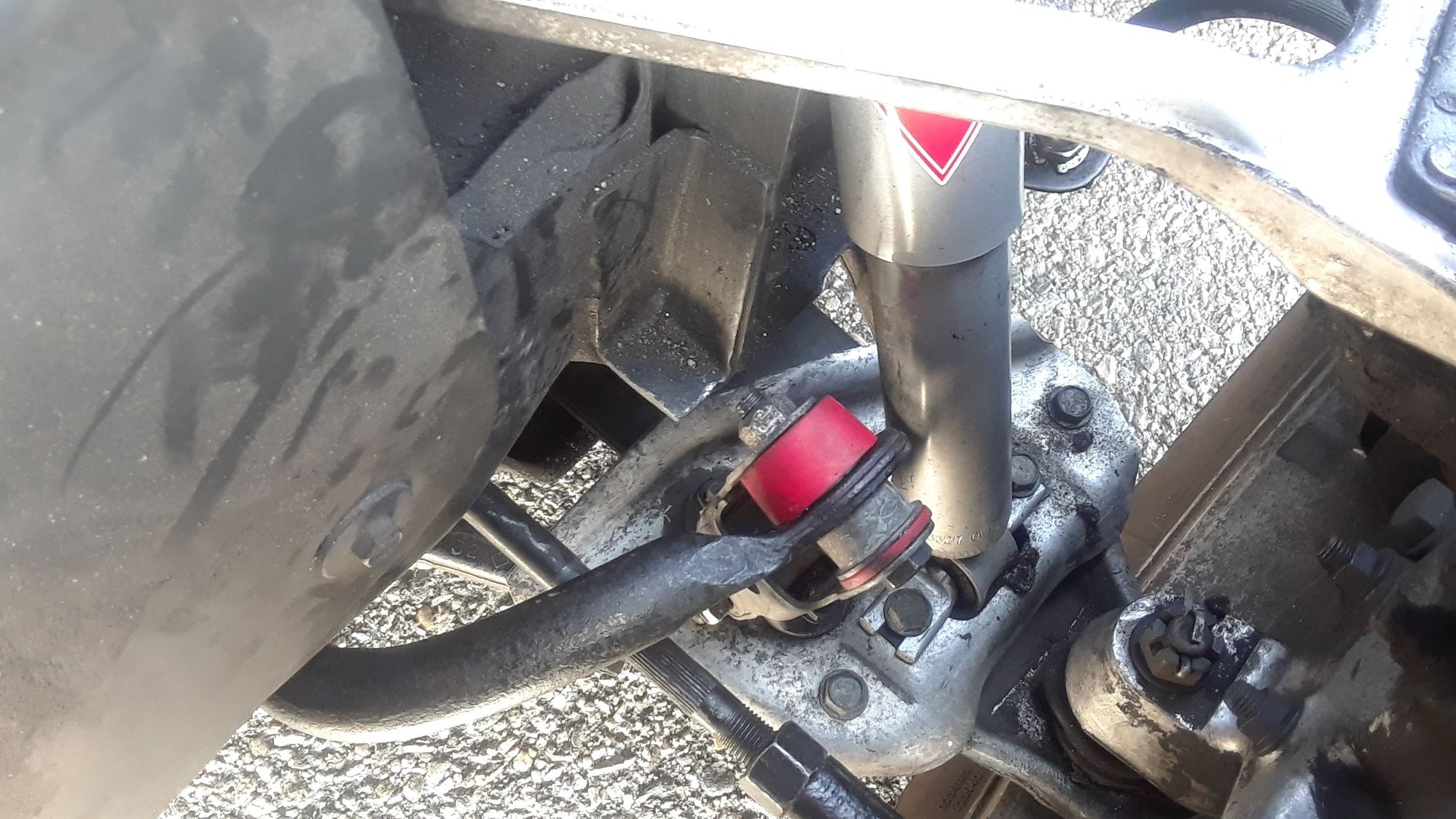

I replaced all of my bushings by drilling and/or pressing them out with a c clamp. Must be carefull you don't drill the aluminum. Here are a couple pics, and I would try to do as many as possible then do an alignment.
I did 2 alignments by the time I was done. Some like the sway bar bushings(Large ones not the side ones) were fine so I left them.
Sometimes you have to take it apart to see the wear, Good Luck and use a new bit.
Also these work great for the front, once again the large ones under were fine
