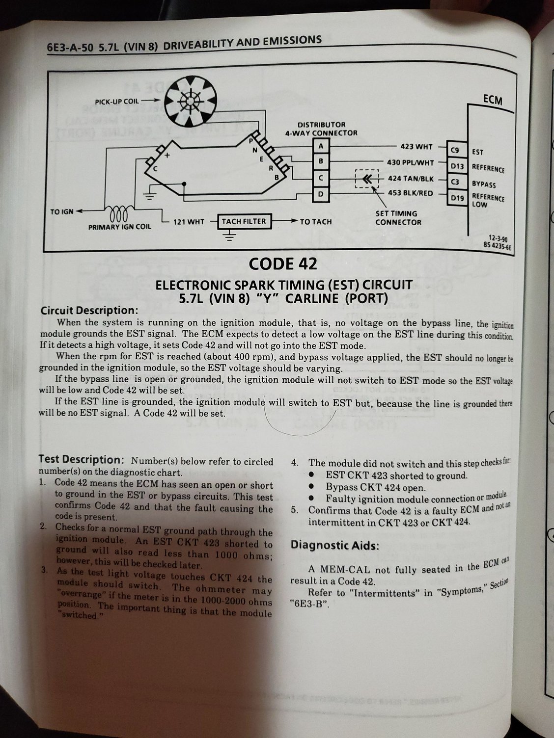

Hi guys...helping a friend with his 91 L98, setting codes 42 & 53 in mod 4. He doesn't have a FSM and of course my 93 FSM is of no use. Does anyone have the code chart from the Driveabilty and Emisions section 6E3, in the FSM for the 91? Thanks

Thank You, just what I was looking for!

Could you please re scan last page, out of focus?
Thanks
Old Mar 10, 2019 | 02:07 PM
aklim's Avatar
aklim
Joined: Jul 2004
Posts: 28,473
Likes: 3,291
From: Hartford WI
Let me know if this works

More better! Thank You sir
