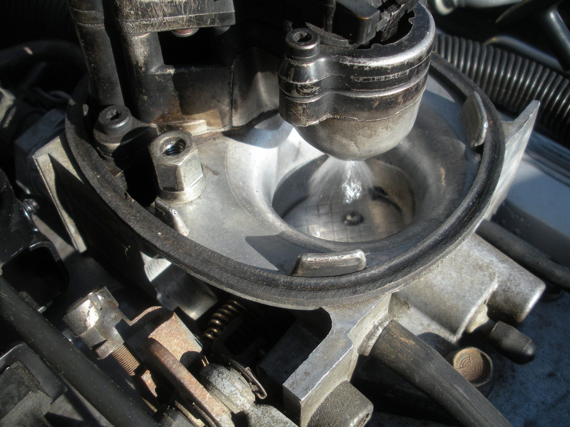

One of the neat features of the '84 CFI is the ease of checking the fuel injectors! Remove the top of your air filter, and watch for a nice smooth cone of fuel spray. Point your ignition timing light at the spray to see the injectors pulse! Our TPI friends are jealous!
