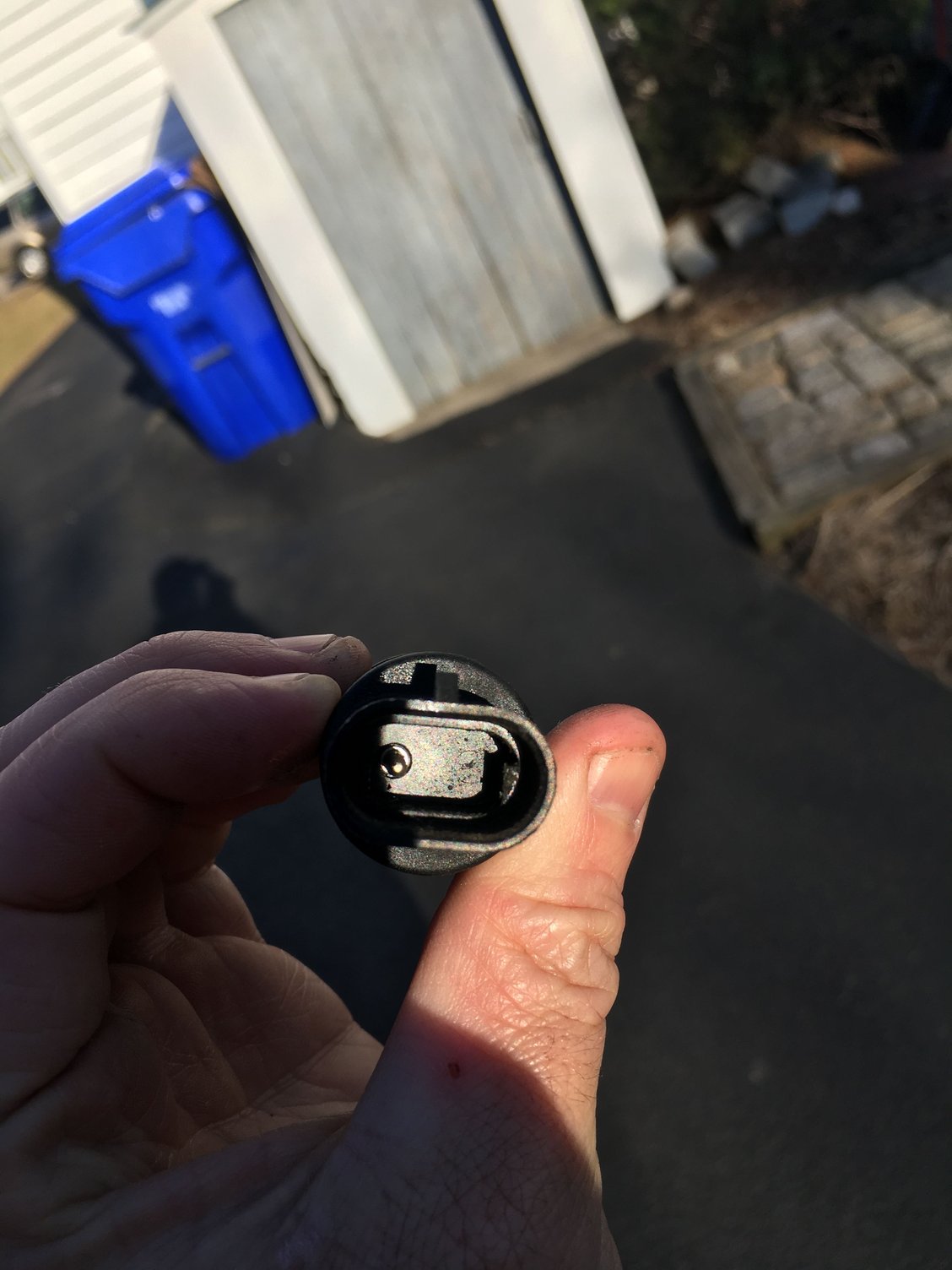

All,
no clue what this sensor is. Found it under the car when I backed it out of the garage. It was under the radiator / condenser area.
There has been a small puddle of coolant that I’ve been waiting for warmer weather to figure out.
See pics. One wire sensor connector.
Im at a complete loss...maybe a low coolant sensor???
thanks
mike

Looks like a broken coolant level sensor to me.

Where is that located on the car?
Under the surge tank? Or up by the rad / overflow tank

The coolant level sensor is located in the bottom of the tank.
