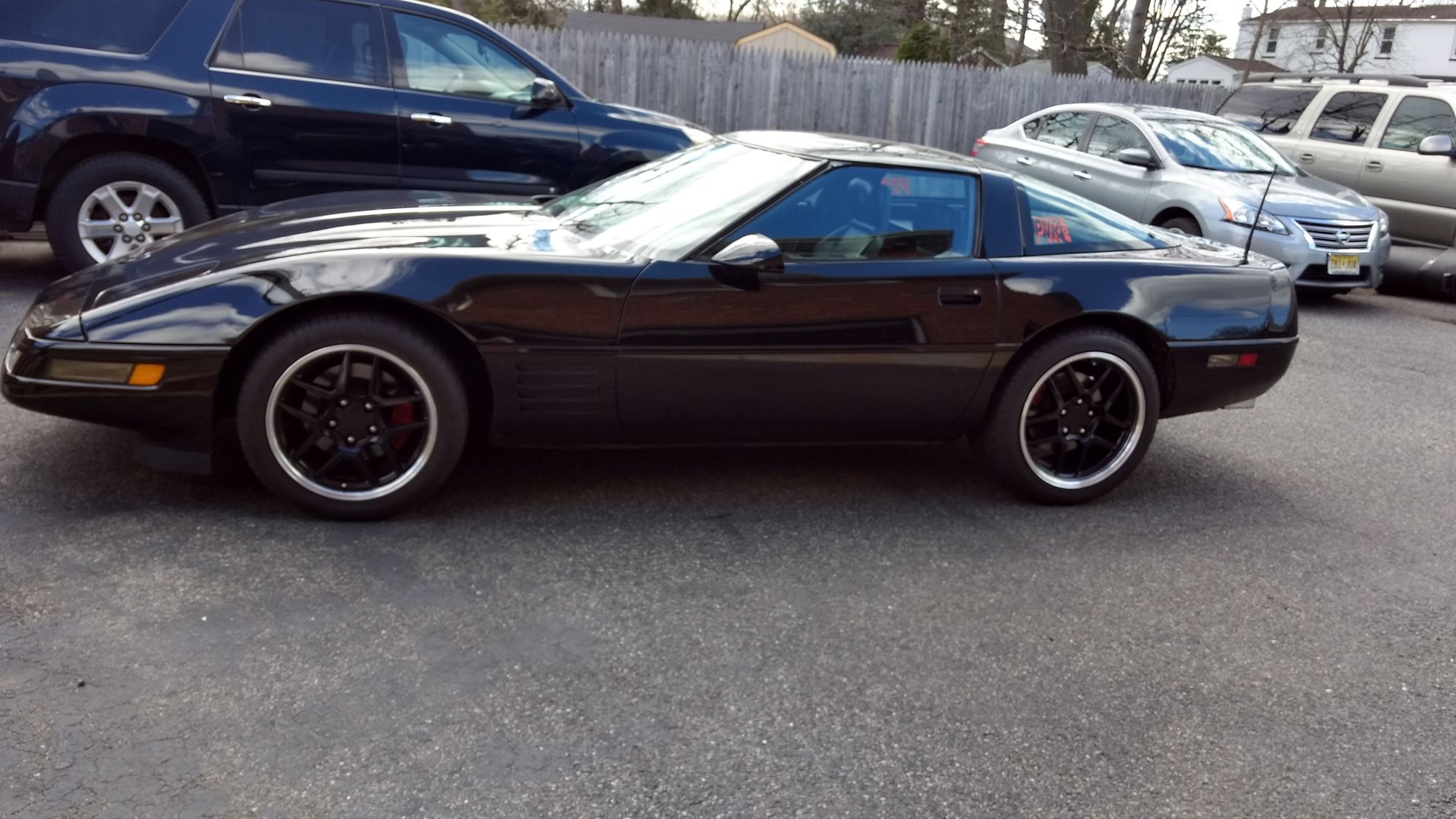

what kind, size and cost are those wheels on that car? like to see them on a page.

That is Truly One Beautiful Corvette that you have there!
Oxygen Sensors used to be very easy to damage when first came out. I was told that every 50 k miles you replace all of your 02 sensors. O2 sensors are expensive today but what isn't?

https://www.oewheelsllc.com/Corvette-Z06-Wheels-Black

Thanks I appreciate the compliment. came a long way from when I got it. new 02's weren't bad $32 for the pair of AC Delco. cars a 93 OBD1 so they are just the old one wire 02's. here is a better clearer picture.

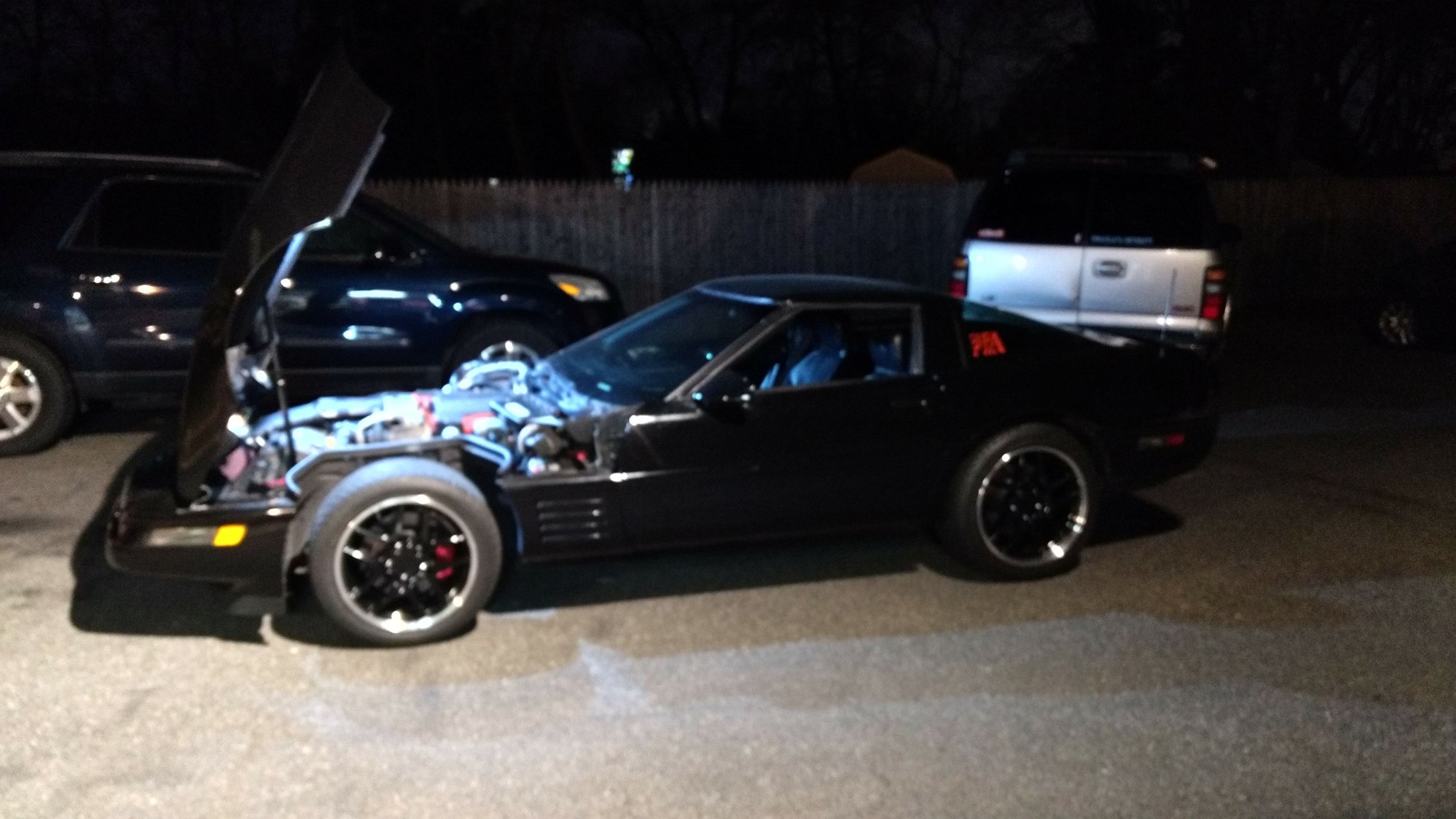

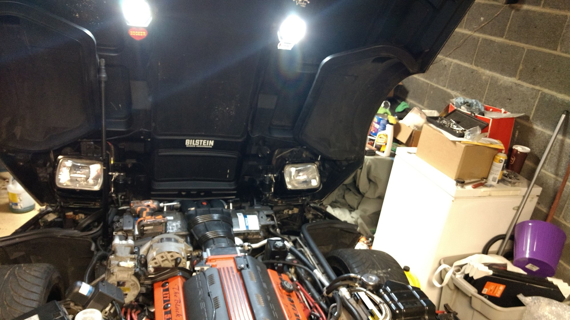

Did you install LED lights in the engine bay? I have mine disconnected as I don't want to drain the battery with frequent/long hood up periods, but those look super bright!

Yes eventually I do want to ad a switch to turn them off for the same reason you mentioned. Corvette Central sells a plug and play switch for $50 but easy enough to just do myself. the lights are very bright.

BTW, that under-hood lights on/off switch is great; I have one installed on each Vette.

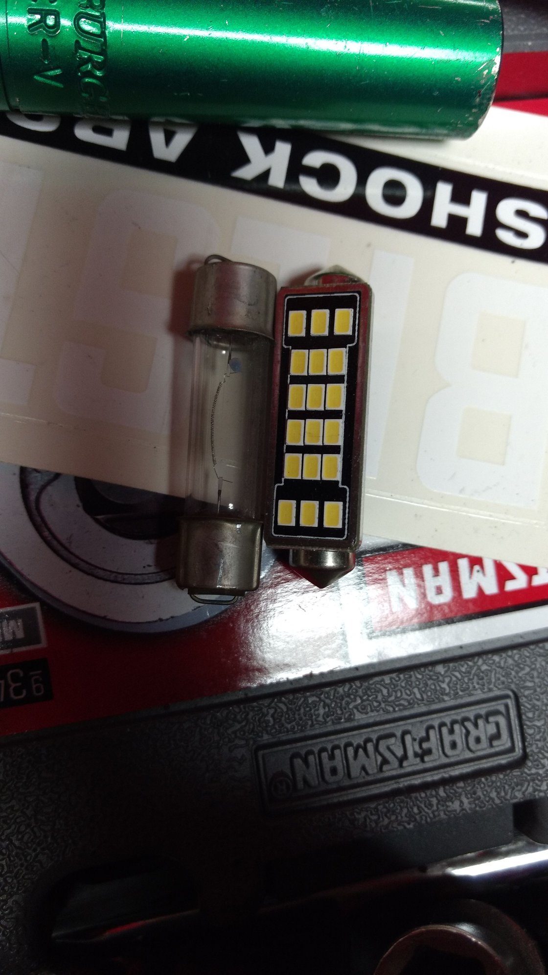

I went to Pep boys and bought the LED bulbs for my 1988 C4, it sure does reduce the load on your electrical system using all L.E.D.'s. The LED's use a fraction of power when on that the original bulbs did.
