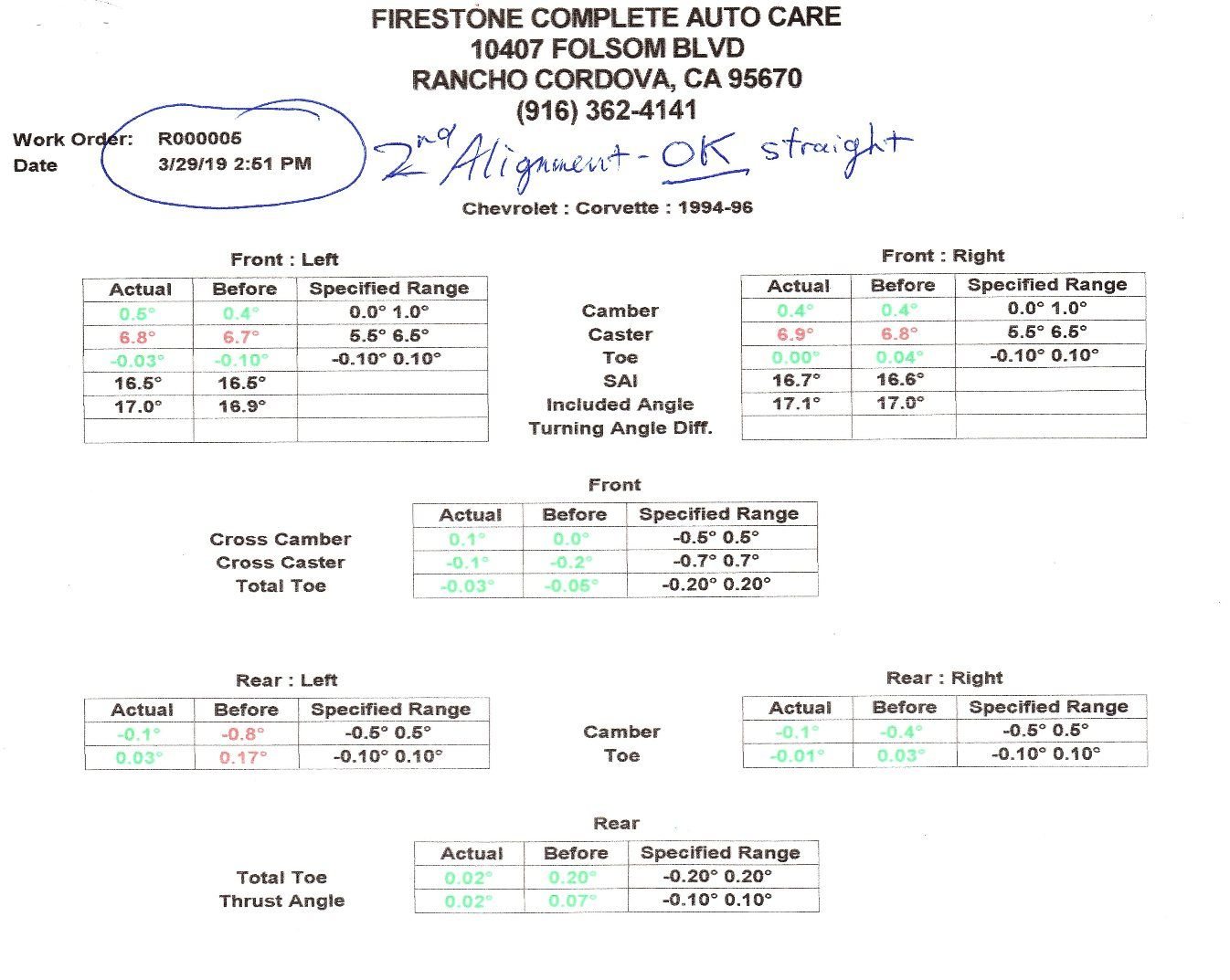

So I misjudged the distance and smacked a curb with the left front wheel, pretty hard. I could tell that the alignment was off so I took it to my regular shop and the technician says a shim kit is required to get the alignment settings back to spec (camber, specifically). The technician and I both looked everything over and neither of us saw anything that was bent, cracked, or otherwise damaged. If all components are in good condition, I don’t understand why a shim kit is required. Maybe the suspension mounts are bent, or the frame is bent? Should I be concerned about the car’s safety? I hope someone can explain in simple terms what may be going on here. And I hope not to hear that the shop is ripping me off… I like to do most of my own work but alignments are one of those things that I need a shop for. The alignment specs are attached -- it took him two attempts to get it right. Thanks
FIRST ALIGNMENT SPECS:
SECOND ALIGNMENT SPECS:

One thing I forgot to mention: the shim kit has already been installed, that is how the technician got the alignment settings back within spec. My question is, if all suspension components are undamaged, why is the shim kit required? Why can't the good parts just put back to spec? In other words, the need for a shim kit indicates something has been bent, but close inspection indicates all is well. I just want to make sense of this.

Adding and subtracting shims to adjust alignment was common with GM vehicles for decades. Many times alignment shops had a variety of shims. Many times shims removed in the process of doing alignments on other cars. If alignment required more than .125 shims; I would suspect something was bent. SAI, included angle, and toe out on turns can indicate if something was bent

The frame, control arms, or tie rod got slightly tweaked. As long as it can be returned to specs and the car doesn't pull, don't worry about it. It sounds like your technician knows what he's doing.

You need to ask an alignment shop before they even do any checks if they have the appropriate alignment shims available. Any C4 owner or owner of an earlier car using this alignment procedure would be wise maybe to gather a miscellaneous shim thickness assortment before ever taking it to an alignment shop. Many alignment shops I'm quite sure don't have them readily available.
Shim kit wouldn't be mentioned by an experienced alignment technician! You certainly might likely see it on your invoice though.
OP - there's 3 1/2 hours from 1st to 2nd alignment. Did they need to order shims for your second? They put you 'on the street' as done with the 1st alignment and took your $$$.

The first time I took it in for this issue, they put it on the alignment rack, did an inspection, then attached the wheel sensors. Shortly after, they told me the shim kit was needed and I reluctantly said OK. So they went to a local parts store to get the shims and installed them while I waited on the first visit. When they were done, I took the car to meet a friend for lunch and on the way I noticed the car pulling slightly to the right. I called the shop right away, they said bring it back, thus the two alignment printouts. The shim kit cost me $15 but the installation labor was much more.
This shop also aligns my 2006 Tacoma, and more than once they have sent me off with the alignment "done" but the truck pulling slightly to one side. So now they send me off with the car pulling. When I brought it back to them, I reminded he shop manager that this has happened more than once before, then I asked if they do test drives before sending their customers off in their vehicles. (I know this is bit of a cheeky question but I was not happy about having to bring the car back to them just hours later.) They said of course they do test drives.
