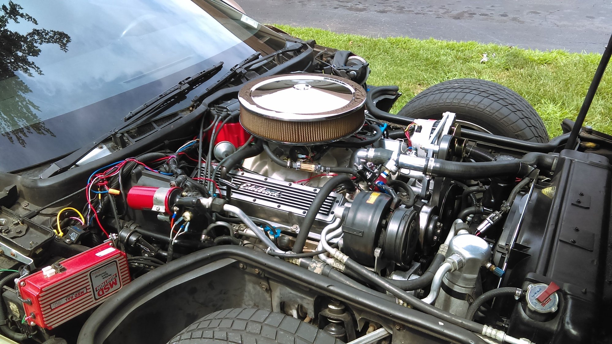

It's a 383 ( carb) with a roller and 6 speed Richmond. Super reliable and really quick + great gas mileage.
