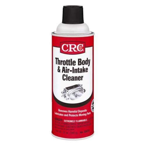

Could be a vacuum leak like Kevova said also try cleaning the throttle body bores and Idle Air Control Valve with CRC cleaner both get gunked up with carbon
You can also just try replacing the valve as they are about $75 as sometimes cleaning doesn’t fix the problem 27 year old parts like that you can always just look at it as a preventive measure if it doesn’t totally fix the current problem...

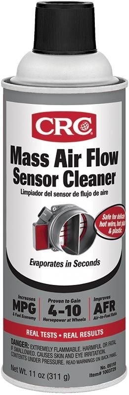

And while there carefully clean the MAF.

No MAF on his '92.

I would have said that if his was a 85-89 or 94-96 but it’s a 92
