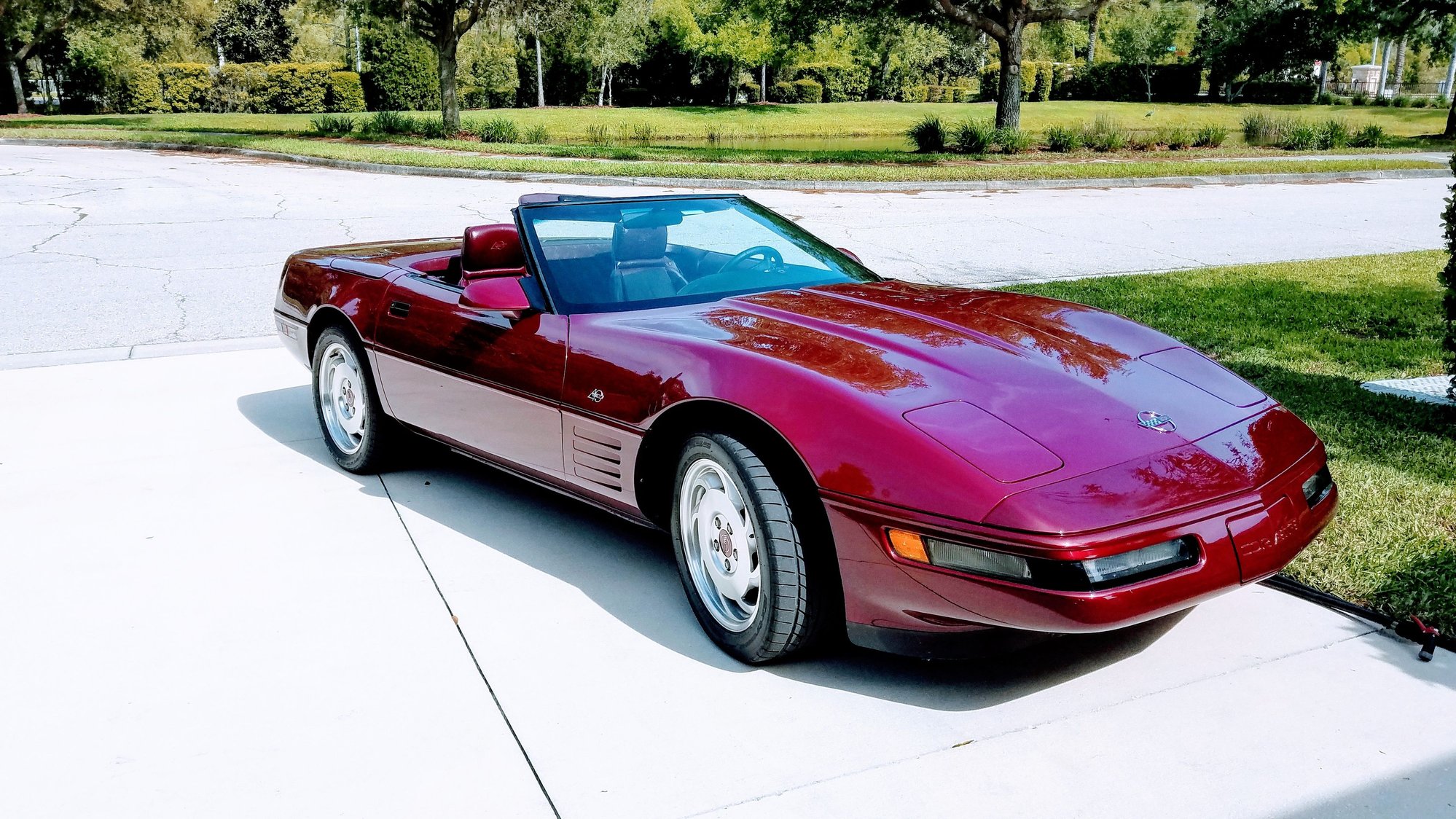

hi folks, about 3 moths ago ihad a clutch kit installed. All was fine until this evening when i was out for a ride, all of a sudden the clutch slipped enough to burn then re engaged. it happened twice
and for no reason. no speed shifting, just cruisin around 40 if that in 4th gear. im guessing pressure plate unless there's an adjustment at the slave cylinder. just lookin for another opinion, come monday i'll be at the shop that did the job
