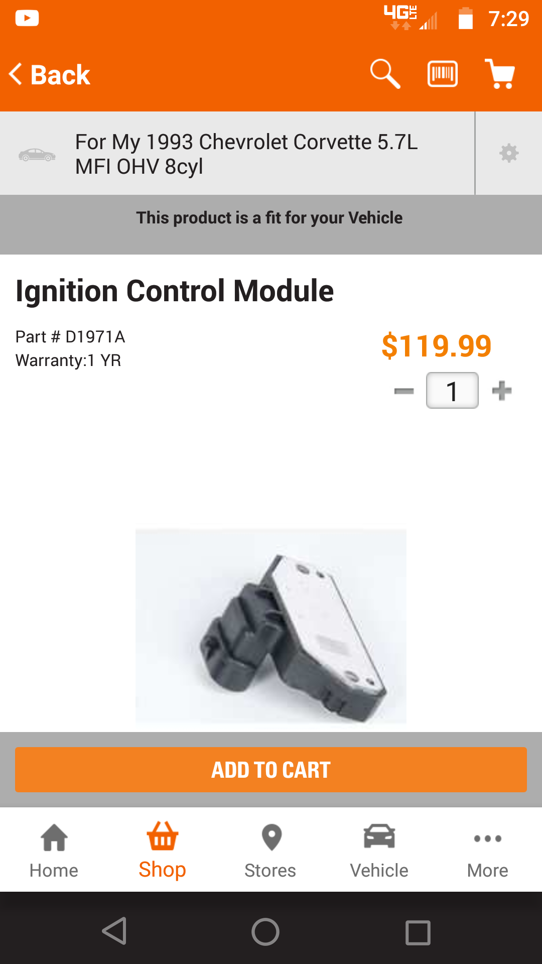

sounds like ICM. cheap easy fix before thinking opti, you tube a opti trouble shoot guide

Originally Posted by BLKMAMBA
sounds like ECM. cheap easy fix before thinking opti, you tube a opti trouble shoot guide
He has a 93. Maybe not so easy and not so cheap.

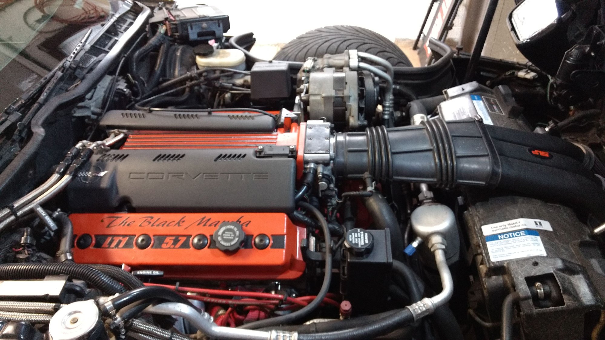

I have a 93. Very easy
Well, the 93 uses the same ECM as the 92. If you have been reading any threads about this ECM for the past few years, you would know that this ECM is next to impossible to attain. Not quite sure what your picture has to do with attaining one of those.
Old Apr 10, 2019 | 07:25 PM
BLKMAMBA's Avatar
BLKMAMBA
Joined: Jan 2017
Posts: 702
Likes: 55
From: West Deptford New Jersey
Okay. Picture shows I have the same. Easy to get at. I have 3 spares. Not really hard to get.
Old Apr 10, 2019 | 07:31 PM
BLKMAMBA's Avatar
BLKMAMBA
Joined: Jan 2017
Posts: 702
Likes: 55
Old Apr 10, 2019 | 08:44 PM
BLKMAMBA's Avatar
BLKMAMBA
Joined: Jan 2017
Posts: 702
Likes: 55
I meant ICM. Not ECM
