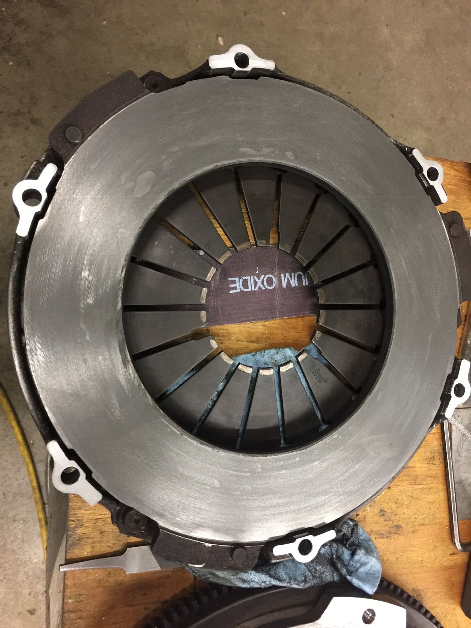

[QUOTE=MatthewMiller;1599271208]These days every pressure plate replacement is sourced from China, probably from the same casting molds. No matter what they say, there's no evidence that a SPEC plate or any other is any different or better than the cheapest auto parts store plate (except that Centerforce attaches weights to the diaphragm fingers, but they have a bad habit of coming off). If the OP has an OE Valeo plate in the car now, I'd recommend that he find a shop that knows how to resurface pressure plates (gotta cut the pedestals the same amount as the friction surface) and reuse it.
This is unfortunately very true and the reason why I chose to resurface the friction surfaces on a dual mass flywheel and stock Valeo pressure plate when I did my zf swap.
This is the route I would take now. Resurface the p/p, by a new disk, and try to find a NOS INA bearing.
Yeah but you should never ever ever use a lathe to cut a flywheel in a performance car. We always used a blanchard grinder to cut a flywheel. (although now I just throw them out and buy new).
The dual mass flywheel has springs and stuff inside that also wear out. You're supposed to perform a test to see if it's got the same integrity as stock, and technically you are not supposed to cut them.
I'm running a SPEC single mass flywheel and a sprung hub clutch.

[QUOTE=anesthes;1599288616]Yeah but you should never ever ever use a lathe to cut a flywheel in a performance car. We always used a blanchard grinder to cut a flywheel. (although now I just throw them out and buy new).
I don't have a Blanchard, but I stoned the surface to get a crosshatch pattern
easy enough to check, just rotate flywheel both directions and measure travel, should be less than 1.375
